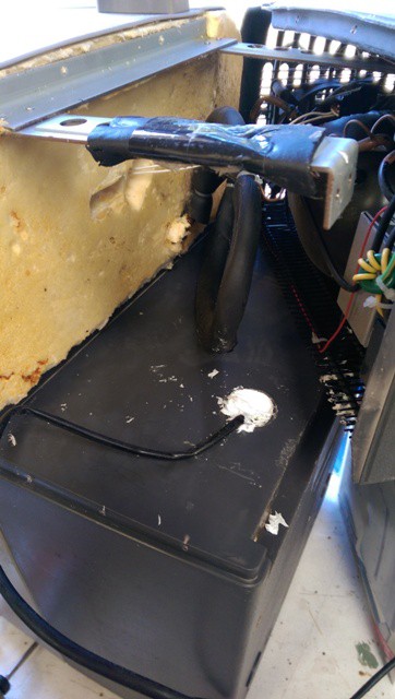

Ok, Mine is a CF35 (same unit)
My Thermistor packed it in a few weeks ago, I read up everything on here and decided to go to Jaycar and buy the thermistor. Well someone had beaten me too it and bought all the 10k stock. So I bought two OEM units, one so I could have a spare like the CF80's
When I opened the the end to get to the panel to drill the hole for the new thermistor I found it had already been done this way. I remember my Waeco failed during warranty, now I realize it was a thermistor fault then.
See pic of drill hole with thermistor wire coming out of case.
This made it easy for me to dig out the silicone they used to fill the hole. I cleaned it out and re fitted two thermistors side by side (I now have a spare like the CF80) and in my enthusiasm I failed to take a pic of the two units glued in
I bought the two thermistors and thermistor heatsink compound to put on the unit heads from Allvolts Power Solutions in Broome; They were very helpful and quick with their supply. They also included the "factory" repair guide for replacing the thermistor in CF-35 -40 models.

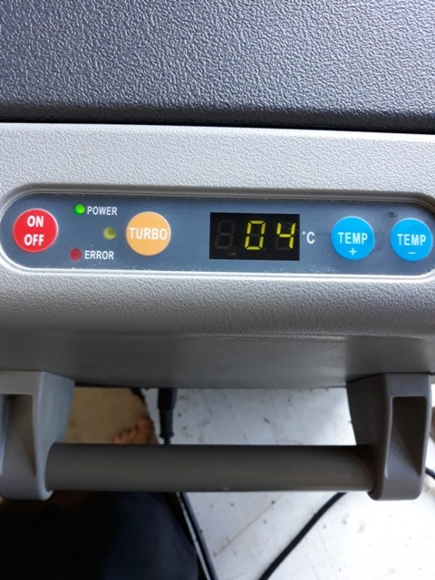

Second pic is unit working at set temp of 04 deg
I'd just like to say thanks to everyone who posted here as it made the repair easy.

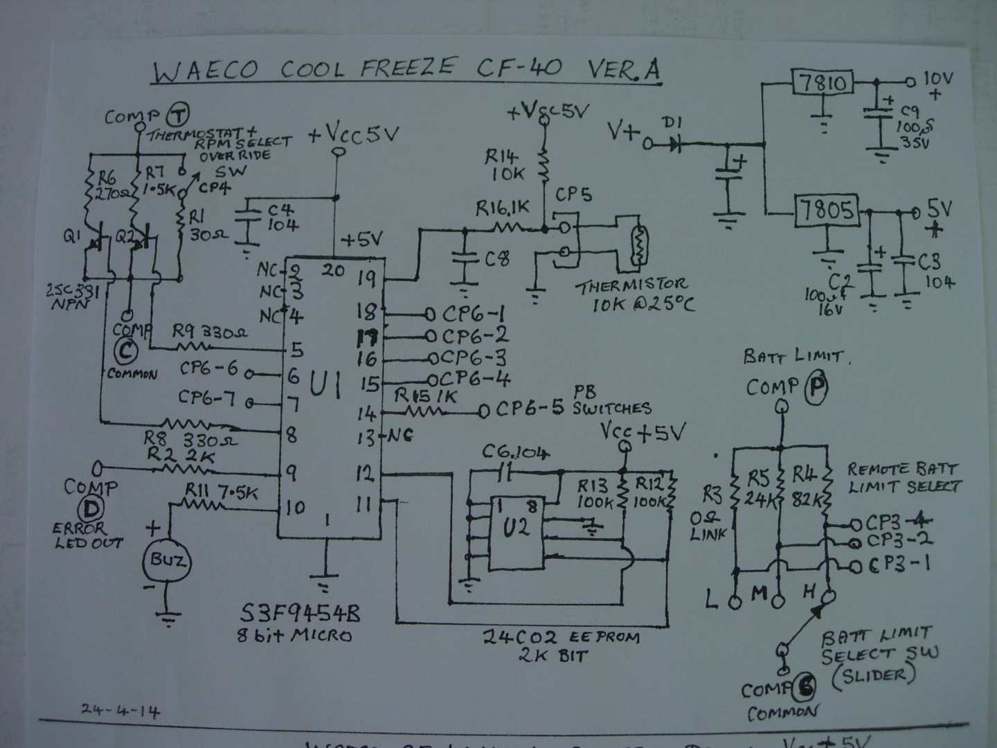

Here is the first part of a circuit diagram for the CF-40 Ver A.
More sections are in progress.
Part 2 of main PCB
Very interesting, did you do this?
Yes, I used your photos. Some parts are not visible, so I had to make educated guesses.
Edit: Just in case I misunderstood the question, the software was written by Andreas Weber, not me.
-- Edited by dorian on Saturday 19th of April 2014 03:15:47 PM
Thank you for this will eventualy try & check & fillin values.

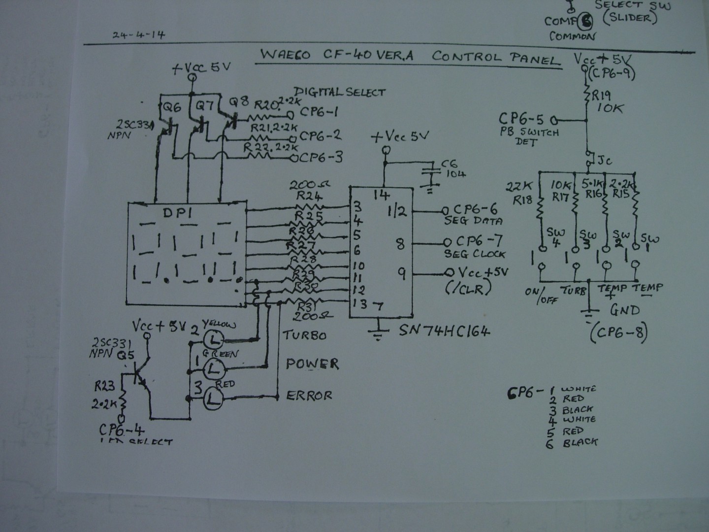

Here is the Control Panel circuit:

Heres a rough copy of the circuit with the values filled in.
Thanks very much. I think there is now enough information for a full service manual.
BTW, resistors R6, R7, and R1 now tell us what speed the compressor is running at.
According to the compressor datasheet ...
0 ohm -> 2000 RPM
277 ohm -> 2500 RPM
1523 ohm -> 3500 RPM
From your circuit diagram ...
Q1 and R6 (270 ohm) select 2500 RPM.
Q2 and R7 (1.5K) select 3500 RPM ("Turbo" mode?).
The override switch and R1 select 2000 RPM.
The battery limit resistors select the following cut-out/cut-in voltages:
AISI, we could determine whether the main PCB is switching on the compressor by monitoring the voltage between the compressor's T and C terminals. This same voltage is also present at the terminals of the override switch or at CP4 on the main PCB.
My reading of the datasheet suggests that the following relationship applies:
Thanks
