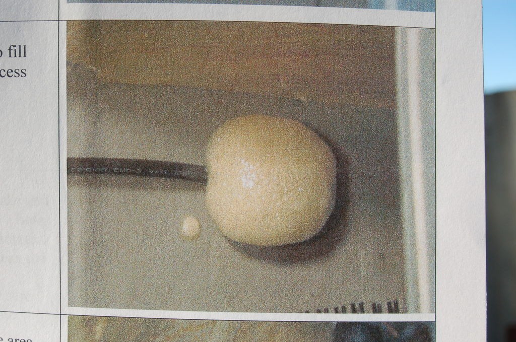

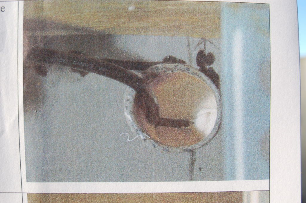

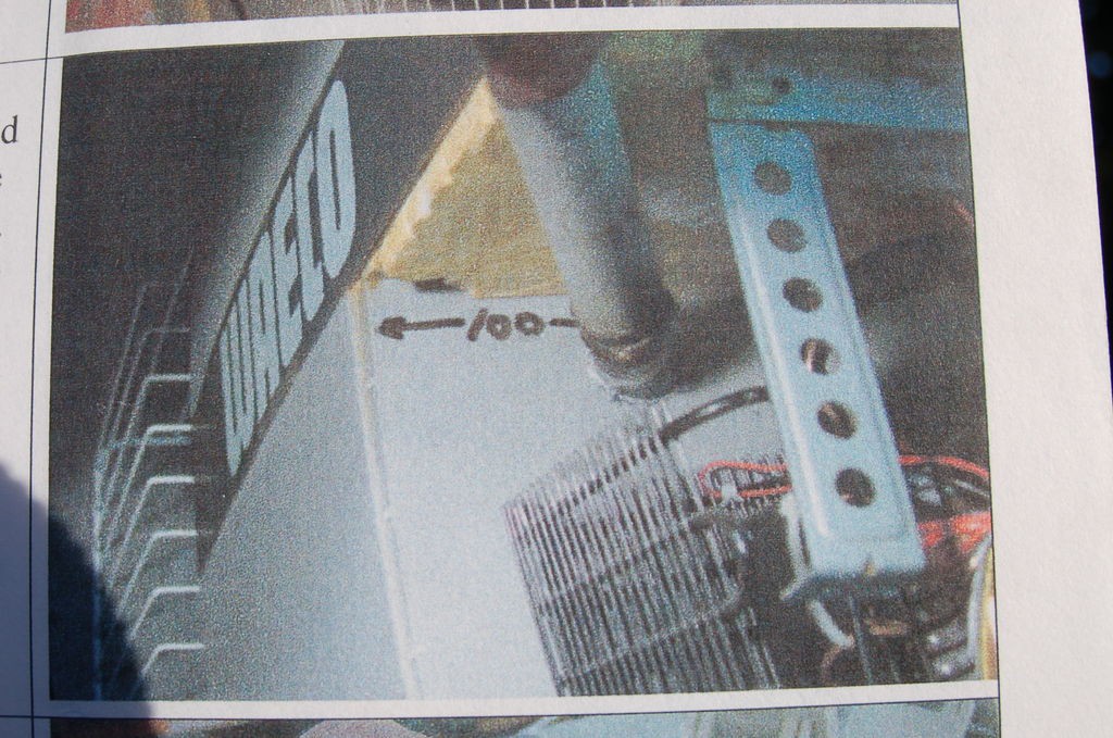

This is the recommended way of fitting, but be careful. 1. 100mm in & 25mm down, heat a 24-30mm metal tube & burn a hole in through to the evaporator. Clean it all the way in to the alum evap (do not drill). 2. Stick the thermistor to the ally evap with araldite. 3. Fill the hole with foam. 4. After dry cover with silicone. Borrowed the pics from another forum im on & they were posted in Waeco disassembly which I started, & pics were posted by bob& bev.
hi daryl, nice talking to you tonight,
where the 100mm in and 25mm down, is the hole in the centre of the meet or does the hole start at the edge of 25mm and go towards 90mm

To me it looks like the center of where the measurements meet.

yeah that's what I thought. Is the butter section on the edge of that 25mm, don't want to burn a hole in that section. I thought I would tackle the 35lt first, and not the new one, lol

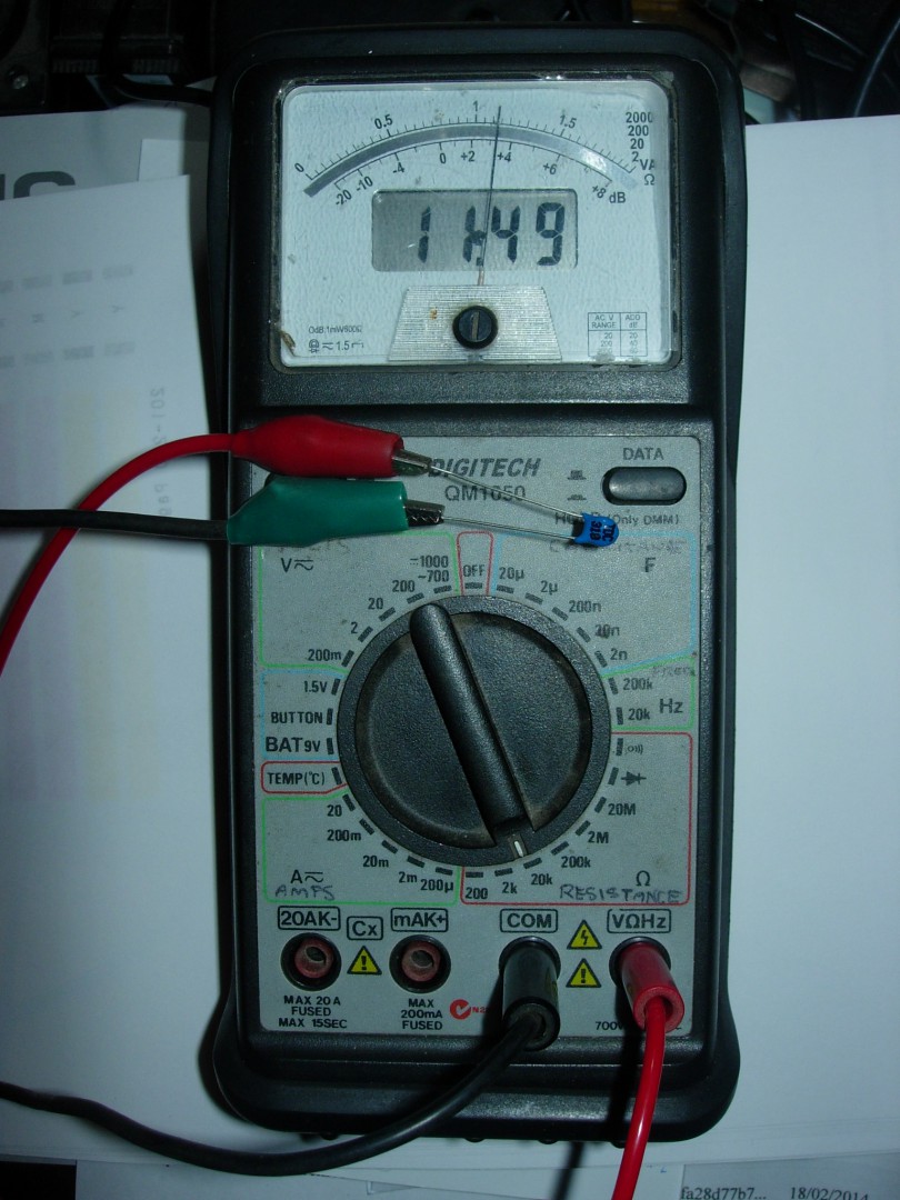

Unplug the thermistor lead from the board & check the resistance. Should read 10K ohms @ 25degC. Picture of a 10K NTC @ 20degC reads 11.49K.
Thanks Daryl, if its not, buy a new one
Will put up my findings
Regards Peter

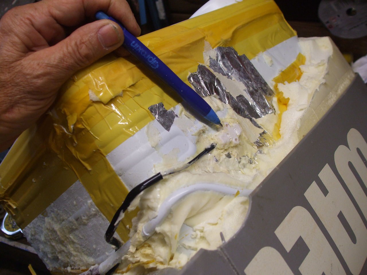

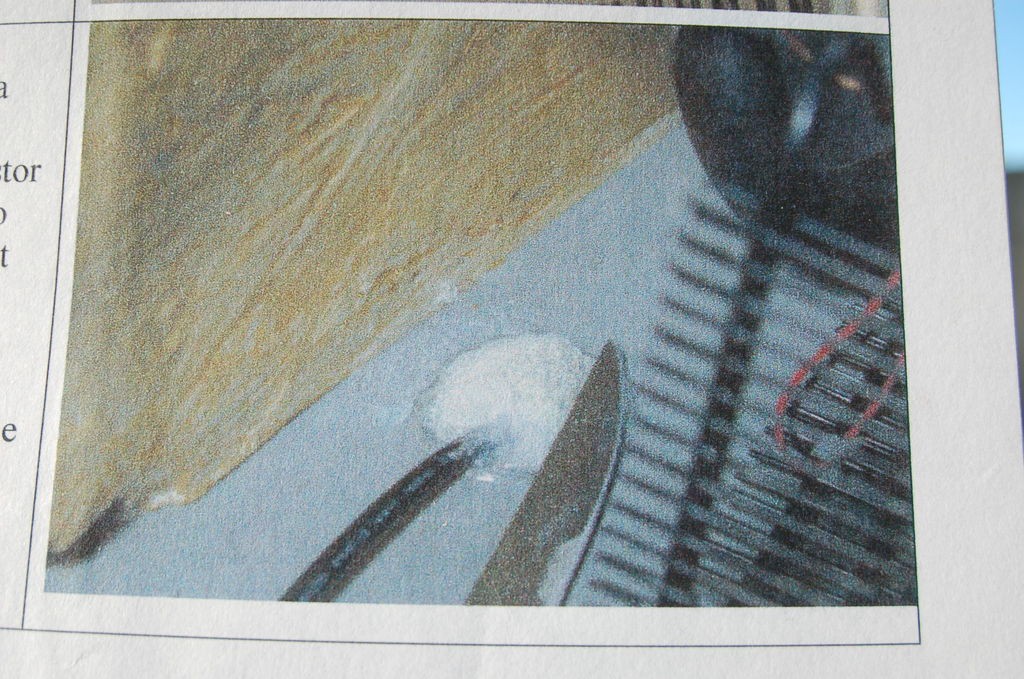

Ive made the hole longer now 70 x 40mm and still no sign of any thing, glad this is my old fridge and not the new one

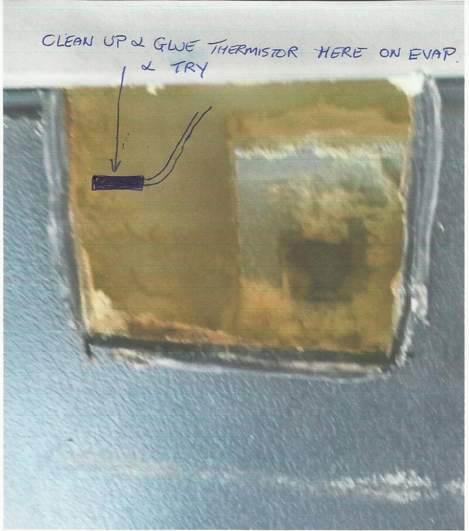

Cleaned up and glued the thermistor to the cabinet with araldite

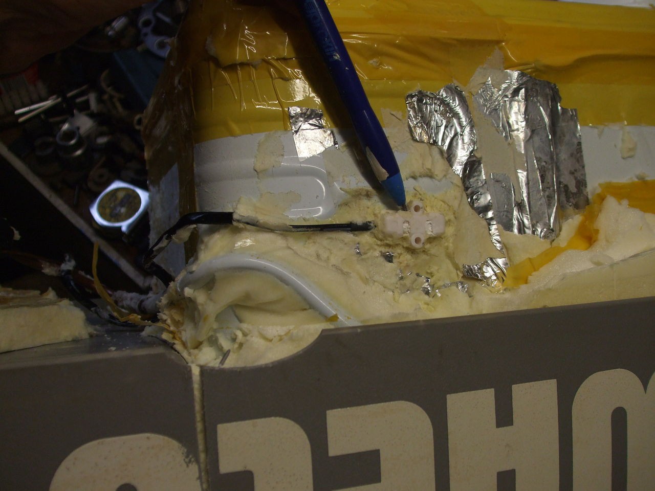

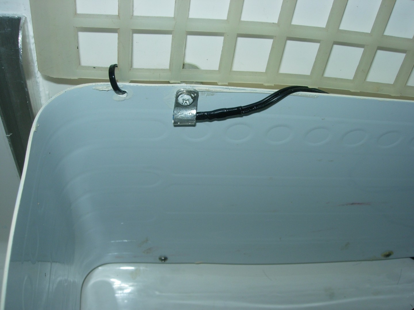

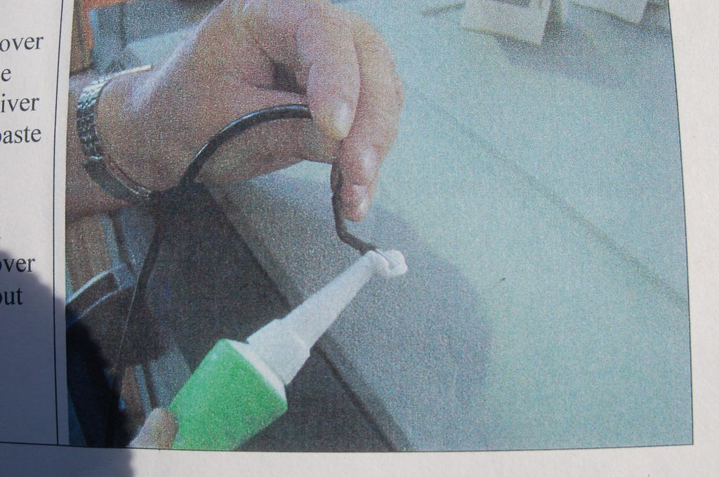

This is how I mounted the thermistor to the Waeco Evaporator when I fitted it to the Evakool Esky.

This is where they are originaly.
Regards Peter

Just cut the hole with a hot knife 4cm x 4cm in between the A &E on waeco
But i dont see the wire or the pipe
The hole was cut on the left hand side of the fridge with me standing at the compressor
Any ideas Daryl

I wouldn't go looking any further as they obviously don't put them all in the same place. just clean up the Evap & glue the thermistor to it.
