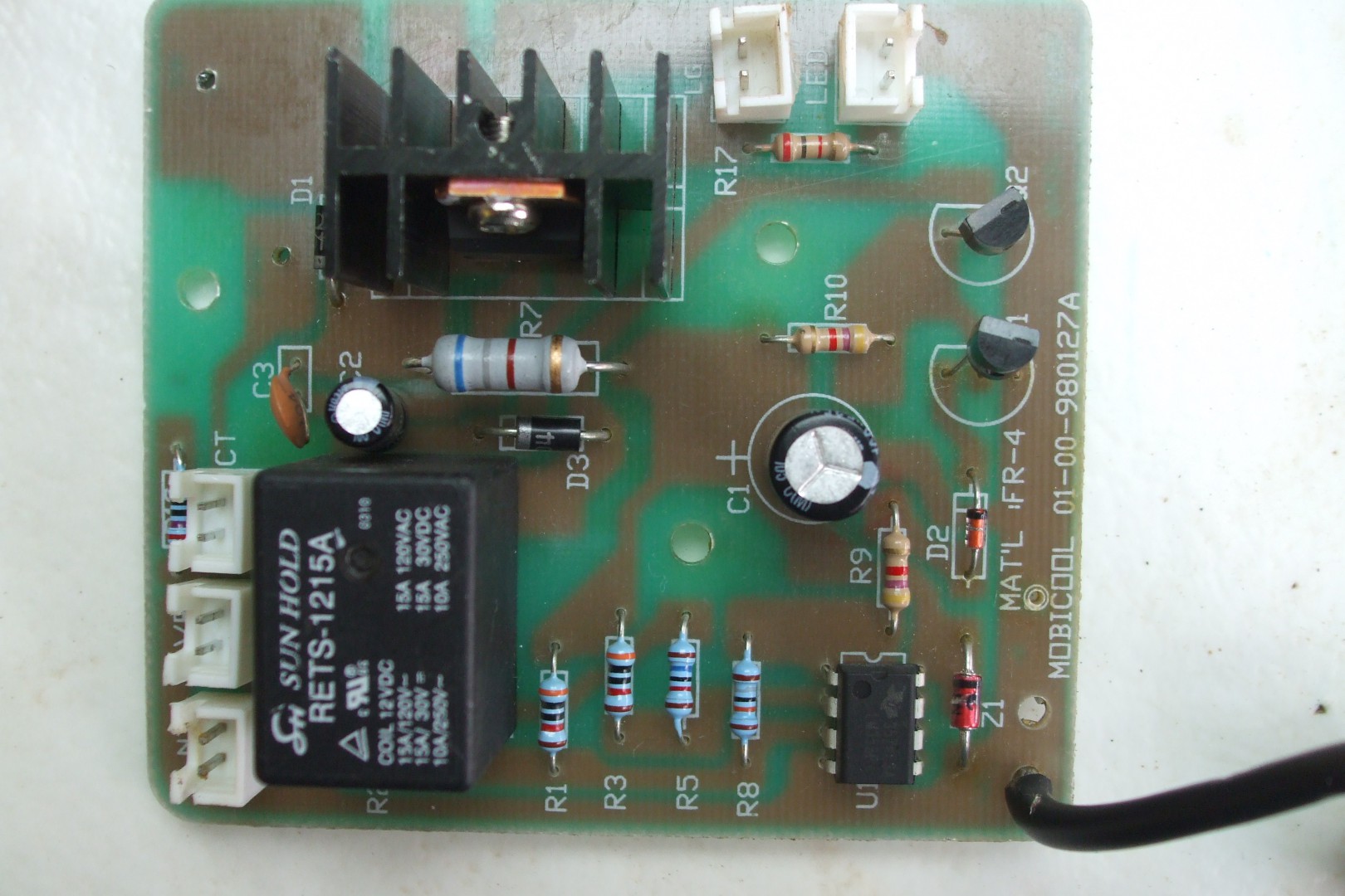

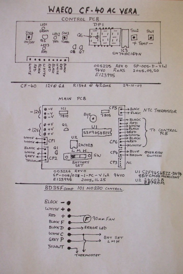

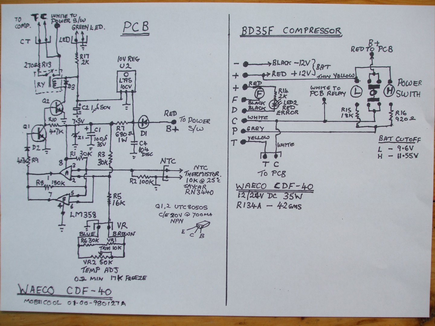

If it is of any help (perhaps in future), here is a hand drawn circuit diagram for a Waeco CDF-40 (was it drawn by someone in this forum?):
(1) I believe transistors Q1 and Q2 should be NPN, not PNP.
(2) I'm not certain, but I believe there should be a resistor between the thermistor and the 7.3VDC supply rail.

Your right the 2 transistors are NPN in the circuit ive drawn them wrong but down the bottom it says NPN 80v@700Ma.The thermistor resistor going to the7.3v rail is R1 30K.

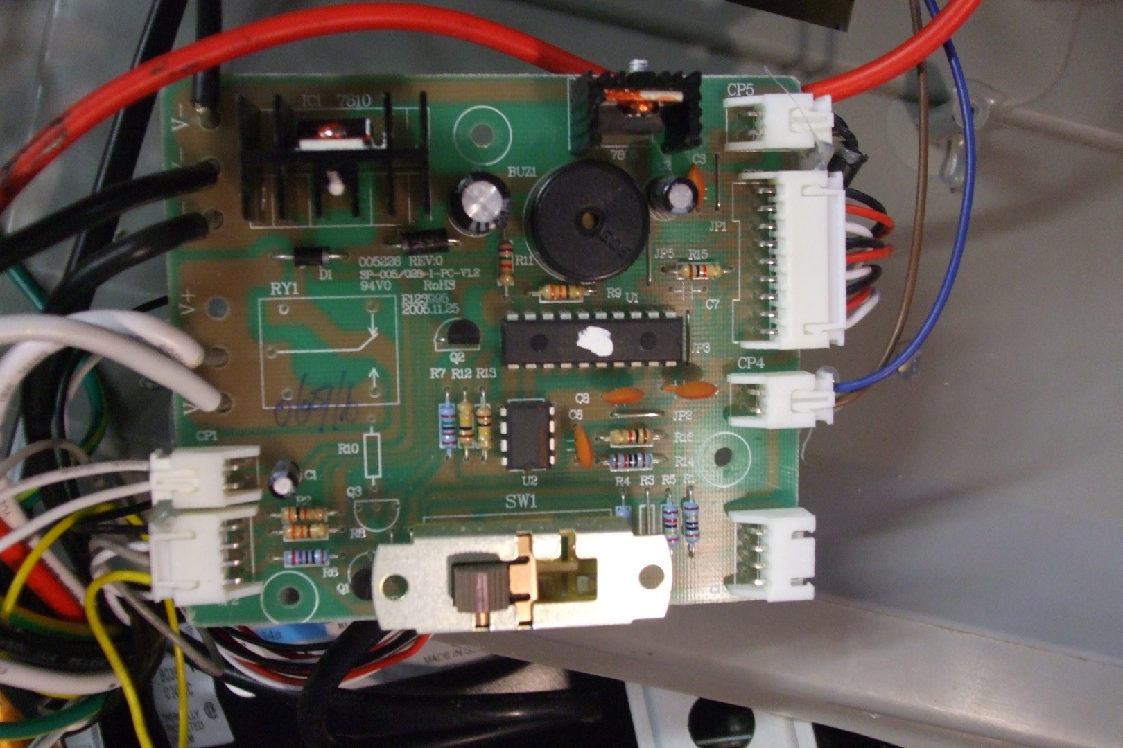

This is the model being worked on in this thread CD-40 VERA. Quite diferent to the CDF-40. As it has a Micro processor controlling every thing. A calenge for some one to draw out the circuit of this one. Also the thermistor on this model must go in the position behind the compressor. Per the set of pictures.

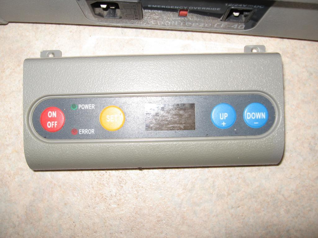

Daryl, i just got my good fridge out CF 40 VERB 6 yrs old
when i turned the fridge on ,i have the temp set to 4c , now that its been running the temp has gone up to 60c and when i change it to F the temp is -16
Any ideas on what could be the problem

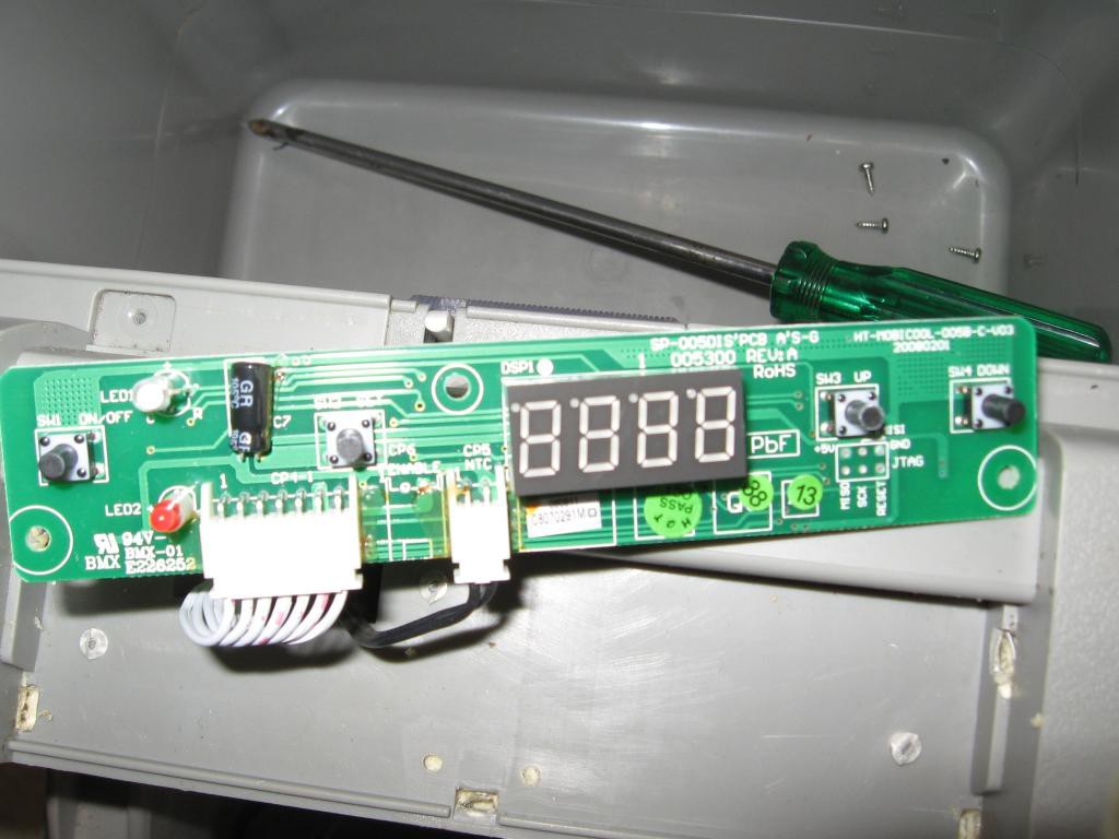

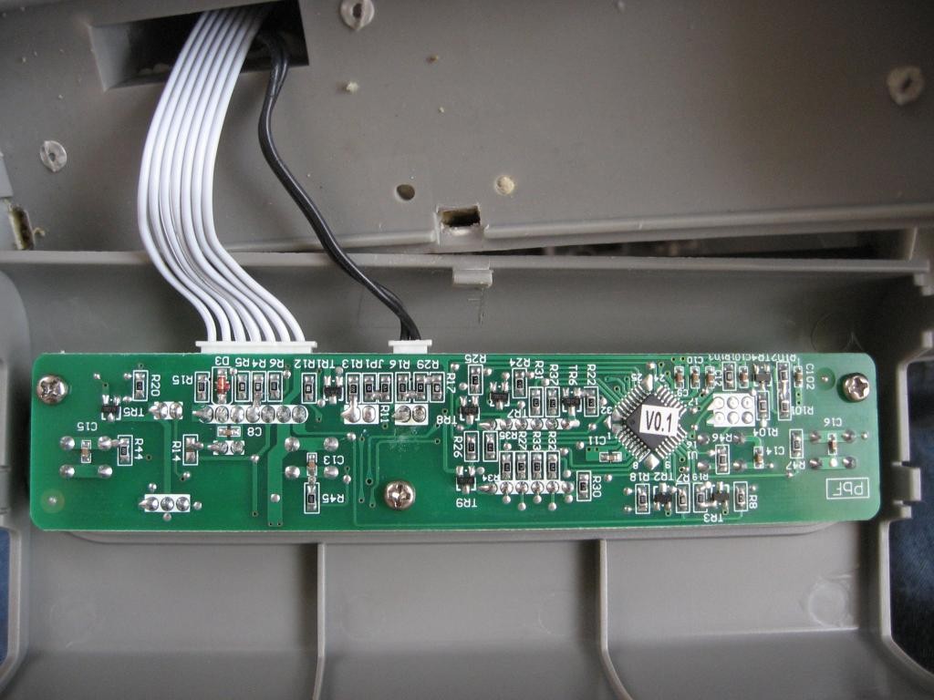

The CF-40AC Ver b is diferent again. All the processor is up in the control panel, & is surface mount components. Rather difficult to repair , apart from replacing thermistor or push button switches. Are these the same control panel as yours? CP5 NTC on the board is where the thermistor plugs in, I would unplug it & check the resistance. An easy check is plug a good thermistor into the board & see if the temperature is more realistic.

If I were troubleshooting this problem, I would spend some time to retrieve the resistance-versus-temperature profile that must be stored in the microprocessor's memory. The way I would do this would be to connect a resistor decade box to the thermistor input (CP5), and then run the box through a range of 5K to 50K, say. It would probably be advisable to disconnect the compressor while performing these measurements.
Once you have these data, then choosing a suitable replacement for the original thermistor would be a lot easier. Moreover, by substituting known resistances, you could then quickly check whether the control board was behaving as expected at different temperatures. For example, if the set temperature is 4C, then you could select a resistance corresponding to 2C and check whether the compressor is switched off. Conversely, you could select a resistance corresponding to 6C and check whether the compressor is switched on.
Not sure how an end user would go about this, though.

yeah that the same as mine, the 35lt is still working in the cruiser, set at -6 but temp inside is -2
The 40lt ver b which is in the lounge is at 60c on display and continuously running, i checked the over ride and thats at normal. so have turned the fridge off

5000 x e^(4100 x (1/(273.15 - 6) - 1/298.15)) = 24659
I just went out and checked the fridge temp, out side on display -11c inside cabinate 6c
And all i know is a brought the thermister which is a genuine waeco one for my 40lt ver b which is only 6yrs old, and i put the thermistor in the 35 ver a
There web site says 35lt to 50lt they are the same
im sure the thermistor is supose to be 10k @25 c
Regards Peter
ps is there a simple way to get the temp right
also should it make any differance where on the fridge the thermistor is put as long as its on the condersor
was also looking on the net and they say i should have used a special white glue to stick the thermistor on the fridge as i used aareldite
Regards Peter
Yes it does make a diference where the thermistor is placed on the evaporator on the CF models with the digital read out. That's why its put in behind the compressor.
