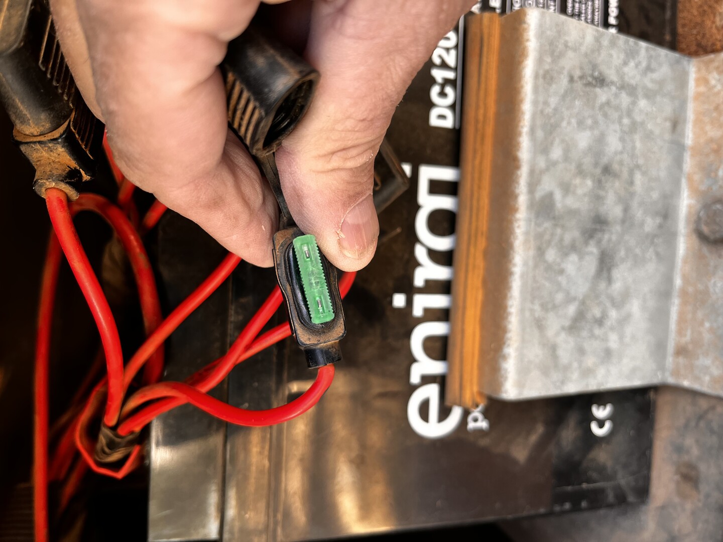

Gday Brains trust, Im after some help. I have a BBPro Trailsafe breakaway system and light is red. I have replaced the 30kmh fuse twice but it keeps blowing. The fuse itself is actually melted. Does anyone out there have any advice as to why this is happening and how to fix it? Cheers.

Im not brains trust certified but a pic of the fuse and the fuse holder will help.

See below. Its a standard inline fuse holder. With a 30amp fuse.

Blowing a 30amp fuse twice indicates a wiring shorting issue.
Check all wiring connections from power source to switch to monitor to wheels. Damage may have occurred whilst towing.
Try... following manual guide to troubleshooting.
Check YouTube "Bmpro trailsafe faults and solutions".
Common Faults and Solutions
  • LED Flashing Red (1 Pulse):
    • Meaning: Pull pin contacts are not in good condition.
    • Solution: Clean the pin slot of dirt, debris, or corrosion, and ensure the pull pin makes solid contact. If damaged, replace the pin.
  • LED Flashing Red (2 Pulses) / Battery Not Detected:
    • Meaning: House battery is missing, disconnected, or completely flat.
    • Solution: Check battery terminals, verify at least 10Ah of capacity or 30% state of charge is available, and charge or replace the house battery.
