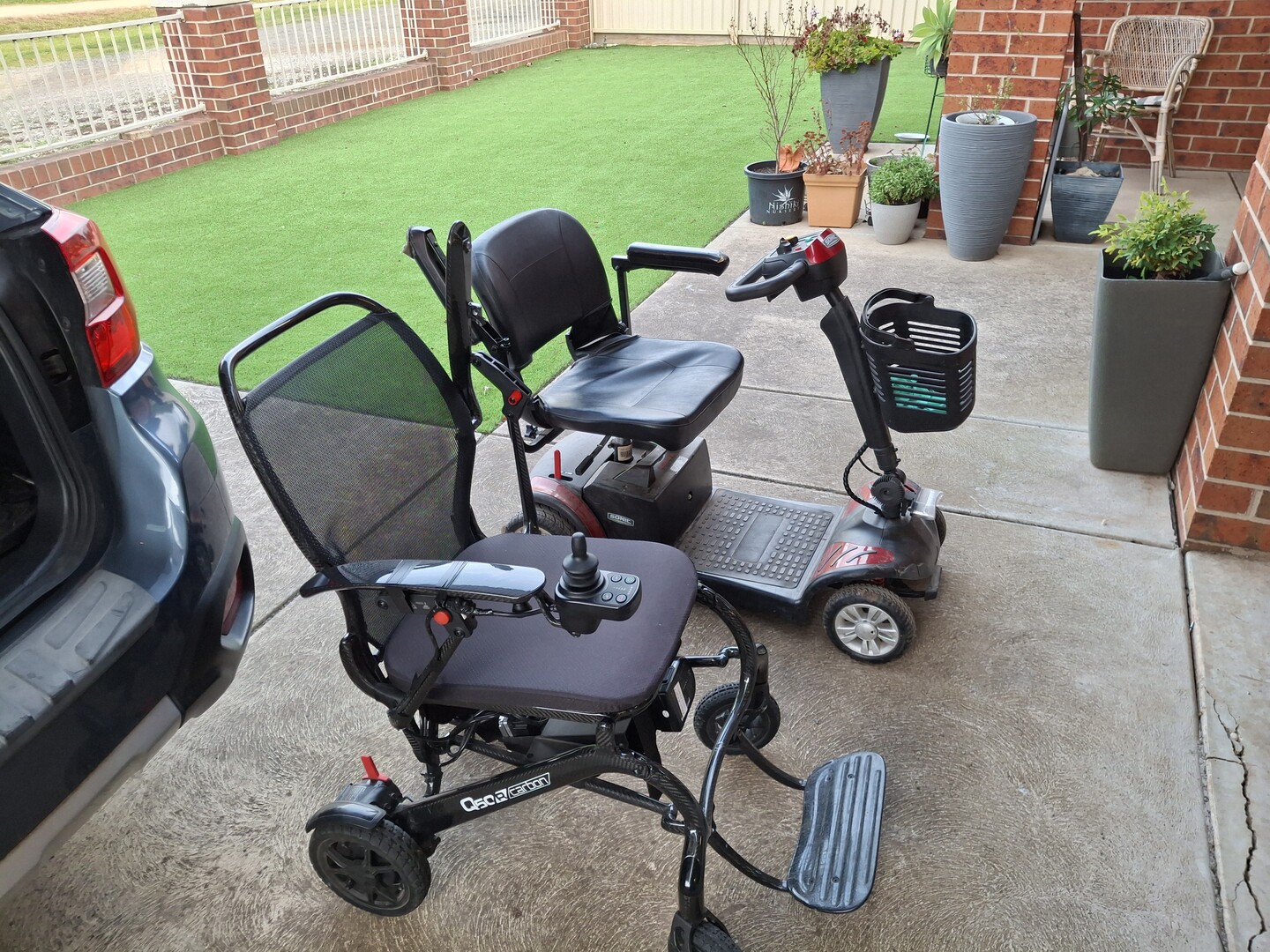

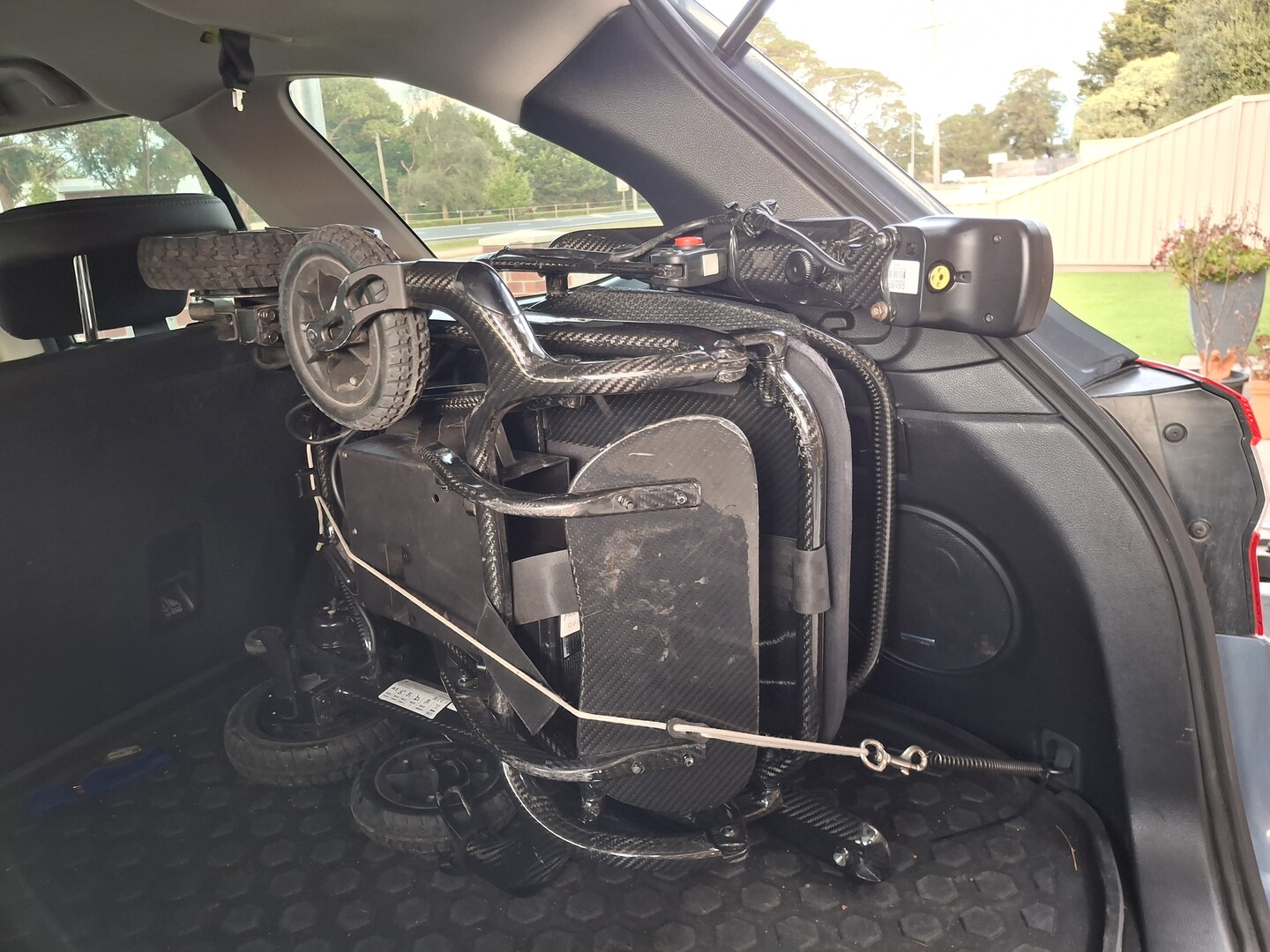

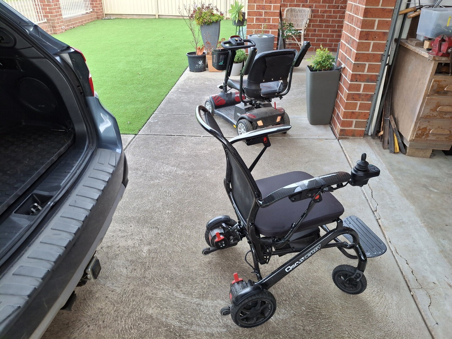

I have been involved for a few years trying to get a suitable electric wheelchair. I started with one that you could take apart into 4 sections. Each section averaged 15kg. By the time I lifted each section I was totally exhausted. Ok if we had our son with us he put it together for me. Most of the time I would sit in the car. I tried to have it fit in our Subaru Outback suv without having to disable into  I then saw a teen at Grandies basketball with what I originally wanted but got almost bullied by the saleswoman. I then went back to research and came up with a Q50R, carbon chair. The Q50R can be taken as luggage in aircraft. The battery (1.45kg) must be taken as hand luggage. I have not taken on aircraft yet. The Q50R weighs 15.4 kg including the battery. I use the original to go the IGA supermarket and servo 200 meters from us.20260525_164952.jpg20260525_162856.jpg20260525_165057.jpg20260525_162723.jpg20260525_162856.jpg20260525_165057.jpg

Thanks for your replies, the Q50R to me could do the job especially with the 2 batteries, Aussie P are the 2 batteries in situ all the time or do you need to take one one out and replace it to go the extra distance.
To me the Q50R is similar to a unit being sold by the RAA in SA at $3990 for members but with less range ( 1 battery)
Have found out now, that friend would like a head rest for the longer trips.. I have not come across any such designs.
Thanks Again

 There is a seperate area for the 2nd battery. You have to swap them over. Will take a pic tomorrow.

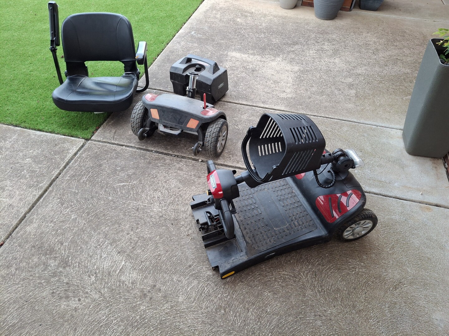

My wife uses one of these when we go away.
Seat and battery out weighs 14kg,
Seat lifts off and handle bars fold down
Supascoota 4 (4 Wheel version) good on road or footpaths.
https://gomobility.net.au/products/supascoota-supalite-4-mobility-scooter?currency=AUD&country=AU&variant=44859850588409&utm_source=google&utm_medium=cpc&utm_campaign=Google%20Shopping&stkn=08bf0c9cb3a7&gad_source=1&gad_campaignid=21284405519&gclid=CjwKCAjwrNrQBhBjEiwAoR4VO9o7K7lkqP07oXtq7kHy_wnORPxZHouuzKYJdB8QPlgVJxWsywp9wRoCtq4QAvD_BwE

I can't seem to get the pics up here at the momenthmm
download.jfif (94.2 kb)
