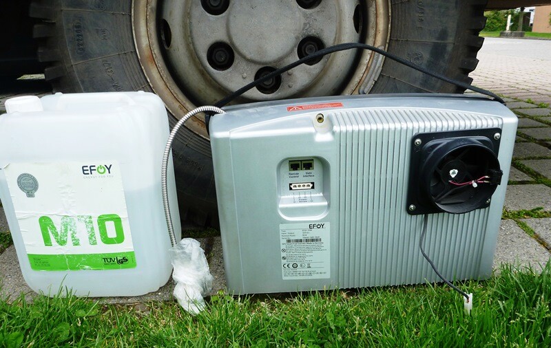

As a back-up you won't beat this....a genuinely quiet generator.
https://www.efoy.com/
We had one of these when we toured Europe in a motorhome for 3 years some years back.
Made about the same noise as a compressor fridge, can be used inside the motorhome, a little CO2 and some pure water are the only waste products and will run 24/7.

Wow, love the product, is there a reason why theyre not available in Australia
__________________
Guru
Status: Online
Posts: 633
Date:
Another battery or a "quiet"generator
 They used to be available here and Kimberly Kampers were offering them as an option at one stage.
Get in Touch with Us | Powerbox Australia in Sydney claim to sell them.
And this mob in Melbourne. EFOY Fuel Cells - GreenRen Power
