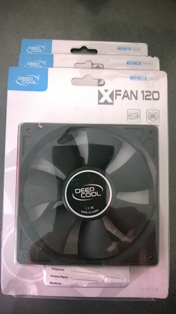

For my 'Absorption Fridge' I've tried numerous commercial fans and as Arnie said in 'Spies Like Us' "they were all bad".
So I made up my own.
I sourced quality 3 large size computer case fans from my local computer shop AUD$11 each, and,
A quality pipe mount thermo switch from Senasys in the USA US$11.75 http://www.senasys.com/shop/product/12-sealed-thermostat-switch-431-301a820f/
I used silicone sealant to glue the case fans to the external vent with a small recessed easily accessible kill switch hidden in the vents.
Using a cheap InfraRed Thermometer from SuperCheap Auto AUD$27 I measured the temperatures of the pipes leading into and out of the radiator part of the fridge.
Having chosen a suitable location on the pipe work I then measured the outside diameter of the pipe with my cheapo vernier calipers and ordered the appropriate temp and diameter thermo switch from Senasys.
Wiring was simple enough connecting to the existing terminal strip that has the 12 volt power to the fridge, via a fuse, then the kill switch, then the thermo switch, then the fans.
Less than $50 (I already had the tools) and it works super well. When the temperature gets hot the fans turn on. They are super quiet whilst sucking out the hot air from the radiator area. Previously the fidge simply couldn't cope with temps over 30C now it works perfectly even on 40C+ days.
PS. I tried the Jaycar type thermo switches and they simply don't work. They are flat and don't have the proper surface contact with the pipework. Any attempt to strap the flat type to a pipe using something like a hose clamp results in the clamp acting as a heatsink which draws away heat from the switch so it doesn't work. Those flat type are also very delicate and the flat face can be deformed easily which destroys them.

Very impressive setup. May I ask why three fans? Others seem to get by with only the one.
Also I see each fan has three wires. Are they powered by some sort of controller?
I take your point about the thermostat. The Jaycar one slithered everywhere while I was strapping it onto the pipe. I did wonder about the flat base going onto the rounded pipe but then figured if Dreampod had used one it must be alright. Nonetheless, I'll consider buying one of the Sensys ones, probably the same one as in your photo.

Photo is generic Murray, Sunon part number does not match Sunon part number for 12V fan!.  If in doubt double check with the store.

LongWeekend <quote> May I ask why three fans? Others seem to get by with only the one. </quote>
Whilst the absorption fridge process is simple enough, it is quite convoluted in its pipe works. Our needs relate to the beginning of the process where the ammonia and water mix is heated to an evaporation point and then immediately must be cooled slightly, relying on heat radiating away passively from the 'condenser' fins. This is why they don't work in high temp climates.
The more air you can draw over the condenser fins the faster the ammonia/water separation takes place further in the pipework and the better cooling from the ammonia.
You could always start with one fan and add more later. I bought the 120mm sized units because they are almost silent running with the bigger blades and rather than mounting them somewhere in the cavity space I chose to have them directly expel the cavity air to the outside environment.
LongWeekend <quote> Also I see each fan has three wires. Are they powered by some sort of controller? </quote>
As Dorian mentioned, computer fans with three wires provide RPM feedback to the motherboard which can be used for temperature Vs fan speed control. In my situation I only used the red and black wires and trimmed off the yellow ones. The controller is the thermo switch clamped to the pipework. Senasys have these switches available for different pipe sizes and temperature switch points, so on choosing where you will fit the switch (required space) measure the outside pipe diameter and the operating temperature at that point with your vernier caliper and IR thermometer and order what suits your fridge.
I would have preferred to support an Aussie business to source the thermo switch from but could not find anyone selling a quality unit.
Follow the link here to see the Senasys range using the drop down boxes:-  http://www.senasys.com/shop/product/12-sealed-thermostat-switch-431-301a820f/
