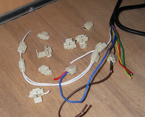

The intermittent operation could also be a result of the "Scotch Lock" style connectors they use in their hundreds all over the van's 12V electrics too. I removed over a dozen from the rear light circuit in our Avan Ray a couple of weeks ago.

To improve wiring reliabilty, remove these and solder or crimp your connections.
 Gee, those connectors give trouble Eventually!!!
