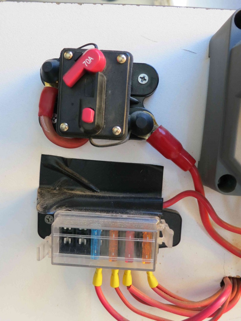

Qwik comment re overkill & manufacturer's wiring - I ran a second wire in paralle to my fridge (rather than replace it with a heavier wire) and the current draw dropped from 4A to slightly over 3A. I also have a fuse panel for each 12V circuit as well as a master circuit breaker; the circuit breaker will only cut out if there is a direct short but also can be manually switched off which is very handy.

@ Loki
can you please place a photo of that
I've been looking for something like that
Many thanks allready Loki
regards John

Sure thing, Cruising Cruze - the red lever with "70A" printed on it is the switch in the OFF position.  The red button below it turns it OFF when pushed, quick and simple.   I got it from J'car.  I have it connected between the 'Bat' connector on the regulator and the the + terminal on the battery.

@ Loki
Thank you so much Loki for this info, been looking for something like this to get for donkys
regards John
