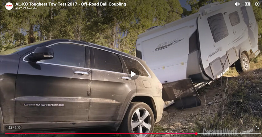

Ark couplings are similar to Alko,they can get to extreme angles.
