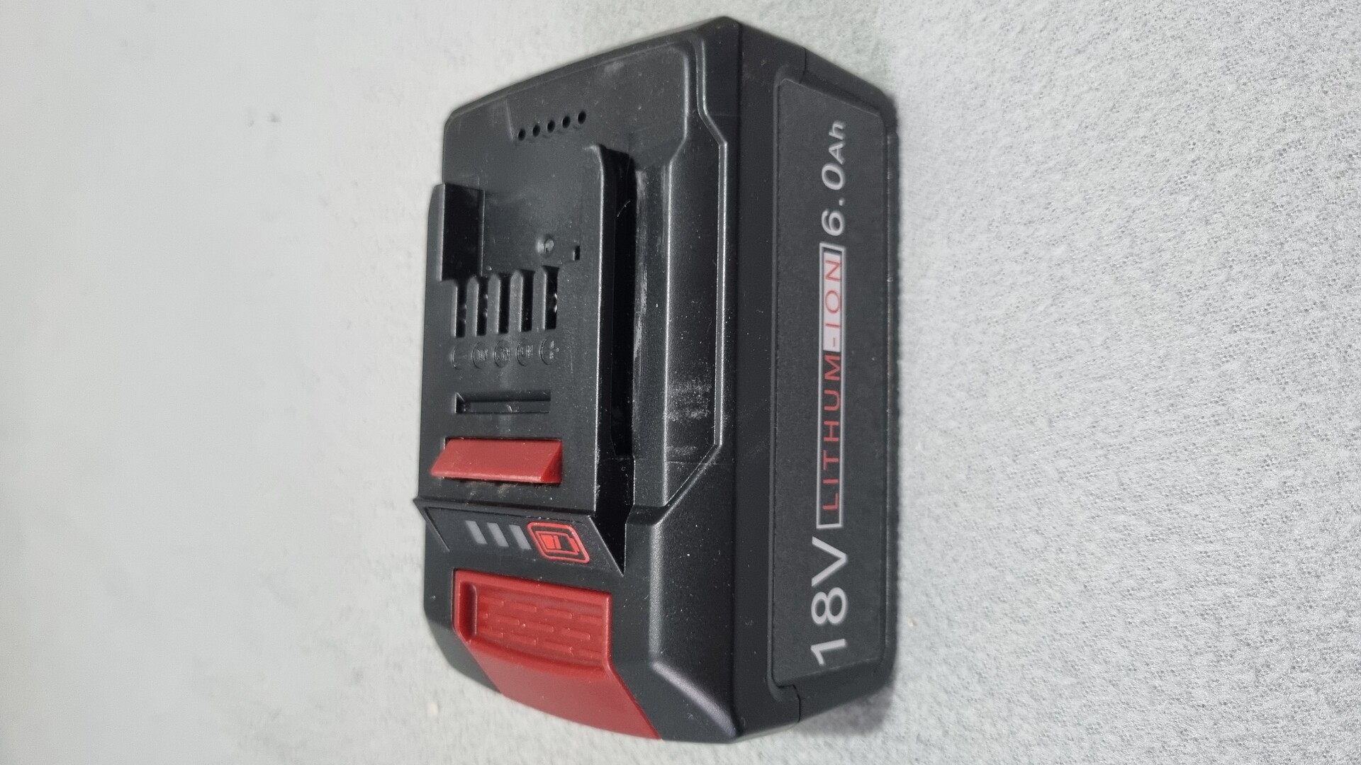

For those here that may have Ozito cordless tools, this could be of interest.
Bunnings Ozito power xchange batteries currently cost 6ah/$139 & 8ah/$179. Batteries can cost more than the product.
The equivalent to Ozito brand is the overseas German Einhell brand that own Ozito.
Aliexpress sells batteries to fit the Einhell power xchange range, which are the same as Ozito.
Priced at 6ah/$44.50 & 9ah/$47 which includes postage. Cheaper if you buy bulk lots of 2 or 4 lots.
I have bought these batteries recently and am satisfied by their performance as, also, with the performance of the Ozito brand. The batteries are a precise fit.
I am sure many have adverse opinions of the Ozito brand. This post is, however, about securing equivalent brand batteries.

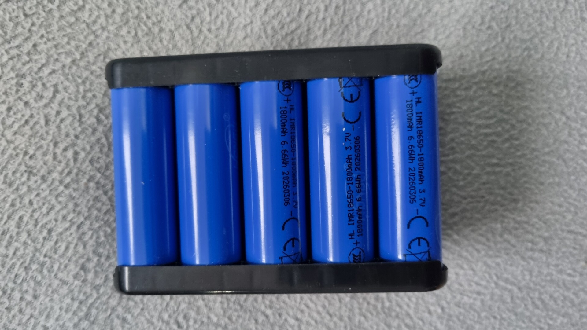

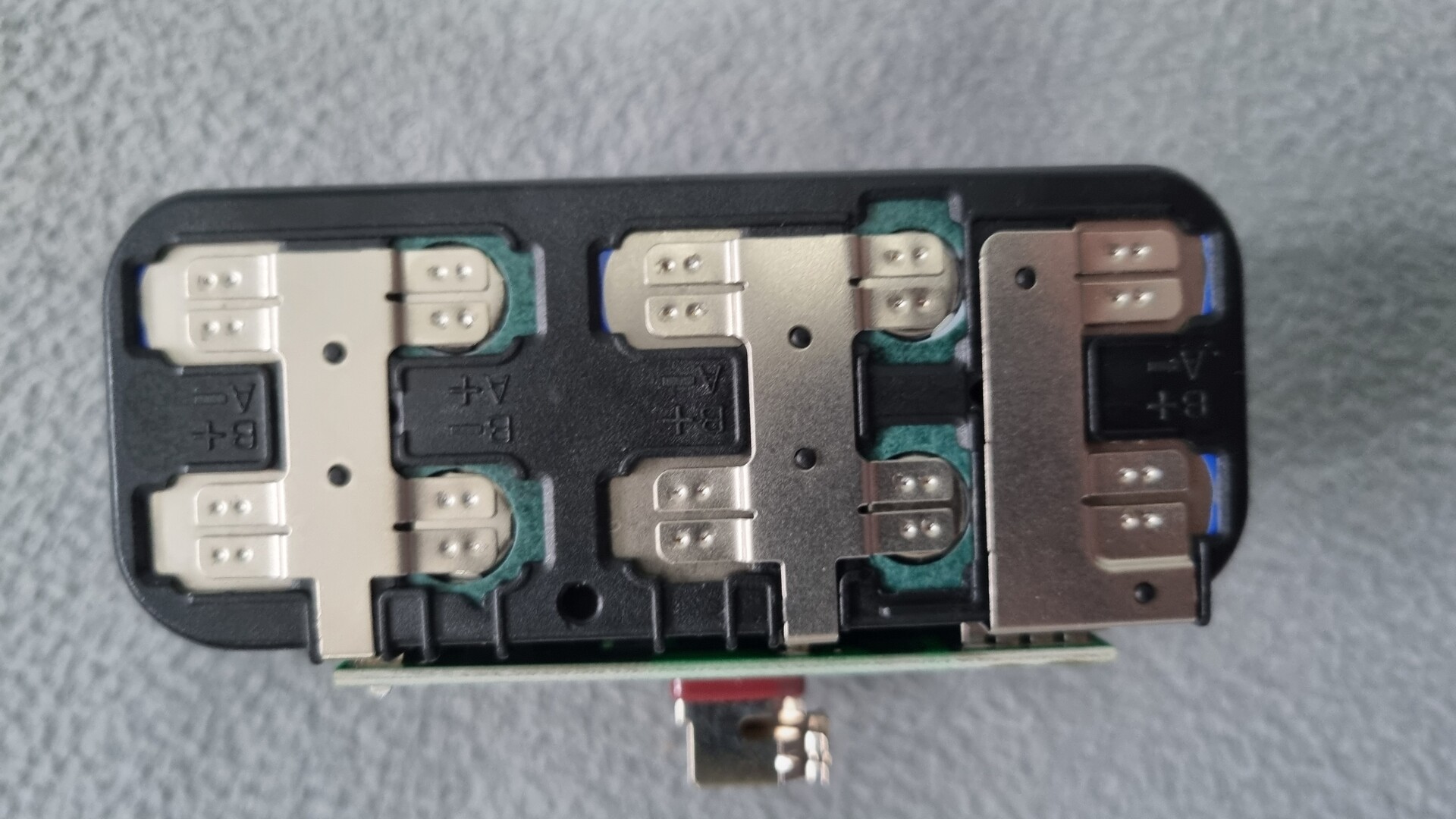

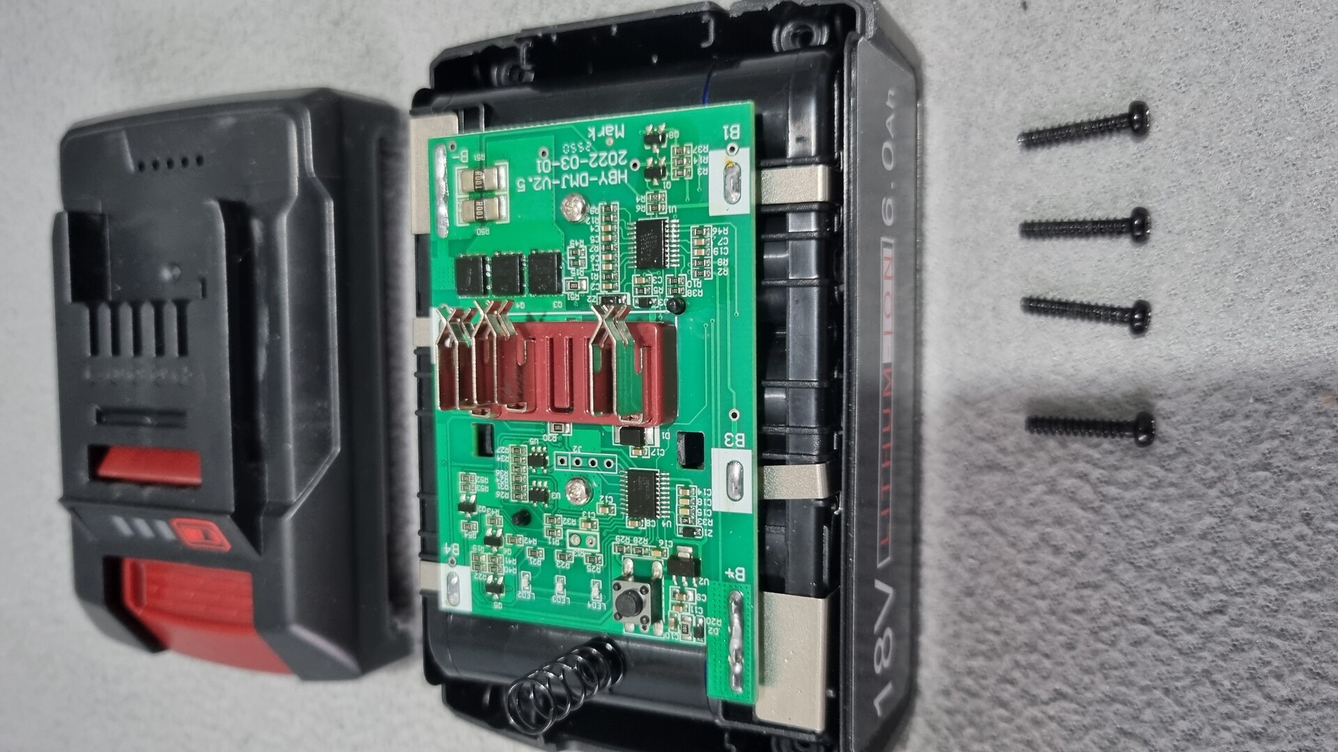

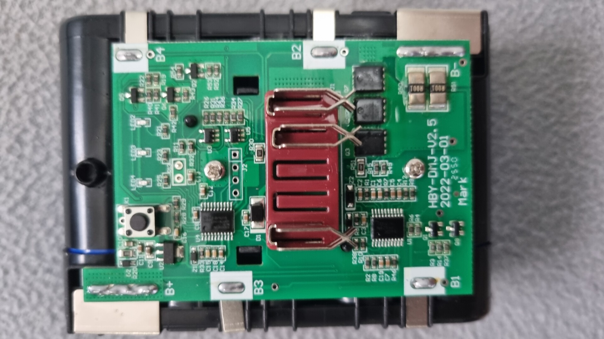

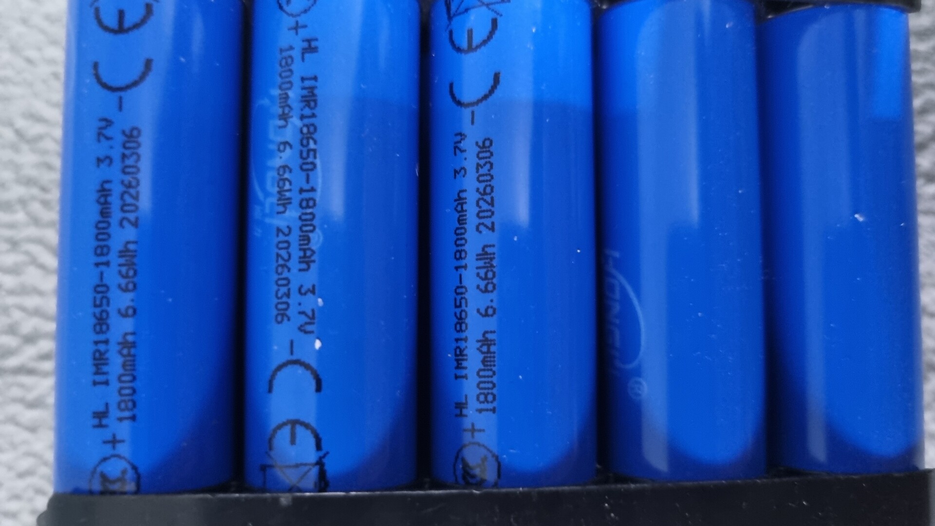

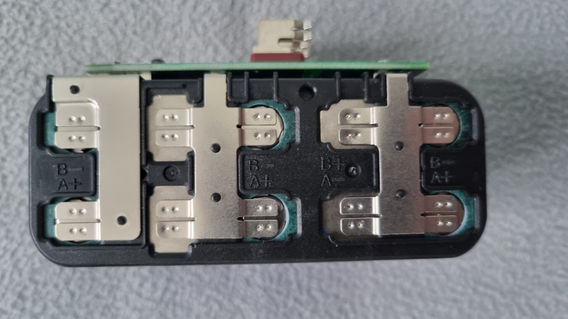

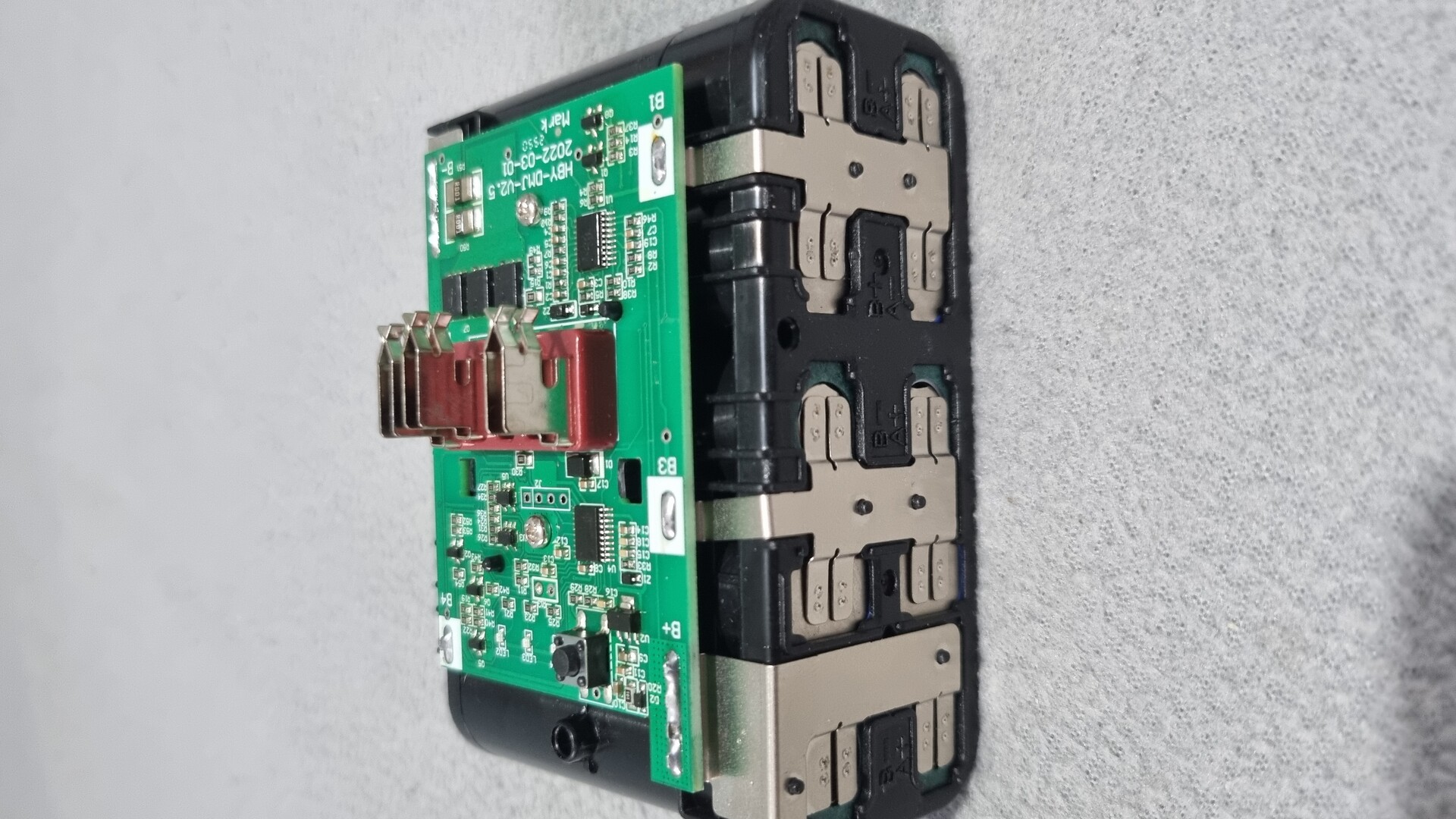

Tested neighbors 6ah "cheapie" battery for Ozito power exchange tools.
Firstly, although the sellers claim 6Ah capacity it appears that 6Wh (see battery pics) calculation has been used, which can be viewed as misinformation, as we would normally calculate electrical charge capacity in Amp Hours.
So, the sellers are actually claiming around twice the actual capacity.
The battery I tested had a bank of 10 x 1800Mah x 3.7V batteries providing 3.6Ah at 18V. The discharge test seemed to support this result. Fyi, the batteries are IMR chemistry.
I used an Ozito heat gun for the test, charging and discharging the battery 15 times. It was also a good test for the Ozito heat gun, which performed well.
The genuine Ozito (4Ah) battery took precisely 17 minutes to discharge from fully charged.
The "cheapie" (3.6Ah) battery took 15 minutes to discharge from fully charged and repeated the same result on 15 occasions.
The test results seem to show that the "cheapie" and genuine batteries have similar discharge rates.
The genuine Ozito battery (4Ah) costs $69 currently at Bunnings. The "cheapie" battery costs $44.50 including freight. A saving of $24.50.
The test shows that, in my opinion, the saving is justified. Make your own conclusions.
In addition, I have provided a tear-down of the "cheapie", and again in my opinion, the build appears of a high quality. How long the batteries last time will tell, however, 15 recharges and discharges did show the same results.
I am looking at other alternatives (more of a DIY nature) to save costs and will report on those soon.

Burt65 wrote:
 Perhaps I misunderstood your post, but I would say that you tested two batteries that are both "cheapie"... The main difference here is that, for one you also have paid for Bunnings commission (the extra $24.50)...
I think that a real test would include an expensive Brand battery (Bosch, DeWalt, Milwaukee, Makita, Festool, (you know... the brands used by workshops and tradies)), against the cheaper brands like Ozito, Ryobi, Rockwell, the new gen Black & Decker, the new Stanley, the old GMC...
It is then that I know you will see the difference, as we did in the workshop, where the expensive brand batteries just leave the cheap brand (same name but less than half the cost from Ebay, Aliexpress....), in the dust on both power, discharge time and tool performance...
Now, don't get me wrong here... I think it is good that we have a choice... If I used a drill only 50-100 times per year I wouldn't want to pay $600, but I would be more than happy to go with a Ryobi for $99 or an Ozito for $49...
But when your income depends on your tools working every day and perform the same every day, that's when you need a battery that does last... Batteries is a big business, and we need to compare apple for apple... There are so many variations of chemicals and electronic board components inside those little powerhouses, that just because two battery quotes the same Voltage/Ah, it still doesn't mean that they will perform the same...
In my personal experience (we are a workshop of 12 people) the cheap brand batteries and tools, simply don't last if used every day... However, they are a great option for the occasional user...
When in my first reply, I mentioned cheap batteries not holding up against the expensive one, this is what I meant... If you want to make a comparison try between a $160 battery and a $50 battery even if the same brand...
Thank you for the input.
My post refers to DIY users, like myself, who Ozito brand users would be.
If Ozito branded batteries are regarded as "cheapies" then all I can say is that my batteries have performed admirably well over the years and continue to do so.
I have an extensive range of cordless tools and decided from the beginning to go with a particular brand for the sake of common batteries.
The tools are used, as required, for the occasional purposes in garden and DIY projects. The quality of the product is not what I have focused upon here.
What I have been concerned about is the actual cost of original batteries compared to alternative available batteries.
What I have realised is one needs to be aware of misleading advertising, as I have already mentioned earlier. My tests revealed actual half capacity of what you get when not being able to view the internal batteries.
However, so far, the batteries themselves actually performed well at their proper rated capacities. It's the advertising that is misleading.
I have taken this to the next level, whereby, I will have a clearer view of what I am seeking with the associated cost savings. It will involve DIY on my part.
I will post my test results when completed.
