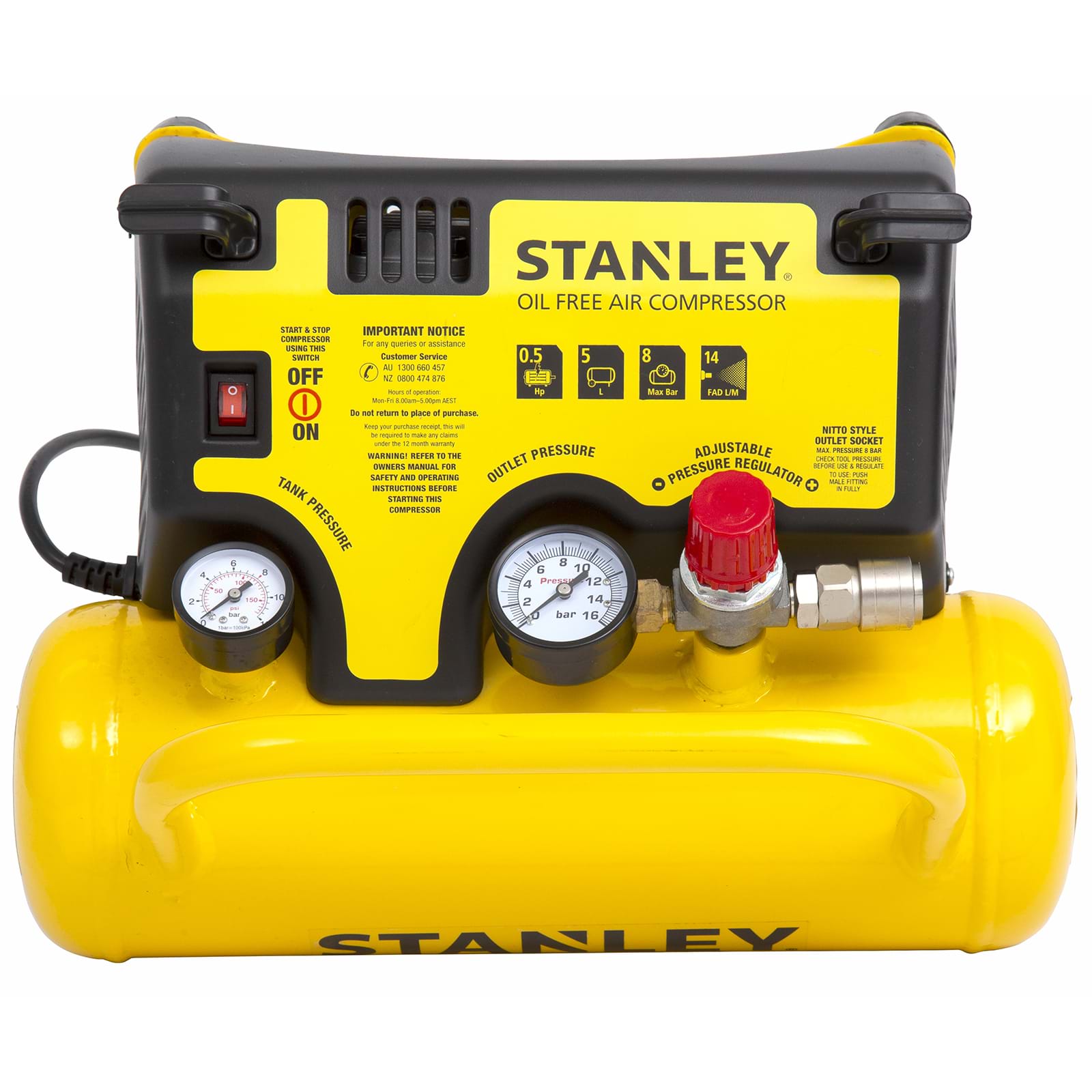

As for tyre pumps, a cheapy 150watt inverter will run my Stanley 0.5hp compressor that draws between 97 and 125 watts and is capable of 14L/min and 115psi.
ac6511-stanley-0-5hp-5l-oil-free-air-com

How many L/m at 90psi does the Stanley compressor do?
My setup is 261L/m free air delivery or more importantly 126L/m at 90psi, less air line, after cooler, drier & connectors inefficiencies. In other words 35 seconds per tyre about 65L volume from 20 to 35psi. The compressors are a bit ahead of what can be pushed through the valve.
