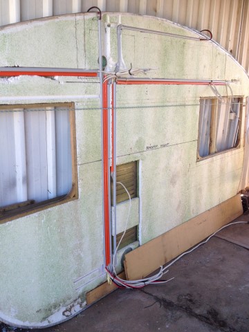

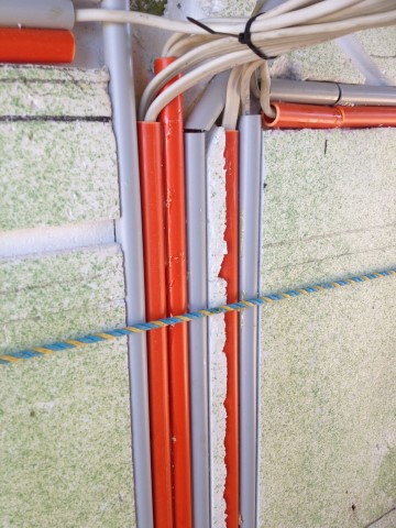

It's only some polystyrene apparently Trekka,
I had this issue with my old Franklin.
The original wiring was in grooves in the polystyrene and after 40 years all appeared ok so I (I think) safely assumed I could replace the wiring in the same grooves.
But, that little nag that sometimes pops into my head and sends me signals went off so I thought bugger it!
This is what I ended up doing.
Your framing would cause an issue I didn't have of course. Maybe stop the conduit at the frame so only the cable goes through?
Don't know.
Might be all too hard in your van so consider it Just A Thought
Jim
-- Edited by Grandad5 on Friday 20th of July 2018 10:45:14 AM

Hi Jim,
I had a look at the old wiring today that i had taken out and visually it looked okay not hard or any thing like that my old van was made in 1975. All the wiring has been replaced with new gear and double pole power points etc so it should see me out with any luck.
I like the picture you posted you should not have any trouble now with the wiring in conduit and i am assuming the wall is back on the van.
