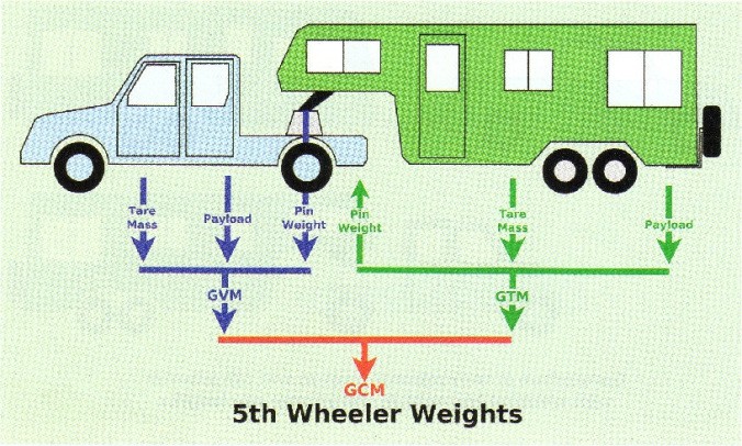

The ATM of the van you choose will determine a lot. Under 4.5t you require electric brakes. Over 4.5t you need air brakes.
The pin weight (download on your hitch) of a 5er is 15-20% of your ATM and is included as payload. The tow vehicle needs sufficient GVM and GCM. Neither of these ratings can be exceeded.tech-talk-1-picture-816-pixels.jpg
