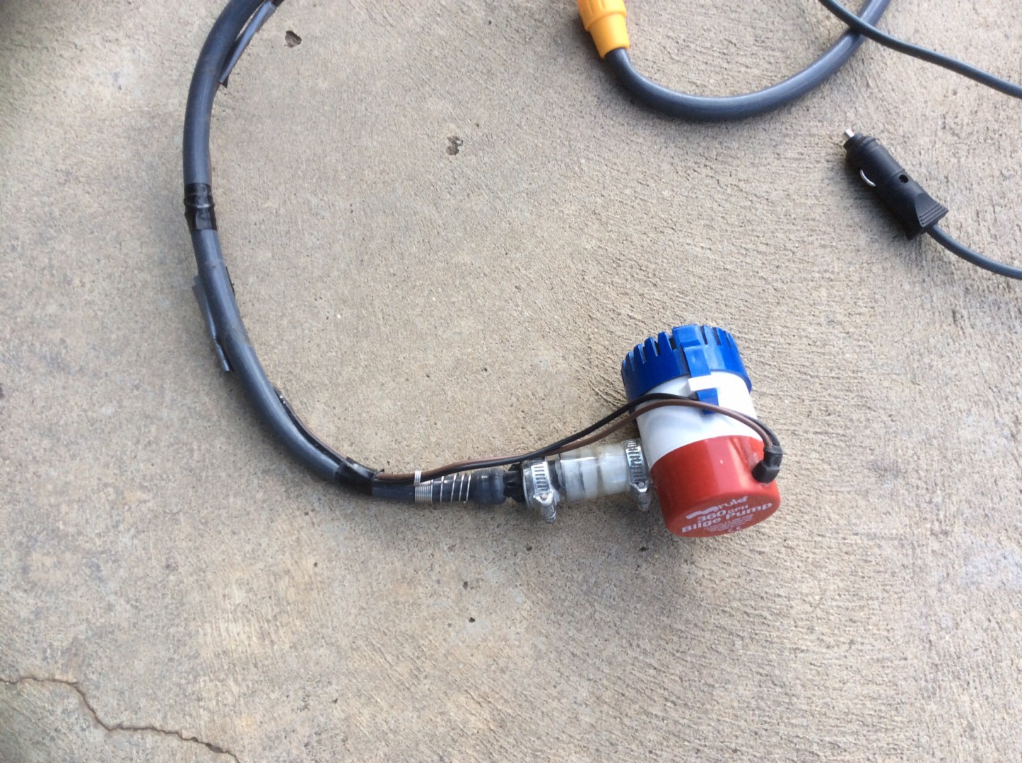

 Hi Val
         Go to any caravan accessories place Ray's out doors bye yourself a 12 volt portable shower, cut the motor off it go to a boat place or  BCF and bye a Rule Bilge pump cost about $30.00wire it on where the shower motor was,this bilge pump will pump 7 meters in height and will pump 360 gallons a hour I think about 5ltrs per gallon, just remove the shower head and fit an ext  of hose  or fit it at the pump,this bilge pump won't hert if run without water for short time,     (RULE  360 GPH BILGE PUMP ) red white and blue in colour, the portable shower Setup has a on off switch in line, i would run the water through a filter before going in the van,hope this helps.

Maybell wrote:
Sorry didn't explain ourselves very well before, We often camp beside lakes/dams that has water suitable for washing clothes, dishes showers but not drinkable. Our idea is to secure hose in water off the bottom then pump it out to our van by 12v. we don't need heaps of volume or preasure as its just to fill buckets up instead of paddle in the water to get it, prefer one that doesn't need priming every time. and with on/off switch. Most dams/lakes we`ve been to would only have about a 2-3mtre lift. Thanks once again
 A couple of pics.
Lance C
