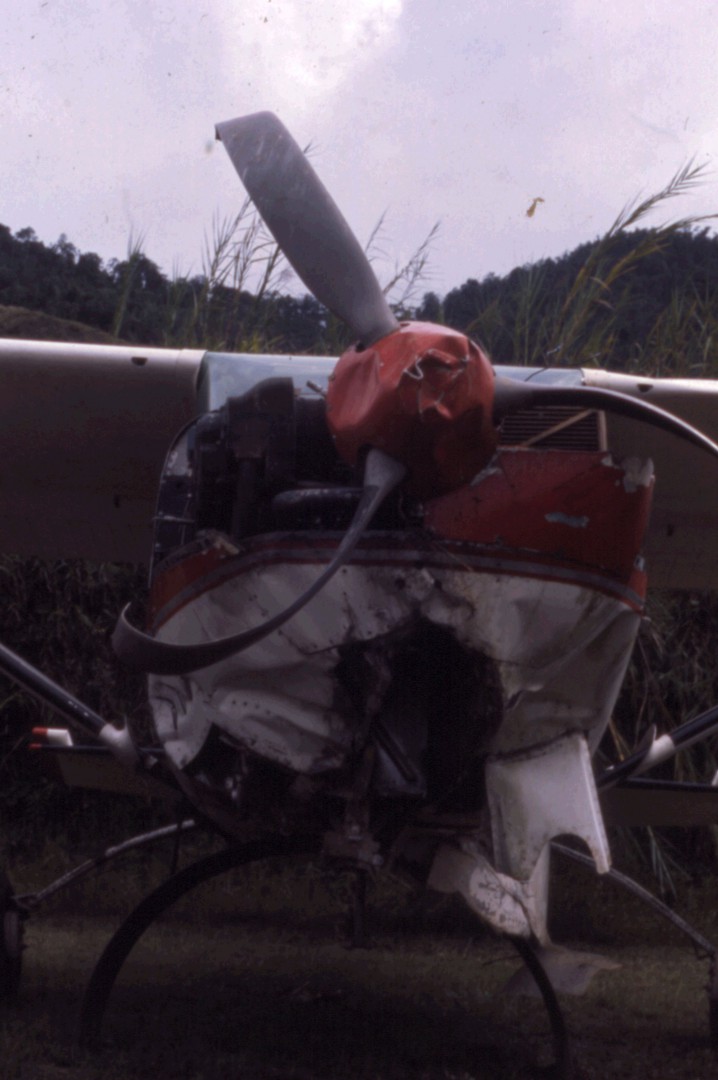

Another crash salvage, this is when I was young and stupid, now Im just stupid. I saw the job as a mission, get in, do the job and get out. Consequently I never appreciated the surroundings or the people at this place. I dont even remember the hut in which I slept, and of course I didnt keep a diary.
The Angu, called Kukukuku by their neighbors, are a small, but fierce people, previously known for their murderous surprise raids on other groups' villages.(1) They live in very remote mountainous country back of the Papuan Gulf. Until relatively recently much of their territory was a long walk from all except a few mission air strips. Quote from the net.
All I saw were these people standing around watching, dressed in the bark of trees as rain coats. They were the KuKukukus and were, I thought the last cannibals in New Guinea.
MKA1a Thats the Marawaka strip way down there, the mountains in this country are just amazing.
MKA2 On final approach, you cant change our mind and go around.
Anyhow we arrived and I think it was on a Cessna 402a with our tools and gear.
MKA3a & MKA4a The plane looks a bit sick, flipped on its back as well.
MKA5a It was a long push back to the start of the strip and the village. Many hands make light work.
I think we stayed in one of the local huts. Regarding sleeping and eating etc., I don't remember a dammed thing. We worked long hours to get the job done.

With the engine removed, its all pretty much crunched up. Working from day break and well into the night, we drilled out the rivets, bashed everything to its approximate shape and bolted or pop riveted it back together. All we had was a generator and a couple of electric drills.
If I remember correctly we reinforced the engine bay with one inch steel angle, a bit of steel plate here and there etc. Sukarno and Jacob my two assistants were as good as they came and together we worked as a good team. We worked from sun up until well into the night.
