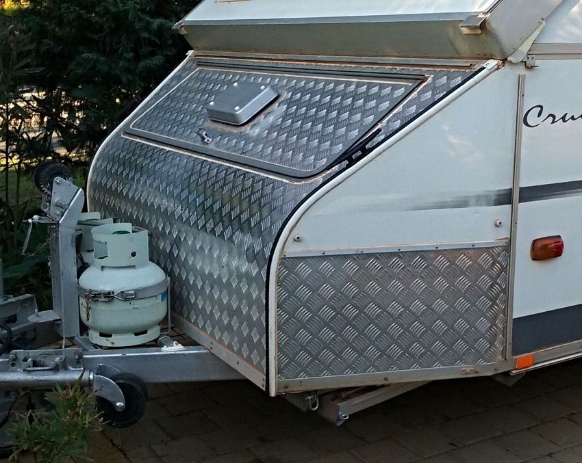

Yes I changed mine on our Cruiseliner  using the   propeller plate Vinyl.   Silver (ally coloured) stuff you can get from Clarke's Rubber. I was going to do it in Aluminium sheet,   but Ellie says "Oohh this vinyl looks good why not use this"   I always Obey  even when I think "I don't really like this stuff".
 It was fairly easy to do.  Strip the fittings off and in the case of the Cruiseliner the Boot Lid.  Remove all the old Vinyl.   The boot lid is the trickiest bit if using non standard vinyl like the stuff I used.   However  This vinyl after a couple of years in the sun shrunk and was pulling out from the edging clamp strips and the Boot lid trim.
I stripped it all off again about four months ago and covered it with,    Five Bar Pattern Aluminium Tread plate  1 mm thick. 0.9mm would be easier if you are not used to working with sheet metal. You can just lay it an and form it to the profile of the van.
Cost me about $80.00 for materials and about eight man hours to do the job. Although I did it Over three days as it was Summer (WA) and too hot to work outside after 10:30 AM.   Just take your time.
Tools used.  125 mm Angle grinder, Jig Saw,  Battery Drill, Drill Bits, Screwdriver Bits Hole Saw, Tape Measure, Fine Texter Marker, Stainless Screws (to replace the original ones) Pop Rivets for the boot lid.
Aluminium sheet came fro Ulrich Aluminium in Perth.

 Have a look at my Avatar.    The Burgundy stuff just peeled of no problems. I did not have much adhesive if any as I remember to worry about.  I certainly did not have any issues that way.
 I had already painted it about Three times with special (expensive) Vinyl Restorer Paint (Burgundy)    It did not last long  going dull and shabby after about  nine months.  My van by the way spends most of its life in the sun.
