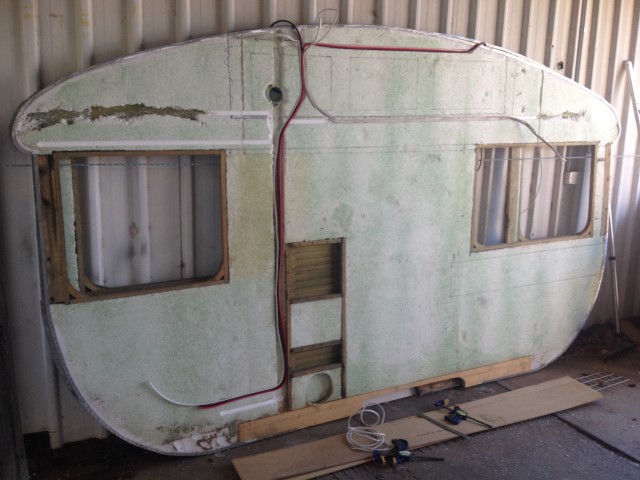

For the sake of historical accuracy, may I point out that this "High-tech" method of construction was first pioneered by Franklin Caravans back in 1967 here in Oz.
The method was jointly developed  by Franklin and 3M adhesives.
Franklin constructed a new factory in Wendouree, just outside of Ballarat for the process.
Here's a pic of my 1969 van wall with inner skin removed. as you can see, there is a small amount of timber framing around the windows and where the front and rear windows attach.
This van is now 45 years old. The inner skin came away relatively easy due to water ingress over many years. The outer aluminium skin however would be well nigh impossible to remove without severe damage to the insulation.
Moral of the story.
Their ain't nuthin new under the sun.
and, Aussie manufacturers have led the world many times over.
Jim
