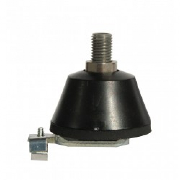

Having said all this, what happens when you solder your coax onto a standard mobile antenna base, as shown below:
You have done exactly the same thing, you have separated the inner conductor and the outer conductor changing it's dielectric constant.
Therefore at this point you must also be introducing a change in impedance.
People who know what they are doing do not use those bases above 200 MHz. The reason is the same one that is the same reasoning that you are erroneously using to justify why you can bodgy a cable together and get good results from it. If you want a good result from a CB antenna you should use a base like this one. It has an above ground mount as well as a much better cable termination. Yes you can get away with simple cable joining but if you want good efficiency you should terminate a cable jack on the cable leading to your set and a cable plug on the cable leading to the antenna. Anything less and you may as well forget installing a new antenna and just get a low powered hand-held (for probably the same price.)
Power losses increase as frequency increases. When you get over 200 - 300 MHz things start falling apart rapidly.
Peter, if you had read the post in context you would have seen the image was for explanation purposes. You would also be well aware there are two variants of this base type, one for HF and one that is used on VHF/UHF.
