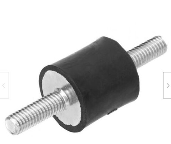

I don't notice the exhaust but I would like to know how to deaden the ticking noise from the pump. Ian
I used an engine mount to fix the pump to the chassis,even better if you can keep it of the chassis as it tends to amplify any sound.
Also disconnect and turn the Pump around then extend both inlet and outlet fuel lines so they have a 180 Degree bend to travel around then pulsing movement of the pump does not travel back along the fuel lines.....the bends absorb the movement and the sound. (I have also used this method when installing similar fuel pumps in cars ......has a good effect) The less "fixings" that the fuel lines have to the body the quieter it will be.......KB
Looks like you have also changed the original clamp to a rubber lined hose clamp, looks good to me, I'll give that a try,. thanks Ian
