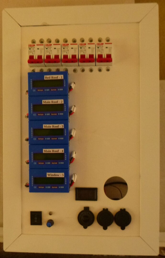

A lightening strike (for instance) won't care which wire it follows. This is my new build under construction. 430W of panels per double pole DC breaker.
They are not expensive.
DC 1000V Solar Mini Circuit Breaker Overload Protection Switch 6A/10A/16A/20A/25A/32A/40A/50A/63A 2P DC1000V Photovoltaic MCB PV - AliExpress 13
