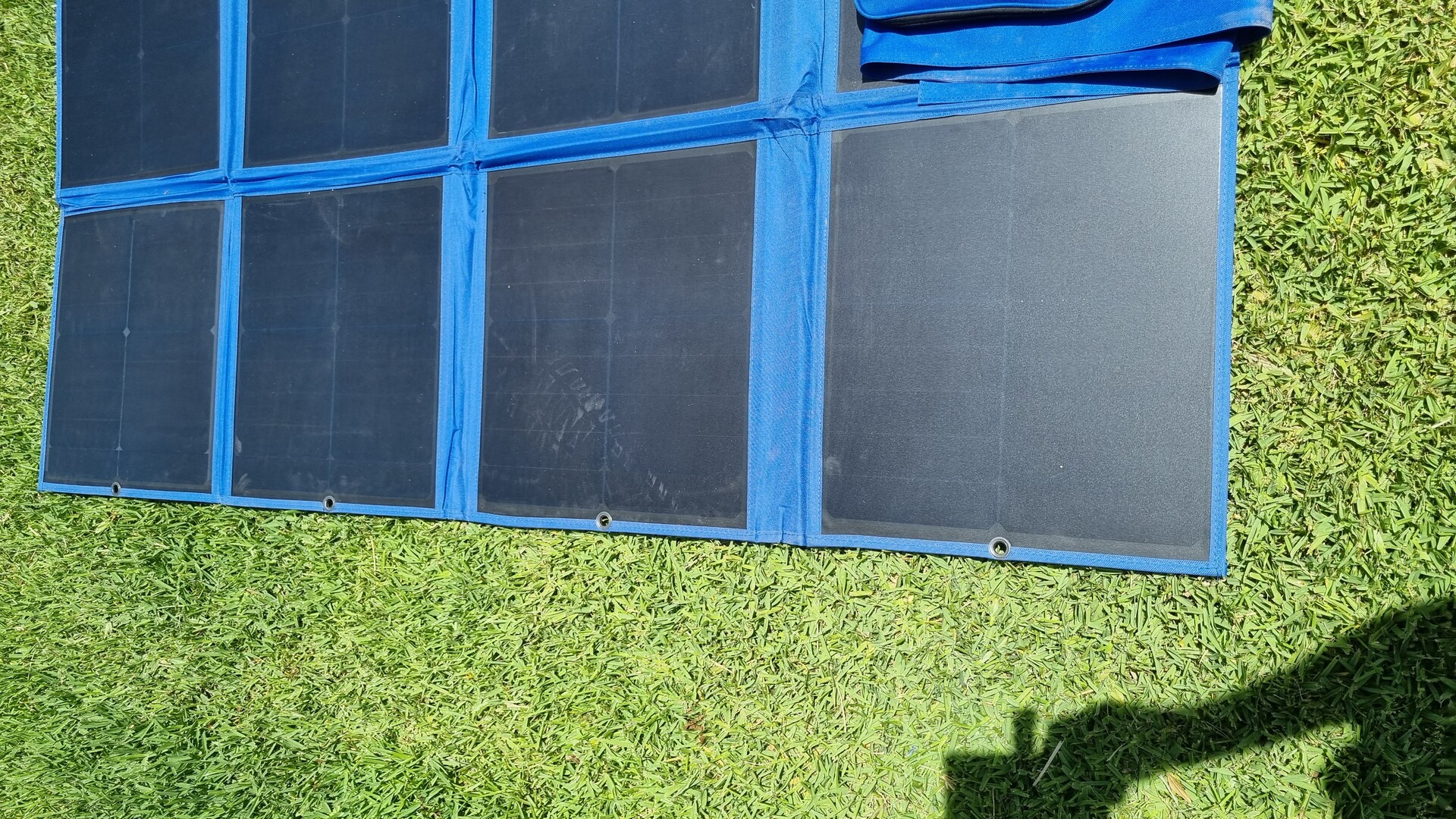

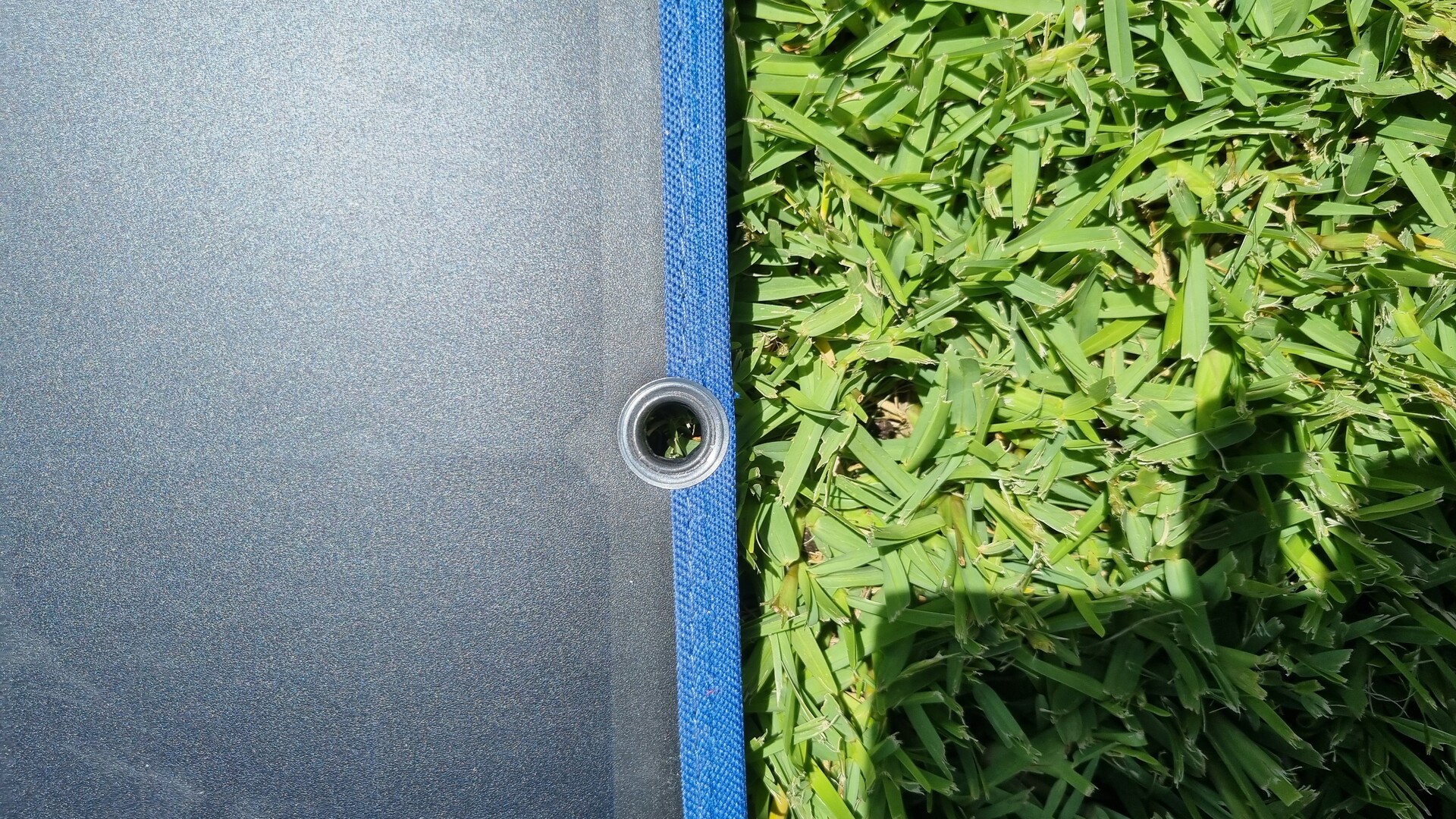

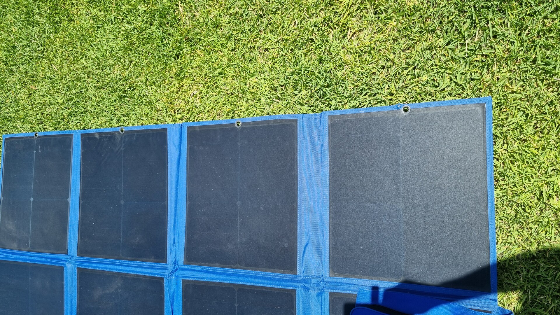

Update to my post...
Further research revealed that the upper and lower borders are not photovoltaic or electrical. The 3cm border is purely strengthening.
So, it is possible and the eight eyelets have been installed. Tested and all good.
I have posted pics in case anyone is thinking of doing similar.
