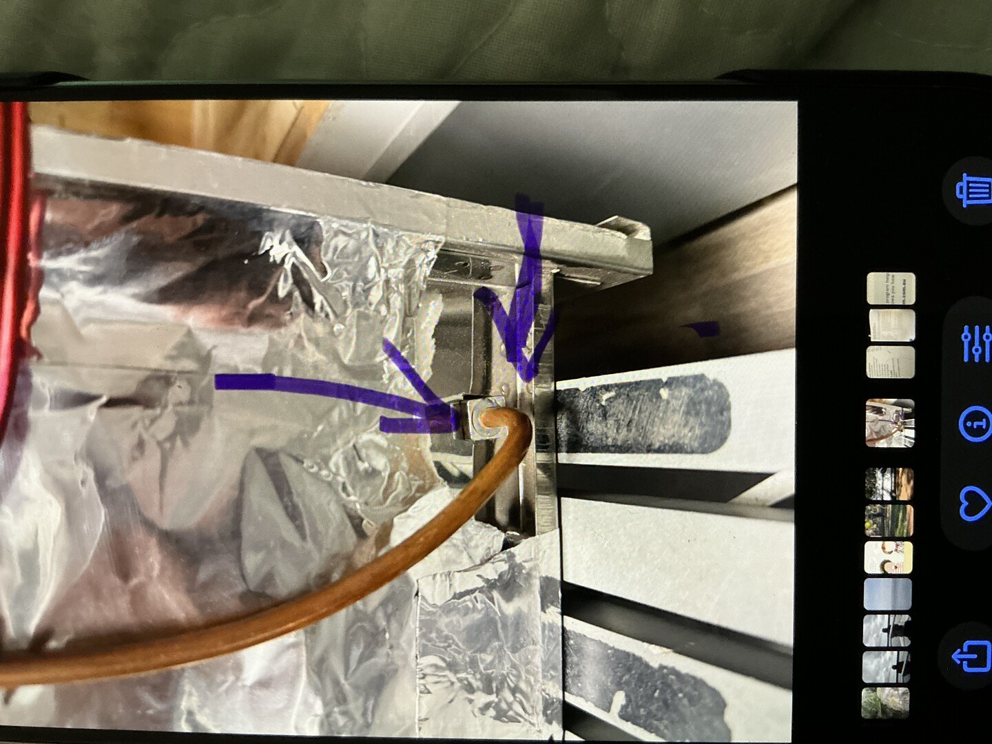

So . The gas pipe into the oven had worked itself loose the fitting was lying free .. definitely needed a visit from the gas fitter .
Jarrah said
10:48 AM Sep 5, 2025
Here is a pic of the oven and the fitting that had worked loose , purple arrows
