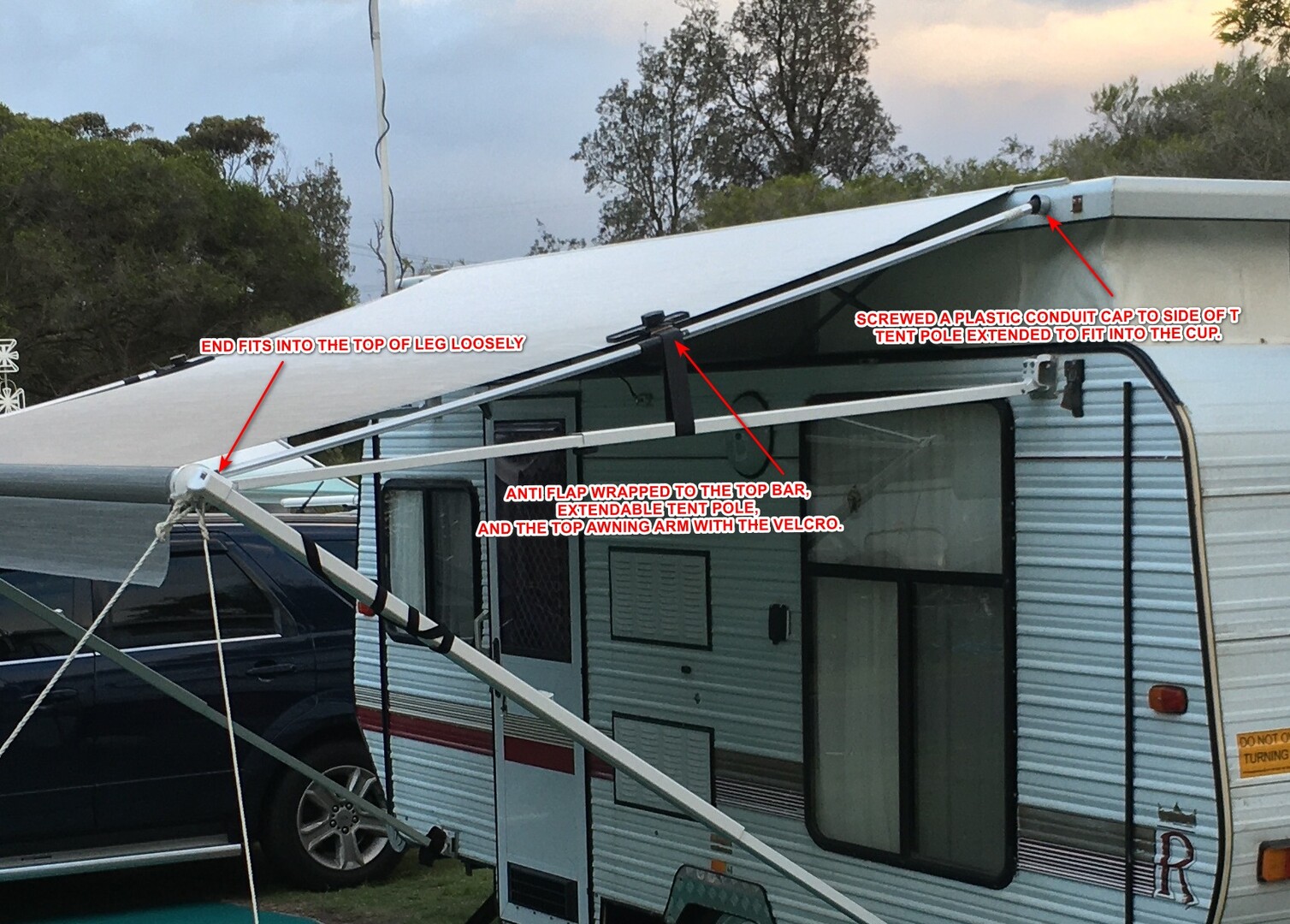

oxleigh said
10:05 PM Nov 16, 2025
Brianvicki wrote:
Im looking at putting an annexe on our poptop, but use shade cloth front and sides.
i am aware I can purchase anti flap bars for the side which clamps onto the awning and has a rope track for the side to slide into.
has anyone had actual experience in doing this and is there anything I need to be aware of?
also, is there a side (end) awning out which can actually extend over the caravan tunnel , which I have a slide out cooker and the. Come down, so I can stay Out if the rain when cooking ?
This is my anti flap mounting, I also have end walls to fit the angle at the top an peg to the ground, they slide into the awning sail tracks on each end of the awning to the ground, there is a front wall that slides into the sail track on the awning roller.
