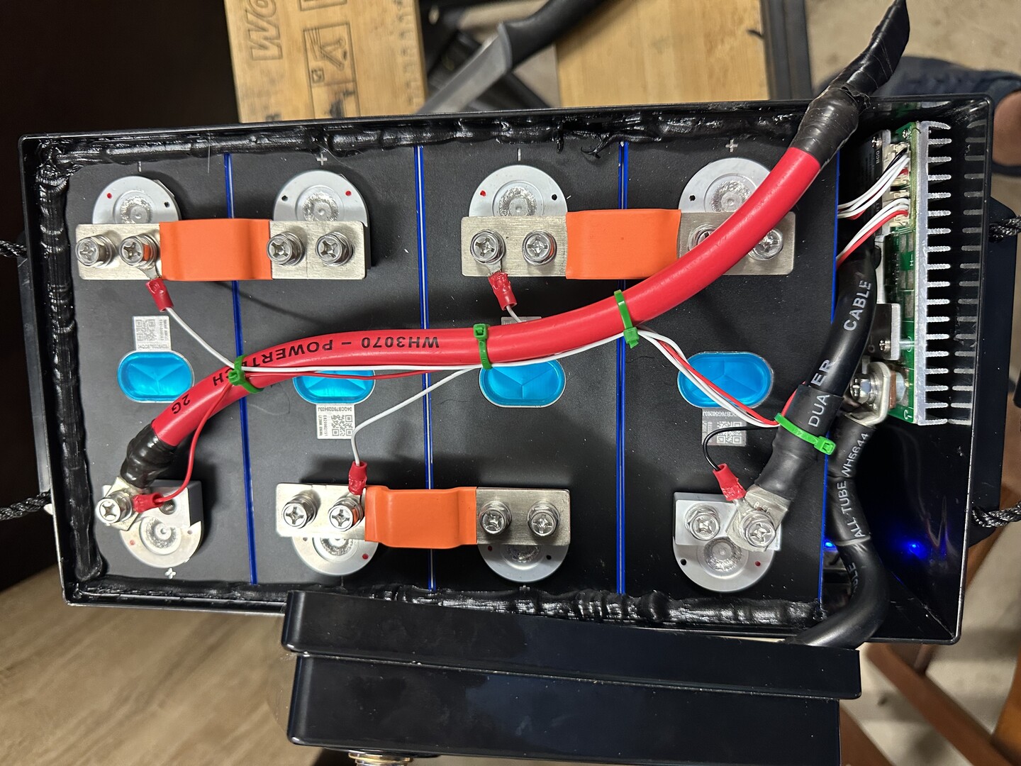

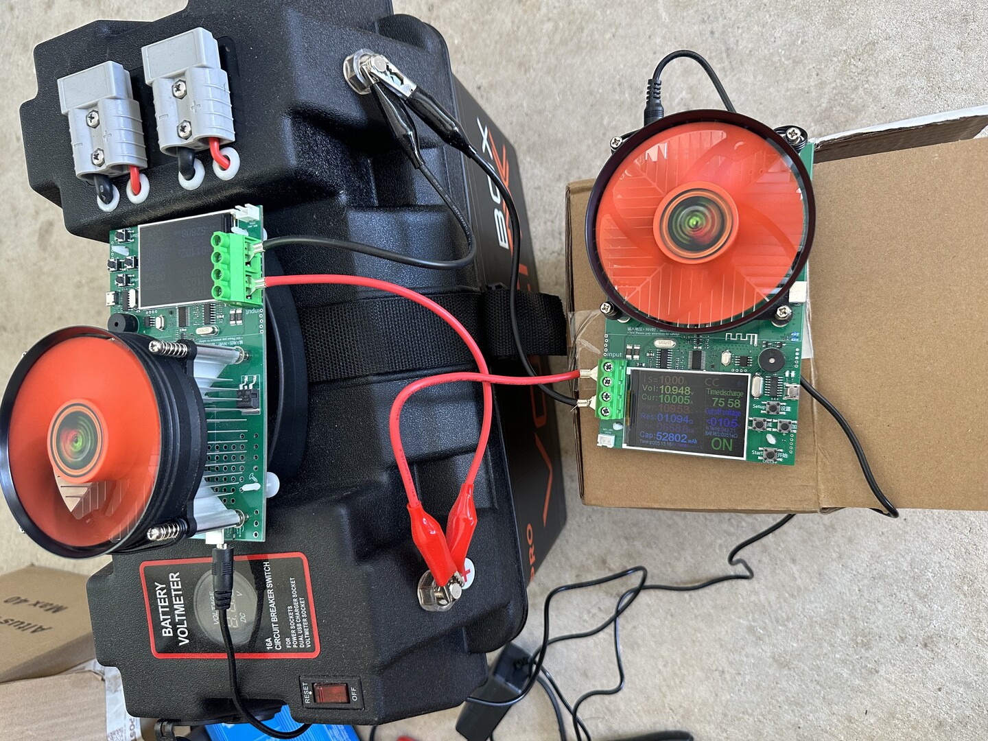

I build my own LiFePO4 batteries but recently bought a 100Ah VoltX LiFePO4 battery and a seperate battery box and was pleasantly surprised at the quality. A number of capacity tests drew 107Ah.
If you tell us what solar charger, mains charger or DC to DC charger you have we can tell you whether they are suitable.
Below is a 280Ah LifePO4 that I built a few months back plus the 100Ah VoltXbeing capacity tested. The battery box looks a little different to that being advertised.
Last year I built two 100Ah batteries but now with such quality LiFePO4 batteries available at low prices at times it isnt really worth it.

Please advise what the large orange discs are?

Linwood wrote:
TimTam,
They are simply the fans that are running on the capacity testers with the heatsinks beneath. If you look closely at the display on the one you will see it is drawing 10A. The reason I have two running is that LiFePO4 batteries are discharge tested at 0.2C or in this case 20A for a 100Ah battery.
