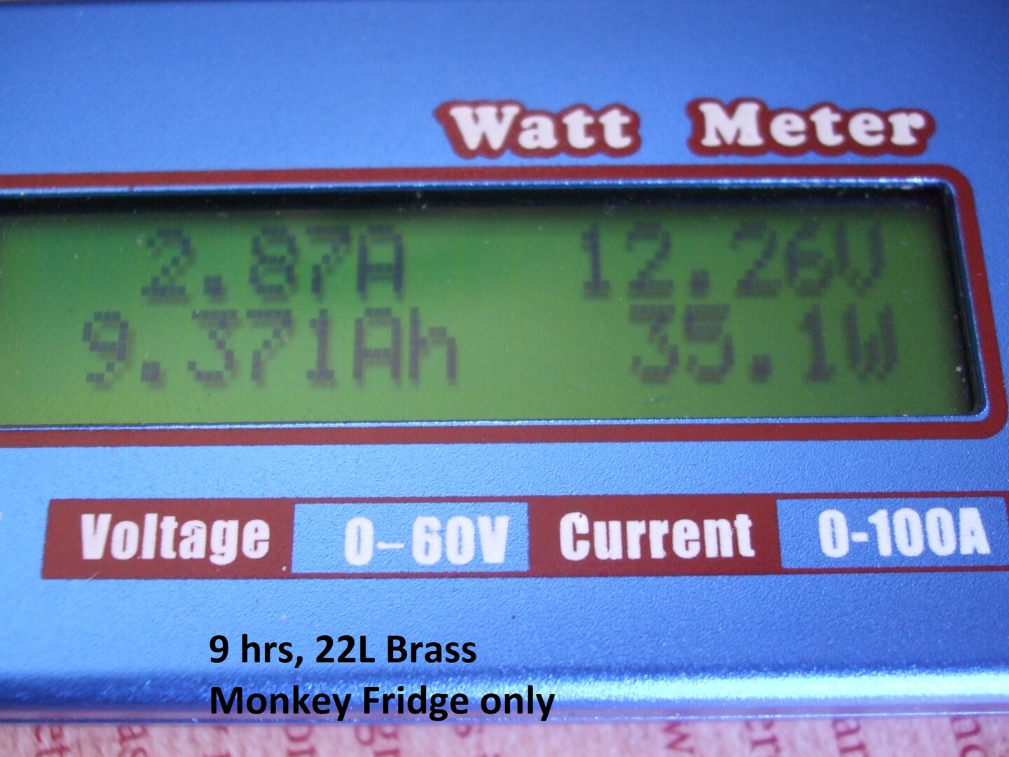

I use a 22L Brass Monkey fridge on the back seat of my car set at 0-4 Deg C. I run it of a 30Ah LiFePO4 battery siting on the back floor of the car. On average a shoping trip is 9Hrs & the picture shows the power consumption for that time. I just recharge the battery when i get home. The charger i use is designed for LiFePO4 batterys & shuts off when its fully charged. When i leavethe fridge is already down to temp.
