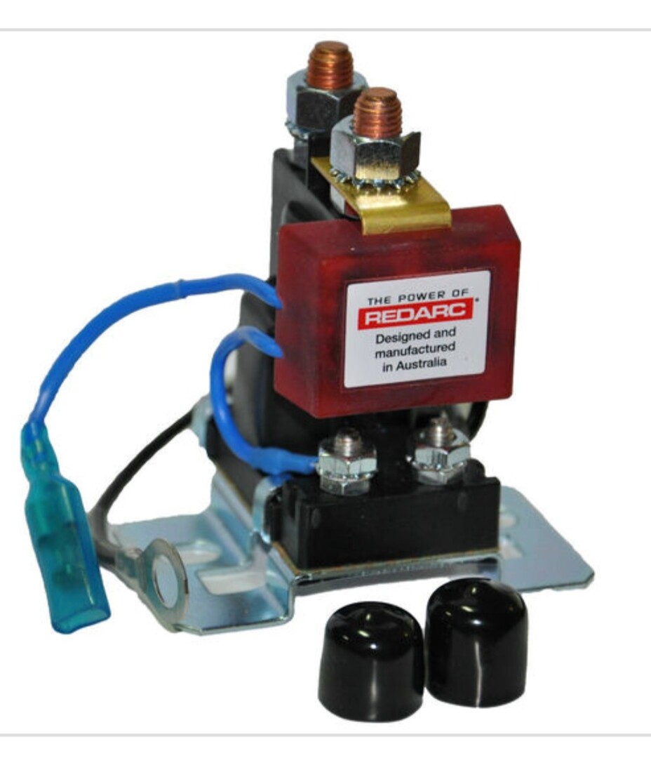

Do you think it the black box in this picture
I haven't seen one like this
Laurie
Looks a lot like a redarc VSR from the pic you posted Laurie.

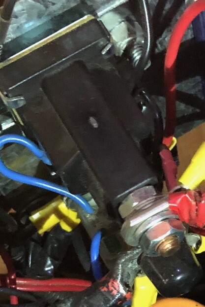

Maybe, it looks like that at 90 degrees
I will check again tomorrow

It is a Redarc VSR
The way it was mounted I could not identify
