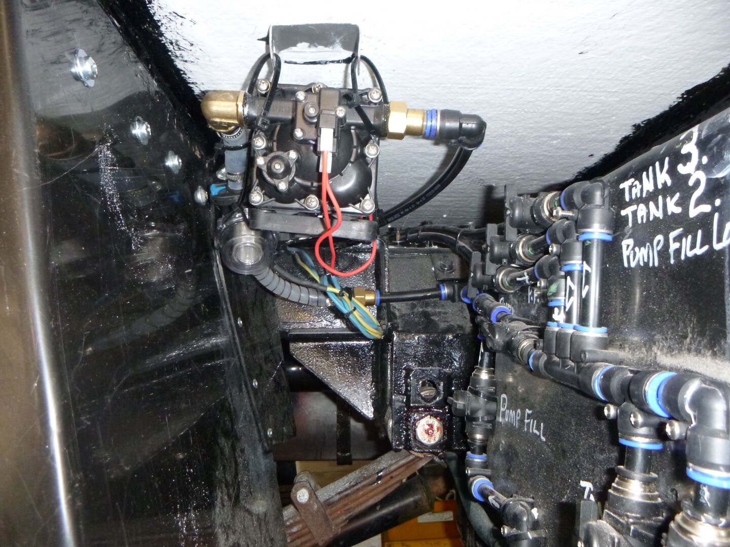

Peter_n_Margaret said
05:38 PM Jan 25, 2025
I don't "mount" my pumps to anything solid, I hang them from something above using zip ties through the rubber isolators. And make sure the in and out hoses do not constrain the pump movement or noise will be transmitted through them. Cheers, Peter
In this case it is hung from the pipe outlets at one end and the rubber isolators at the other end.
-- Edited by Peter_n_Margaret on Saturday 25th of January 2025 05:42:36 PM
If the inlet and outlet pipes are connected directly to the pump it holds the pump rigid and transfers the vibrations through the pipes to the caravan body. This causes a lot of noise when the pump is running. The pump should be installed with 450mm to 600 mm flexible lines to inlet and outlet of the pump so as to insulate the the pump noise from the pipes .
Spot on reply.
