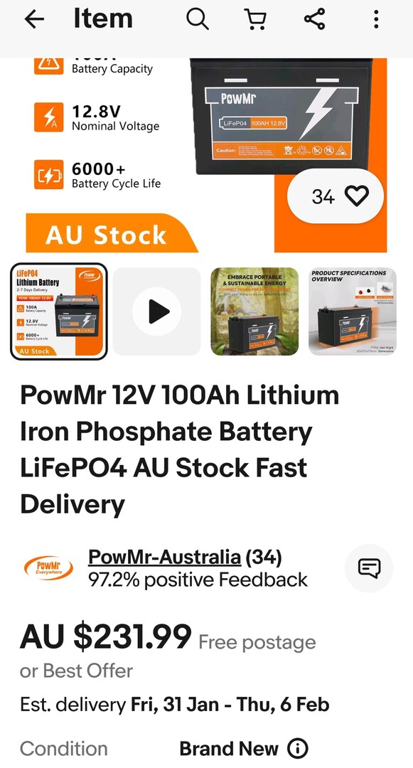

I was going to buy a gentrax lookalike; see this post: https://thegreynomads.activeboard.com/t71042510/gentrax-12v-100ah-lfp-look-alike/?page=1#comment-71122144
But I ended up buying a PowMr 100ah 12.8 LIFePO4 for $231 with coupon from ebay.

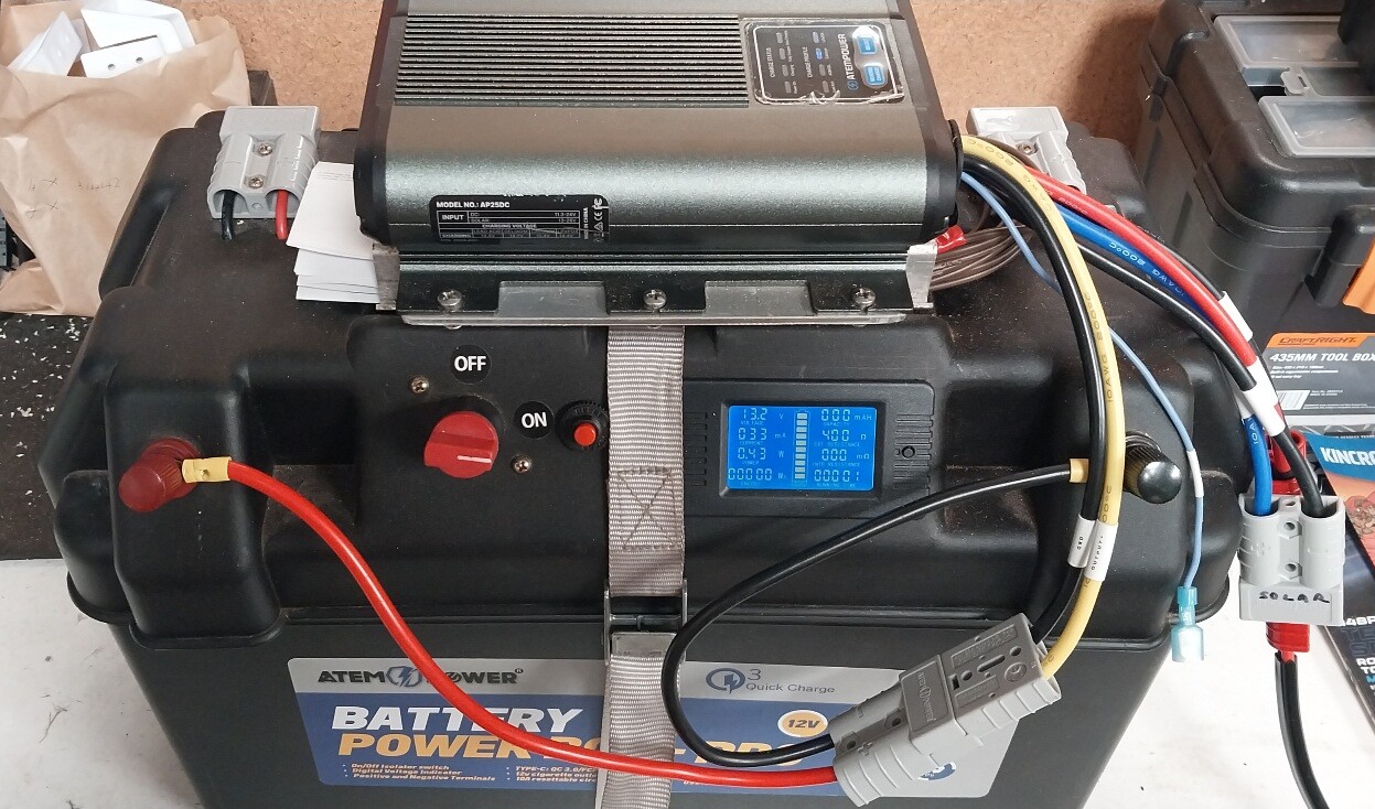

I installed a 200A 6.5-200V DC Power Battery Meter with External Shunt into my battery box and set the cut out at 11v and the fridge to 10.5v
For those who are interested here are some pics and links to the Battery. The youtube tear down shows the battery and its components which look to be well built. I'll also include the specs PDF or link to the battery.

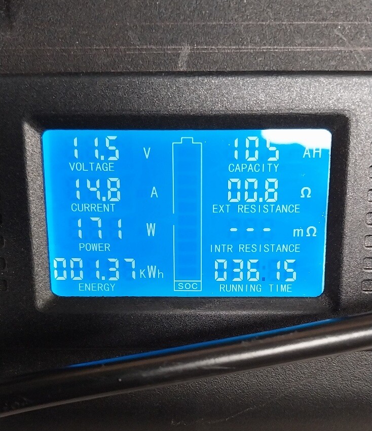

I've just completed another test on this battery after getting a full charge into it (via dc-dc while driving), I set up the fridge again and the result after 36 hours is shown below. To borrow a quote from Allan Millward " I'm well pleased "
For the price I'm banking on maybe 2000, plenty more than a AGM.

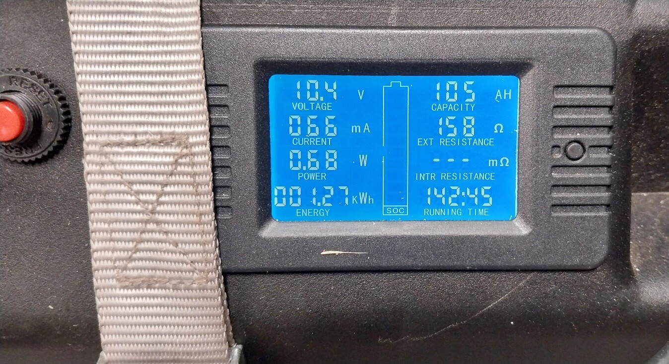

On recent test with fridge set on eco and @ 3deg I got over 142 hours of run with a draw of 105ah before the BMS cutting out.

When properly testing the capacity of LiFePO4, the test is run at what we call 0.2C so in the case of a 100Ah battery that is a 20A draw which should run for 5 hours in theory and deliver the 100Ah. So in your case, when drawing an average of 0.7A one would expect to get more than 100Ah. If one was to draw a current of 100A from it then it would not actually last 1 hour and not yield 100Ah. This is due to the internal resistance of the battery and other efficiency losses.
https://cdn.shopify.com/s/files/1/0746/0415/1079/files/PowMr_POW-100AH-12.8V_LiFePO4_Battery_Specification_Sheet_compressed_2c6011a2-14b2-4c54-ad79-6e979b3dc0ce.pdf?v=1728355512
Here's a pic of the shunt fitted to tne battery box withe Atem DC-DC 25a charger
