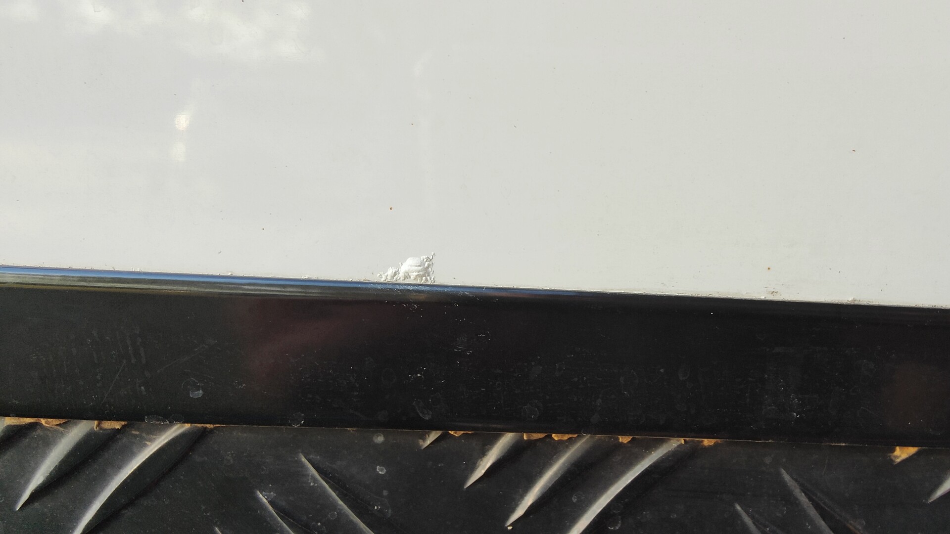

Hi all, new to the group however am very grateful for any help and advice. My 4 yo caravan has begun developing what looks like 'rust' to the cladding and appears as sporadic bubbling along the area joining the cladding to checker plate. Has only just started.
The condition of my van is very good and the sealant appears to have no visible degradation. What is happening here? How do I rectify this?

It's Aluminium corroding where it meets a different metal, grind back affected area and treat with something like ACF50.

Re (It's Aluminium corroding where it meets a different metal, grind back affected area and treat with something like ACF50.)
Thanks for the info p67

What "different metal"?
TimTim said
05:35 PM Jan 11, 2025
Peter67 could be spot on. Very common on aluminium boats where stainless steel screws are used and causes the paint to bubble. I have it in many places on my boat. If you have been parked near a salt water environment it will accelerate it.

I used to manufacture security doors & screens. One of the requirements of the AS was to use monel (nickle alloy copper) rivets to both provide both more strength than stainless units and to provide a stronger resistance to corrosion.
If you're interested it might be worth checking them out.

Thanks for the sound advice all. I will attempt to remedy via a reputable company as the seller has cleaned his hands of the van and me.
