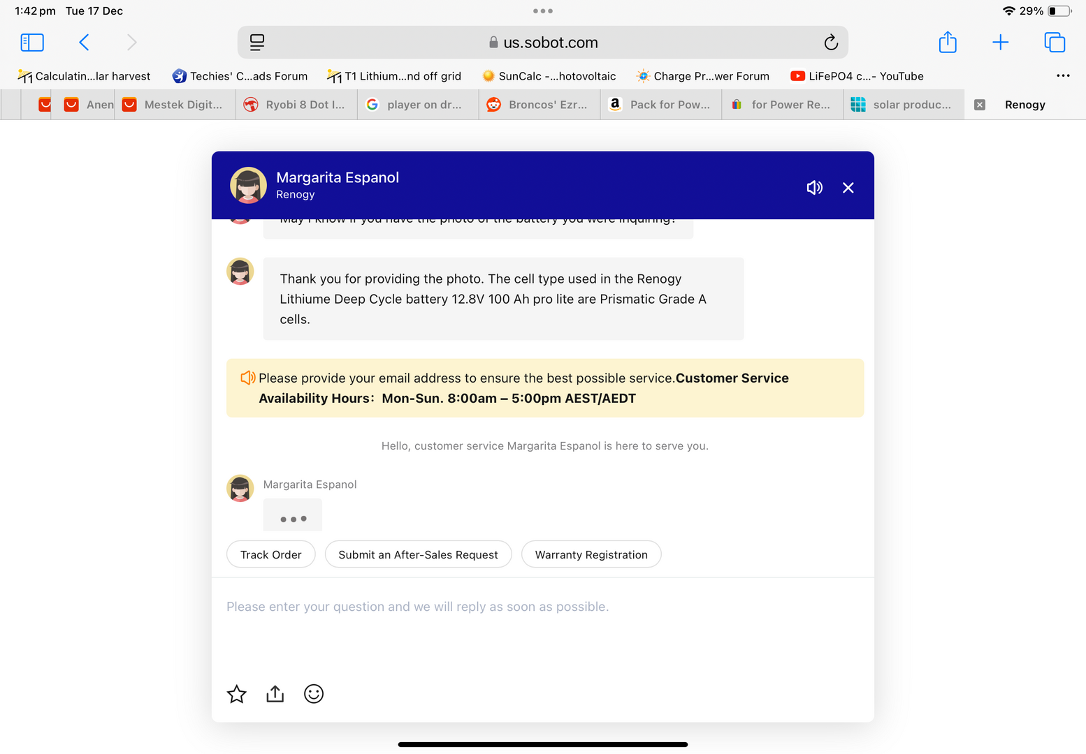

Thanks for that, after having another look at these batteries, I can also not find on either the Renogy or Supercheap website, if the Pro Lite battery is Prismatic, Pouch, or Cylindrical cells in construction. Only that they are advertised (on both websites) as EV grade LIFeP04 lithium battery cells.
Hopefully anyone who wishes to purchase this battery, will ask the people selling them, exactly what type of cells are inside the case

I went on line and asked and apparently they havent updated the specifications for it yet.
Thanks for that Tim, I appreciate you finding out for me, that they are Prismatic cells
