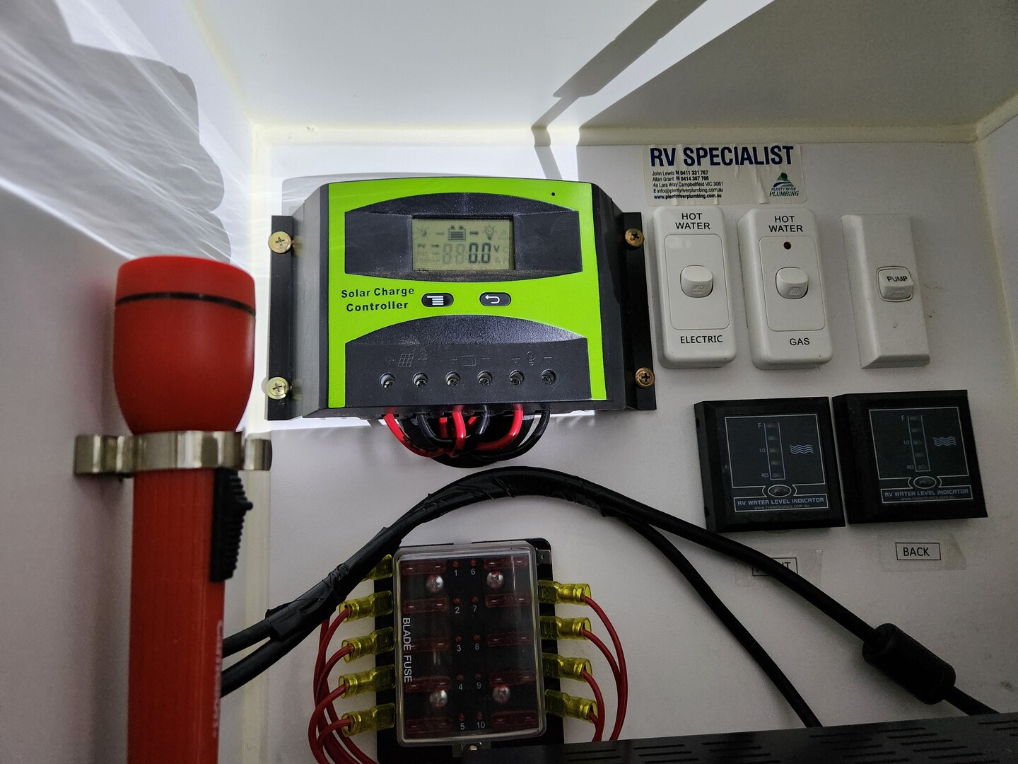

Let's start with "Why is your solar controller NOT "Li capable"?"
I solar charge my Li battery at 14.0V. That is LESS than that typically used for AGM and is the maximum that the rest of the system will generally see.
I then float the Li at 13.5V. They don't ever "punch out" "14+ volts".
In emergencies I also direct charge it from the alternator which runs at 14.2V. No DC-DC required.

I was under the impression that solar controllers needed to be designated as Lithium capable for proper use with those batteries.

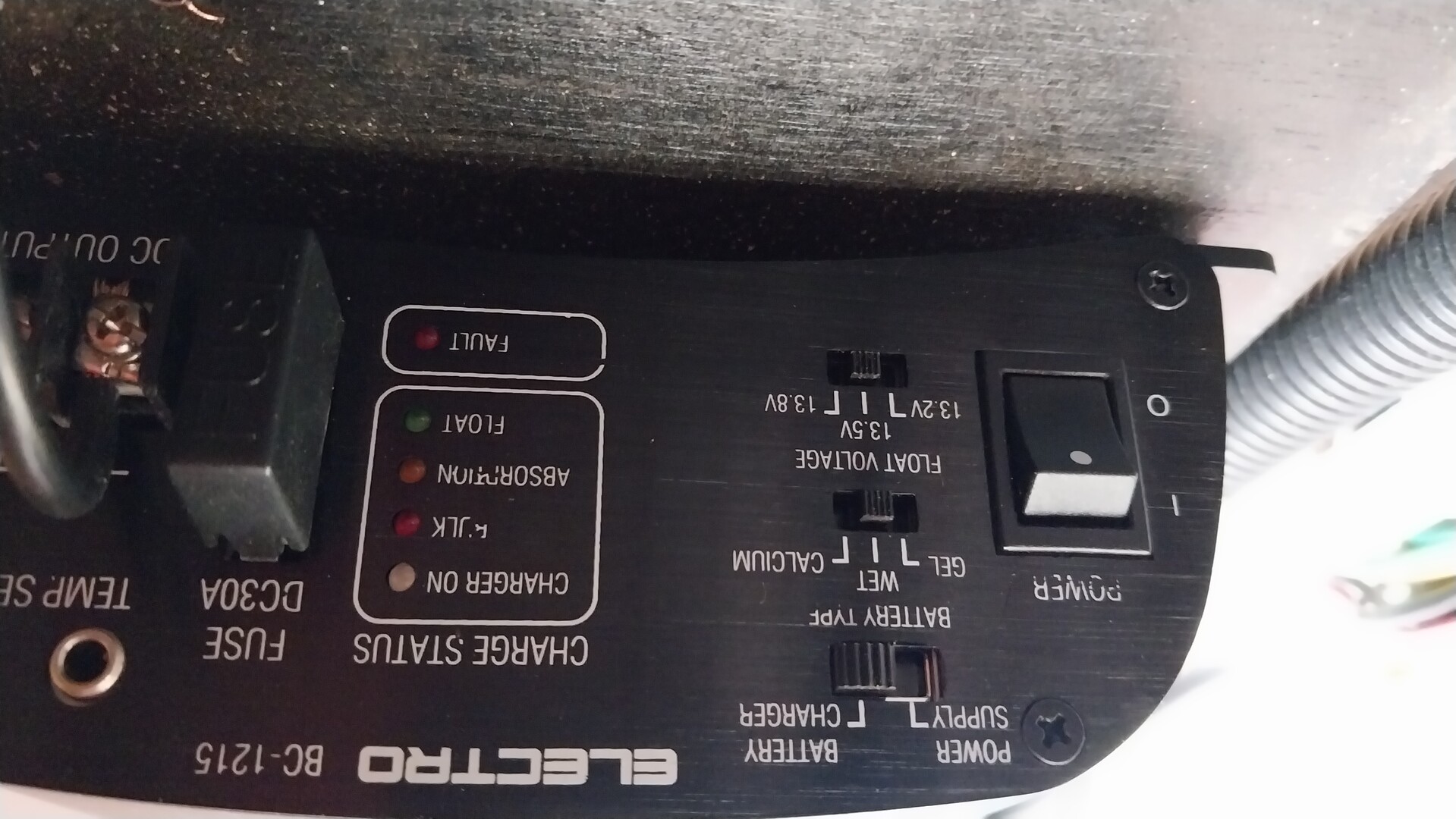

I have a 4ah cetex charger that I've used for the last 8 years to charge my wifes car, the AGM 680CC in my jeep and ride on batteries.
If I want to charge my new LiFePO4 12.8 v 100ah battery what battery select do I use.?
I also have an older Electro charger that I can select votages up to 13.8v
Just wondering what would be best to use as I obviously don't need to float the lithium battery.

I would set it on charger, Gel and Float at 13.5V. Do not use the Calcium setting under any circumstances.
With Gel setting it should take it up to about 14.2V so if you have a multimeter you can charge it up to see what voltage it reaches, disconnect and let it rest for a couple of hours and see if it settles at about 13.4V to 13.3V.

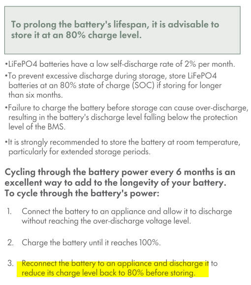

The VoltX manual says to discharge down to 80% state of charge for best longevity when storing. I imagine it would not make a lot of difference but they are the ones who should know.
But they never actually tell you WHY.

Advice on storing at 80% SOC is fairly common. Are you saying the manufacturers are wrong about their own products? Renogy goes into a bit more detail and proposes a lower storage value than VoltX.
Charge Level The state of charge is a often-overlooked yet critical factor in lithium battery storage, especially for long-term storage. Unlike some other battery types, lithium-ion batteries should neither be stored fully charged nor completely discharged. The ideal charge level for storing lithium batteries is around 40-50% of their capacity.
Storing a lithium-ion battery at full charge puts stress on its components, potentially leading to a faster loss of capacity over time. Conversely, allowing a battery to discharge completely before storage can cause irreversible damage. If you're planning long-term storage of lithium batteries, periodically check and adjust their charge levels to maintain this optimal range.
Just about any lithium product you buy now comes out of the factory only partly charged.
-- Edited by Are We Lost on Wednesday 18th of December 2024 06:42:30 PM

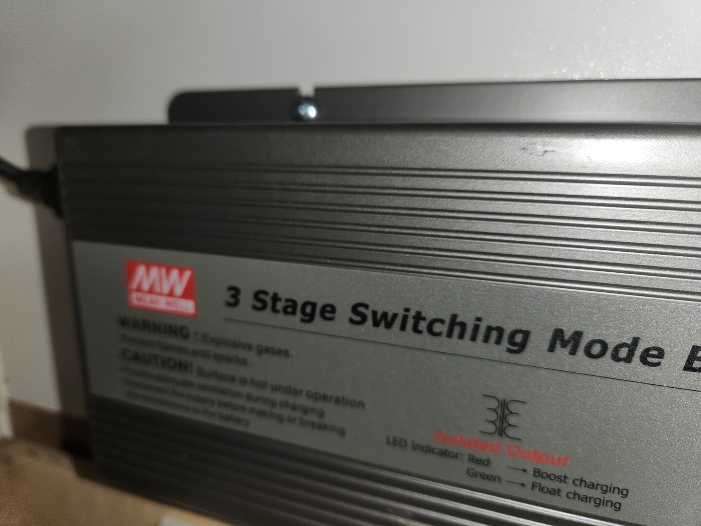

Hi all I realize this thread is a few months old now but I originally followed it with interest and I am hoping I can hope on the end of it and enlist your help. My set up at the moment is two 100 AH lead acid batteries in the Land Rover with the start Battery protected buy a relay and a second two 105 AH lead acid batteries in the caravan being charged by a combination of the cars alternator via an Anderson plug ( no DC-DC charger ) and two 150 watt solar panels, being that we prefer to free camp we hardly ever use the 240 volt charger which is a Mean Well PB 300 or 360 I cant read the model and it has been well hidden away in one of the lower cupboards. Also the solar charger has no name on it but is claimed to be 30 Amp. What I am thinking of doing is replacing the vans Batteries with either one or two lithium in the simplest way possible and the original thread has got me wondering if I can just swap them out with the lead acid. I cannot see any way of making adjustments on the 240 charger and would not have a clue of how to go about resetting the solar charging as no book came with the van see pics below any help would be much appreciated. Cheers Landy
-- Edited by landy on Friday 25th of April 2025 10:20:32 PM
You must be sure that there is no "equalising" charge sequence from any charger.
It would also be useful to know the bulk and float charge voltages and anything about the Li battery BMSs.

Your 240V charger is a 3 stage charger and is very capable of charging LiFePO4. Whilst LiFePO4 can be charged to 14.6 some battery manufacturers will set the BMS so they are charged slightly lower. Your charger can be set to 14.0V or 14.4V but there is very little power between 14.4 and 14.6V.
Your solar controller is in all probability a generic earlier model 3 stage PWM controller which although will charge LiFePO4 it will probably not be to 14.6V. I have attached a link to a similar model with the difference being the USB ports. There are later models out that claim to be MPPT controllers but they are fake.
Scrolling through the menu may show that it does not have a equalisation mode and in that case it will work for you but probably not fully charge your batteries. I would suggest though that as you are spending decent money on LiFePO4 you may want to invest in an MPPT controller. You will need to ensure that it is one with load terminals to minimise any alterations.
Unless you are planning on adding additional solar panels then a 20A controller would suffice. The Victron 20A Smart Solar comes with load terminals but the larger ones dont.
With the above controller you will just need to disconnect the six cables in the following order, being loads, solar then battery and connect back up, battery, solar then loads. Then just set your controller to the Lithium profile.

Query for Tim,
Cheers trev.

Here's a pic of the old electro unit.

Hi Trev,
No idea about your CteK unless you have a model number and many are multi stage chargers.
Your Electro is a 15A charger so it will charge much faster than your 4A Ctek. Here is the manual for it if you dont have one.
https://catalogue.electroparts.com.au/manuals/BC-1210%2C1215%2C1220.pdf?_ga=2.205896276.699246294.1734495891-1316888989.1734495891
Good luck
Tim
-- Edited by TimTim on Wednesday 18th of December 2024 04:11:45 PM
Renogy: How to store Lithium Batteries
Charge Level

Why then is the advice for Li different to that of any LA battery?
Cheers Landy
Here is your manual.
https://www.meanwell-web.com/content/files/pdfs/productPdfs/MW/PB-360P/PB-360-Manual-E.pdf
https://www.ebay.co.uk/itm/156334097353?
The Smart Solar has Bluetooth.
https://www.ebay.com.au/itm/127005829583?
Tim
-- Edited by TimTim on Saturday 26th of April 2025 05:48:20 AM
Tim Thank you for the links you found and supplied for me. I notice in the Mean Well manual that you kindly sent, The PB 300 recommended battery size is 60 to 100 AH and the PB 360 is 80 to 200. At the moment although I have jammed my phone shoulder depth into the bottom cupboard taking photos I have not managed to find the actual model, so does the fact that it is at present connected to 200 AH of lead acid suggest it is safe at this level or am I taking to much for granted. I will not be sure of what size Lithium to buy until I check some physical sizes to see what will fit into my battery boxes, but I am thinking 1 X 150 AH lithium should give me a lot more usable capacity than the two lead acids with a huge weight saving. possibly even a 200 AH lithium. Cheers again Dave
Hi Dave,
Dont be too concerned about the BMS and the charging voltage. Some will cut out at 14.6V and others lower but as I said earlier there is little difference in the available power. The reason why this is done is that the cells inside can become unbalanced as they approach being fully charged. Similarly, some manufacturers will set the BMS to cut out at 10.0V and others higher for the same reason when discharging.
If you look at the link for your charging manual that I posted it explains the three stages of charging. Again you have no need to be concerned as you 240V charger is very suitable. Page 2 shows the three stages and explains how the battery is charged, Bulk or Boost (Constant current), Absorption (Constant Voltage) and Float. LiFePO4 dont actually need to be floated but I wont do into that detail here.
Equalising is a process for flooded lead acid batteries where the charger actually overcharges the battery to remove sulphation off the plates. it is not needed for LiFePO4 batteries.
Yes, I saw the recommended model depending on the battery capacity but all that it means is that one model will take a little longer to charge your battery than the other. It actually states this.
I noted the manual I posted did not actually state the charging currents whereas this manual does. It is a little confusing though with the 300 model showing a maximum current and also a continuous current whhereas the 360 model only shows the maximum current. I would suggest that the 300 model charges at 12.5A and the 360 at 24.3A.
https://www.jameco.com/Jameco/Products/ProdDS/1952409Users%20Manual.pdf?
Seeing as you rarely use the charger, and most people dont with LiFePO4, even if it was the PB-300 model it will probably suffice and if not you could always swap it out later. Either model is safe.
