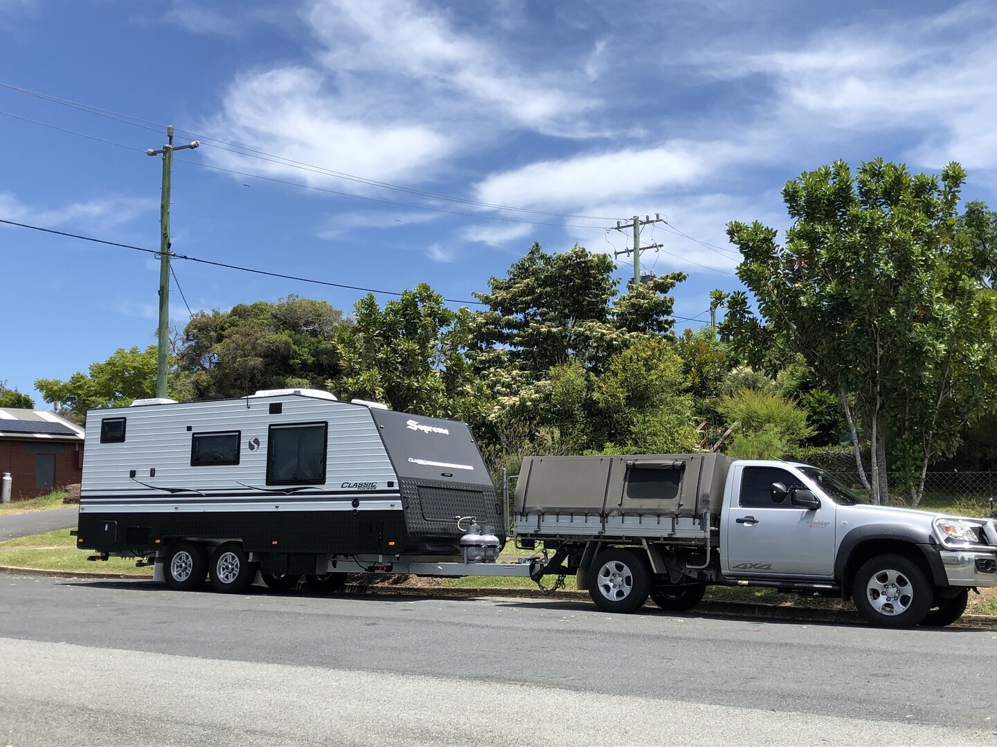

Hi, I have a 2011 Mazda BT 50 3.0L 4x4 for towing an 18.6 ft van (2650 Kg max). Looking at a clutch replacement and am seeking any advise from someone who has had it done with this model. Not sure whether to go on Dual or single mass. Thanks in anticipation of some feedback.
Dual mass flywheels are usually tuned to particular engines that need them to reduce harshness & vibrations, I would think putting one in a 2011 diesel would not be worth the extra cost, they also cannot be reconditioned because of their design, you would gain some more smoothness in the drive line but not much else,
JODA.
