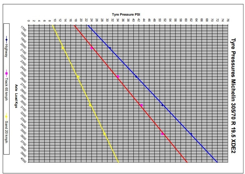

While on the subject, what is a safe pressure to reduce to when moving from the tar to corrugated dirt. In my case I have a single axle van with AGM of 2000 kg. On the tar I run mine at 64 psi, tyres are 116, rated max 80 psi. So what would be a safe minimum PSI I could reduce it to on the dirt ? Ian
Peter_n_Margaret said
07:41 PM Oct 24, 2024
Whatever pressure provides a reasonable ride Ian.
The important part of the decision is that the speed you drive at is closely related to the pressure and load on the tyres. Drive a little too fast for a bit too long and the tyres will overheat internally and will fail. This may not be apparent for days or months later when the damage causes the tyre to fail.
Low pressure and driving much slower will always give the best result.

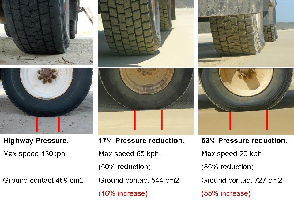

I prepared this chart for our use for this very question. It was derived directly from Michelin published data for the specific tyre we use, but generally this type of info is unfortunately difficult to find from a credible source.
Sorry it is on its side.
This is what the tyres look like.
We recently drove the southern half of the Canning Stock Route. We typically drove the 1050km at between 20 and a maximum of 30kmph, just above the yellow line. We were with friends who had exactly the same tyres but were lighter than us. Neither of us had any tyre problems.
I saved a couple of 1 minute video clips from the dash cam to demonstrate speed differences over corrugations.
Thanks Peter, so you are dropping approx 10 psi, in my case that would be around 50 psi which is higher than most drive on the tar.

No. My pressures on the highway are around 45/65psi and for the Canning we were around 20/30psi, so less than half of normal pressures. We weigh around 6.5T.
What pressure you choose is dependent on the speed you are prepared to drive at and the load carried.
I trust and use the Michelin data implicitly and have done so for 20 years. I do not trust any other source, despite every 4WDer or truckie having a better idea.
https://youtu.be/m7ud9EdMh20
https://youtu.be/jgmRkbM4BJ4
