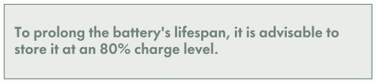

Its always interesting to note what the manuals state and what actually happens in the real world .......................... Charging by solar I have always thought is best as its charged up during the day and rested of a night, be the battery Lithium or not it matters not really, since I have lithium letting them sit for a month or so between trips I thought isn't an issue and if I forget not a worry, I set my solar reg settings to sort of match up with the batteries BMS settings and it seems to work well, with my old GEL's they just stayed on charge everyday for about 7 years, saved like 50kgs when I went lithium ..............

Back to RV batteries, my Voltx says to store at 80%.
They also suggest if stored for a long time to cycle the battery every 6 months.
I checked the Renogy advice for their batteries.
Based on the multitude of suggestions not to keep lithiums on charge, and the specific advice from battery manufacturers, I will only keep mine fully charged when planned for actual use.
