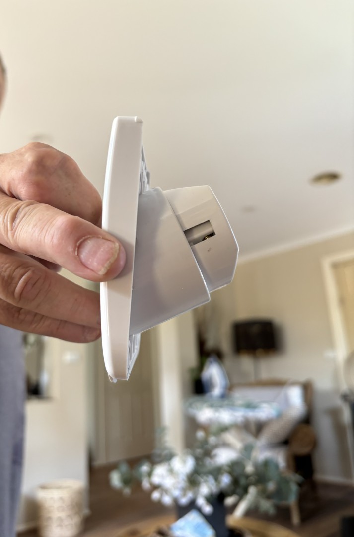

there is a thread on this however it was last used in 2009. I thought I would start a new one. Am having some real problems replacing old 10 and 15 amp with new ones. The new ones dont fit between the out and inner wall. I have bought the largest spacers (20 mm) and they still dont make the outlets fit. The outlets that I bought said they replace the old version but they dont. This is really giving me the shiites, can anyone please point me in the right direction. thx
Or you can see a different type of in the attached photos.

I have these spacers or flanges as they are also called. My outlets old sit flush inside the wall cavity and has room for the wiring to be connected.

Still not enough room even with the extra backing plate, just how wide is the wall cavity ???? I have removed mine for a refit once and it was a tight fit even for the old style socket and looking at the new version I think I would have dramas as well getting room to fit ........................ Might explain lower placement on outer wall on new vans with a boxed in section inside ..............
Try 2x backing plates or cut out one from HDPE Board, the stuff poly cutting boards are made from, does a great job and is electrical/heat/water insulated and I have used it for a number of things on van especially as backing plate for electrical panel and other panel jobs.... Can get thick cutting boards of the stuff at Bunnings and laminate to get the thickness needed.
The other way would be to cut right thru the inner wall, and cover with a junction box which is what they are for ... a junction box is the stronger of the type..
