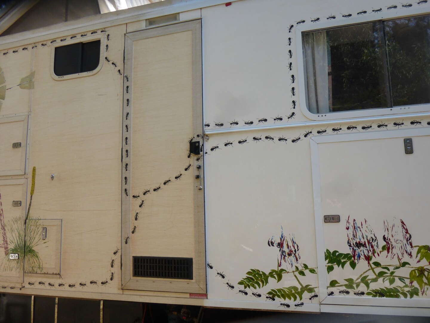

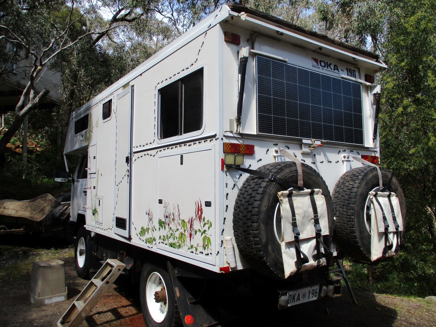

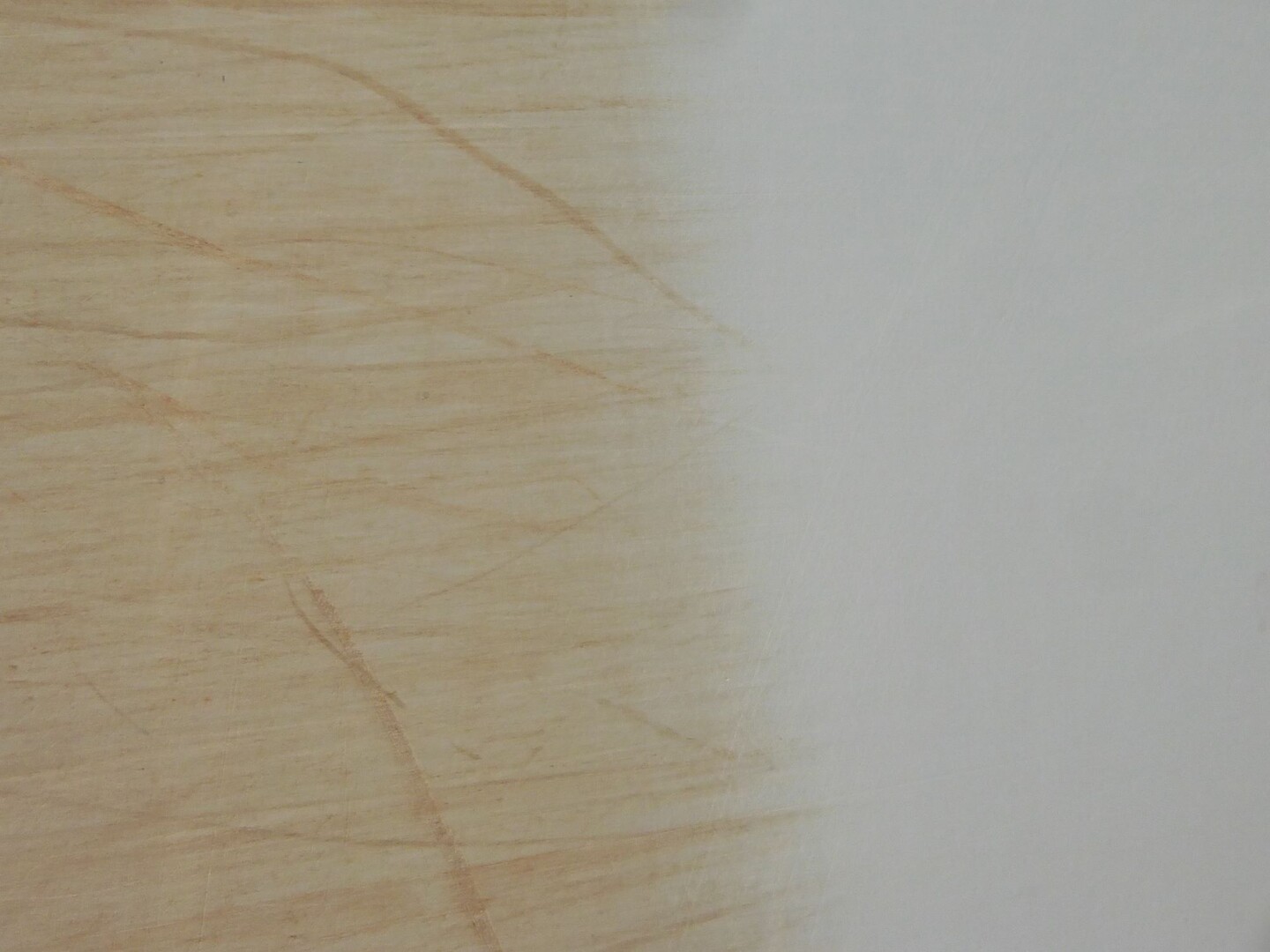

If fibreglass gel coat yellows, that is a sure sign of poor quality from new. Our OKA is now 20 years old and I have just finished cutting it back for the third time in those 20 years. The last time was 2018. It suffers from some pretty severe treatment in the bush and we don't get "precious" about it but after some severe scrub and the Canning Stock Route this year, it really did need some TLC.
I rubbed it back with blue Scotch Brite and cream Jiff with a multi tool and then gave it a quick coat of cheap polish from Bunnings.
That will be "it" for a few more years.
-- Edited by Peter_n_Margaret on Friday 11th of October 2024 09:51:01 AM
