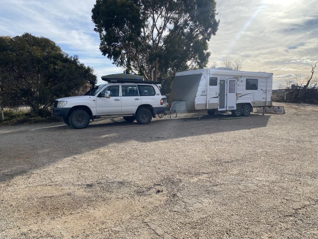

I acknowledge that most if not all people advise to use 4th gear for towing, but I go against that advice. I tow in 5th all the time, using the gearbox as and when needed to stop the engine lugging when under stress. In 5th, and between 90 to 100 on the GPS (about 2-3 kms below Speedo) I am at between 2300 - 2600 rpm.
I have had no issues, touch wood, with the motor or gearbox in about 85000 kms of towing the van, and 170000kms owning the vehicle. I am not recommending that practice, but am simply advising what MY experience has been.
Hope that helps.
