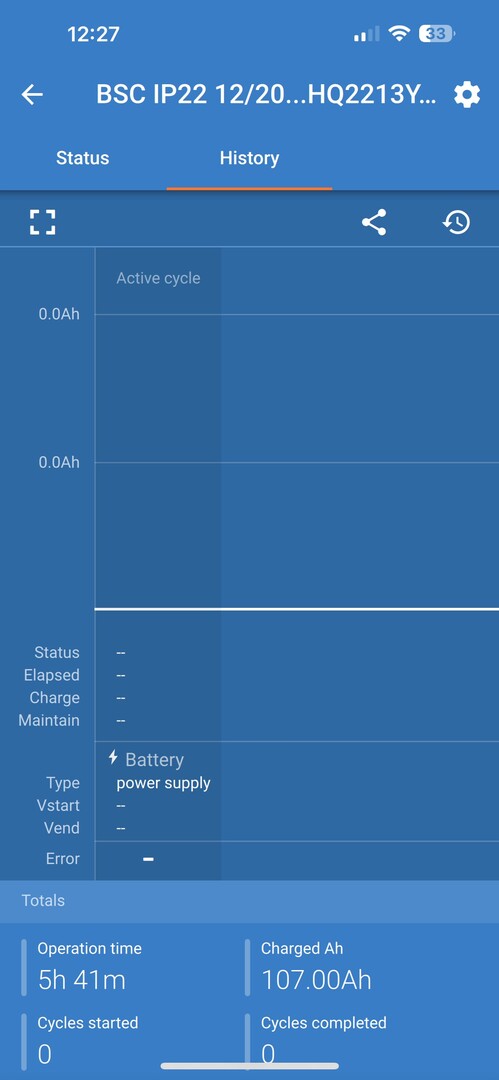

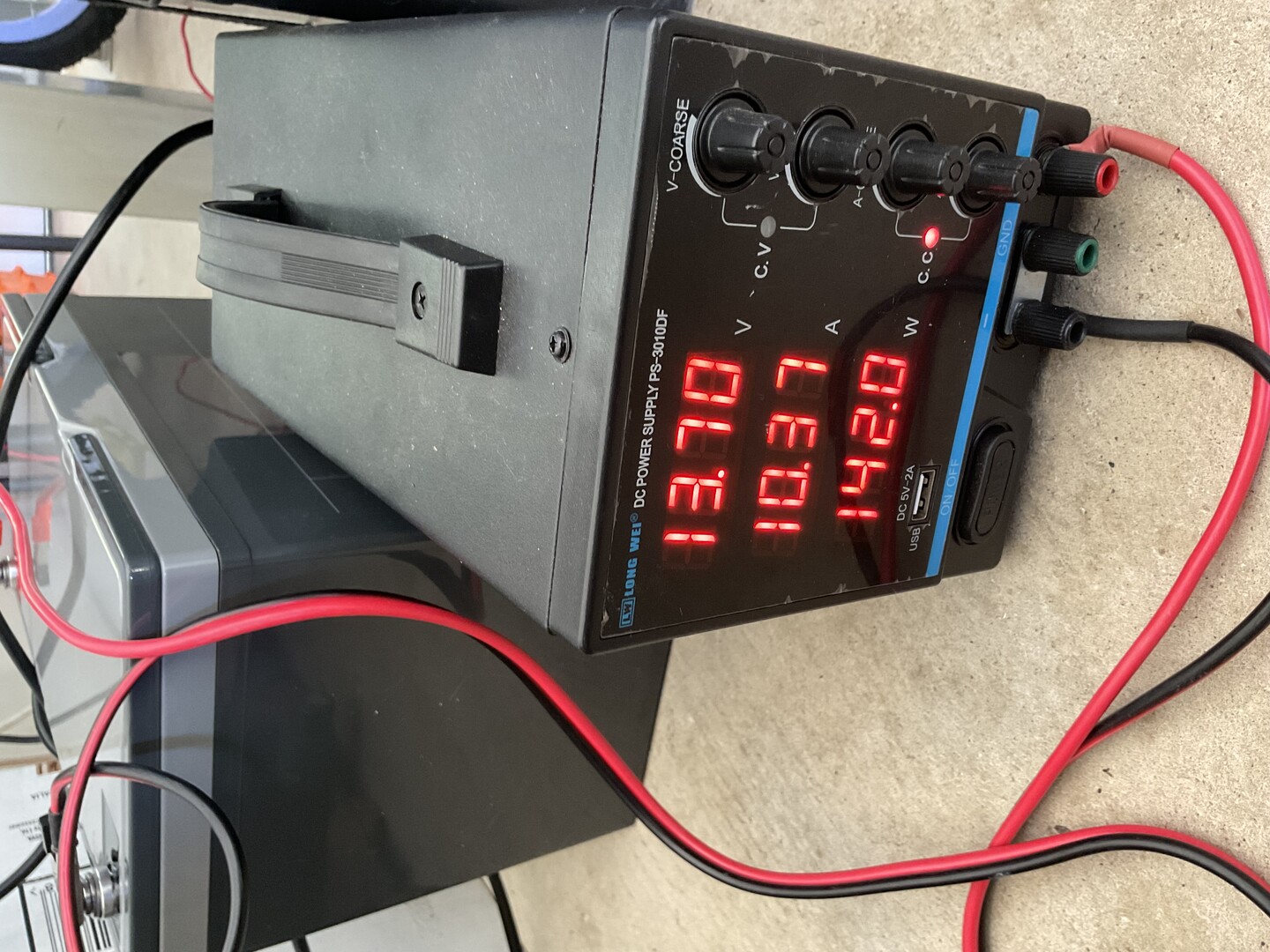

TimTim said
12:31 AM Sep 13, 2024
Are We Lost wrote:
There is a coupon code to bring it down to $449.
That was correct and I saw it too but has rapidly been changed.
I forgot that my Victron 240V charger could be set as a power supply so I set that up to charge my Voltx up to 14.6V.
I put the capacity tester on the battery and set it up to draw 20A only to find that I blew my tester up after I had drawn 85Ah from the battery. You know what those Chinese instructions are like and hidden away was a note that the power should be less than 150W . Anyway, a new one on order along with a Victron 300A shunt that was on sale reduced to $79.65 with coupon.
I continued discharging the battery with some LED light down to 10.6V and with the time it took and having considered the battery voltage and amps being drawn I was almost certain i have drawn over 100Ah from it. When my new capacity tester arrives I will test it again.
In the mean time I charged it up from 10.6V to 14.6V and my Victron charger indicates that that the capacity is 107AH.
Tim

TimTim said
11:00 AM Sep 13, 2024
My pleasure .
Arrived in two days with a Victron catalogue and a Victron pen. Not that I need anymore pens lol.
Excellent service from the seller.

I have just completed two full discharge and charge tests between 10.6V and 14.6V and they all confirmed that the battery has 107Ah capacity. Will do a test next week taking it up to 13.65V, the same as the Setec and see how many Ahs I can get out of it taking it down to 10.6V.
