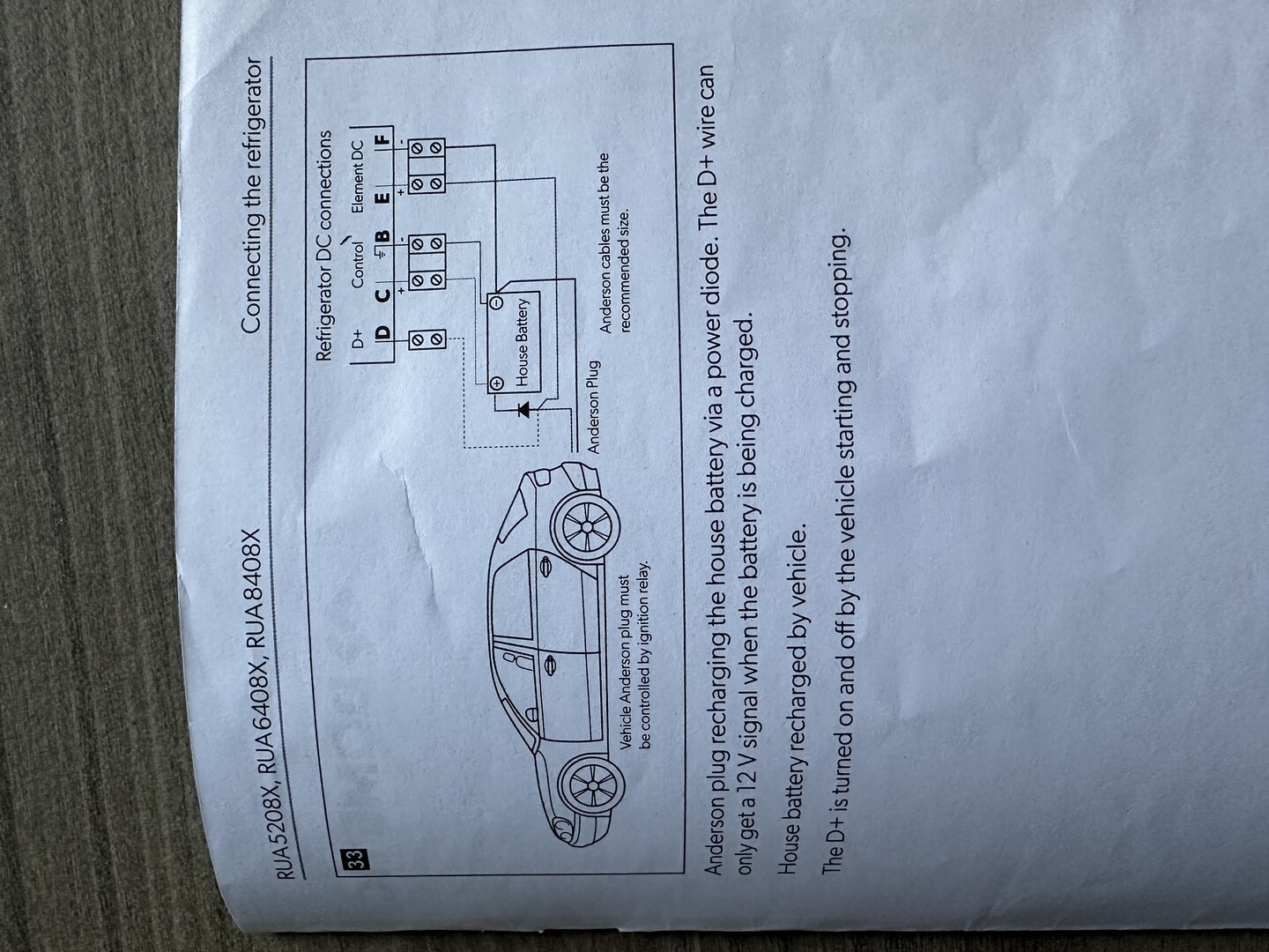

Fridge is connected to house batteries as per the diagram below but it needs 12V charging from the tug to operate.
Ask for the make and model of the fridge and look online for the installation manual.

Our fridge is same as yours, so apart from perhaps some inefficiencies I can see no reason why you could not run Manually on a 1000 watt 240 v inverter. If the house battery can cope and is being charged from the car.
I am starting to think the AES system is not the big deal I first thought. Looks to me like you have to intervene at every stage anyway, turning gas on / off. Pluging in mains, removing mains and then for peace of mind checking that the bloody thing is working when you rely on 12v.

Some places just make it complicated and expensive .................. I run a 7 pin which is just for the van lighting brakes/clearance etc the fridge has its own decent bit of wiring, an 8 B&S cable from tug battery pick up to van fridge, anderson junction on draw bar and I fitted an anderson at the fridge end as it makes a very good step down from the 8 B&S size to the fridge cabling, the D+ wire, which shows the fridge that its hooked up to 12v is just tapped into the fridge anderson, on the fridge wiring side is added a Fridge Switch which shuts off the 12v when stationery so cranking battery isn't deaded.... i don't run any charging system from tug to van as my solar does the job, i look at things being if you need to charge while driving down the road how will it managed parked beside a creek for a few weeks................
Old 3 way was just 12 when it needed to be replaced last year, I went for another 3 way as a compressor job meant i would have to add some more storage to cover it and the fridge was costing enough as it was, not a great variation in cost between the 2 but extra battery bumped it up lot ............. I have found the biggest problem with 3 ways is very poor installation, brand means nothing they all seem to just chuck them in a hole with little care so long as it works ...
Gonefishing1955 said
03:22 PM Sep 12, 2024
Thanks Mal, will probably do the same with my D+ wire, add a switch like you.

A 100A ignition relay together with a fuse relay is the surest to disconnect from Tug cranking battery. That should have been fitted in the first instance. Seems like DIY wiring was done. The relays can still be fitted in engine bay for peace of mind. Adding a VSR is even better as it will ensure the Tug cranking battery is charged before powering the Den.
