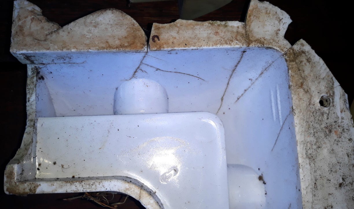

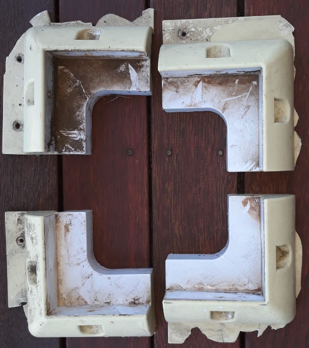

Are We Lost said
10:35 AM Sep 7, 2024
Here is what my brackets looked like after two and a half years of UV degradation. Glued and screwed.
Apart from the cracking, the surface area for adhesion is quite small. The removal process did break off more of the flanges, but they were clearly cracked and broken which is why I replaced them (with metal brackets). They were very fragile.
The adhesive stuck to the roof fairly well but was easy to separate from the brackets. I don't recollect what it was but I used Sika 11FC for the replacements (metal brackets) and it still looks perfect 3 years later.
