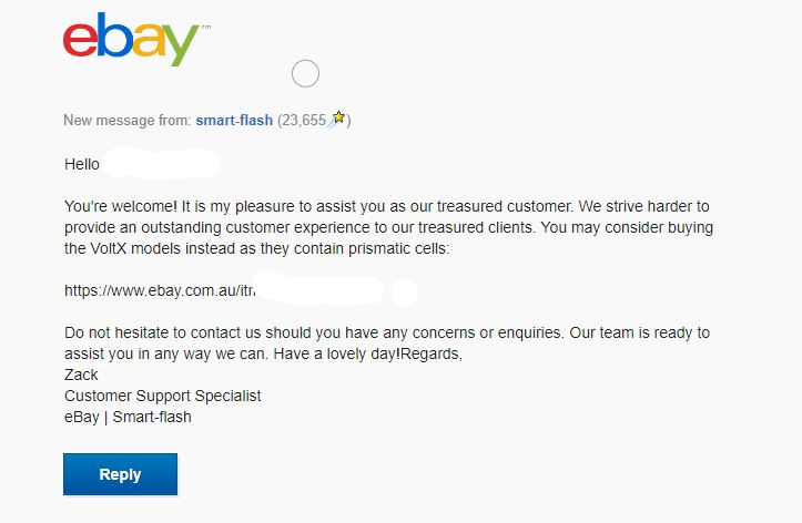

It was interesting to note that when I replied to the seller saying I wouldn't purchase due to the battery having pouch cells they suggested the voltx brand that has prismatic cells.
I may look at building a battery myself down the track and used EVE cells and a Daly BMS. As this guy has https://www.youtube.com/watch?v=4z8mwkLX1dc&t=6s
At this stage I may look at the voltex from The Green shed as I was unaware they sold them (as a buy in).
Here's the advice from the ebay seller. Who I was impressed with their speed of reply and help.
