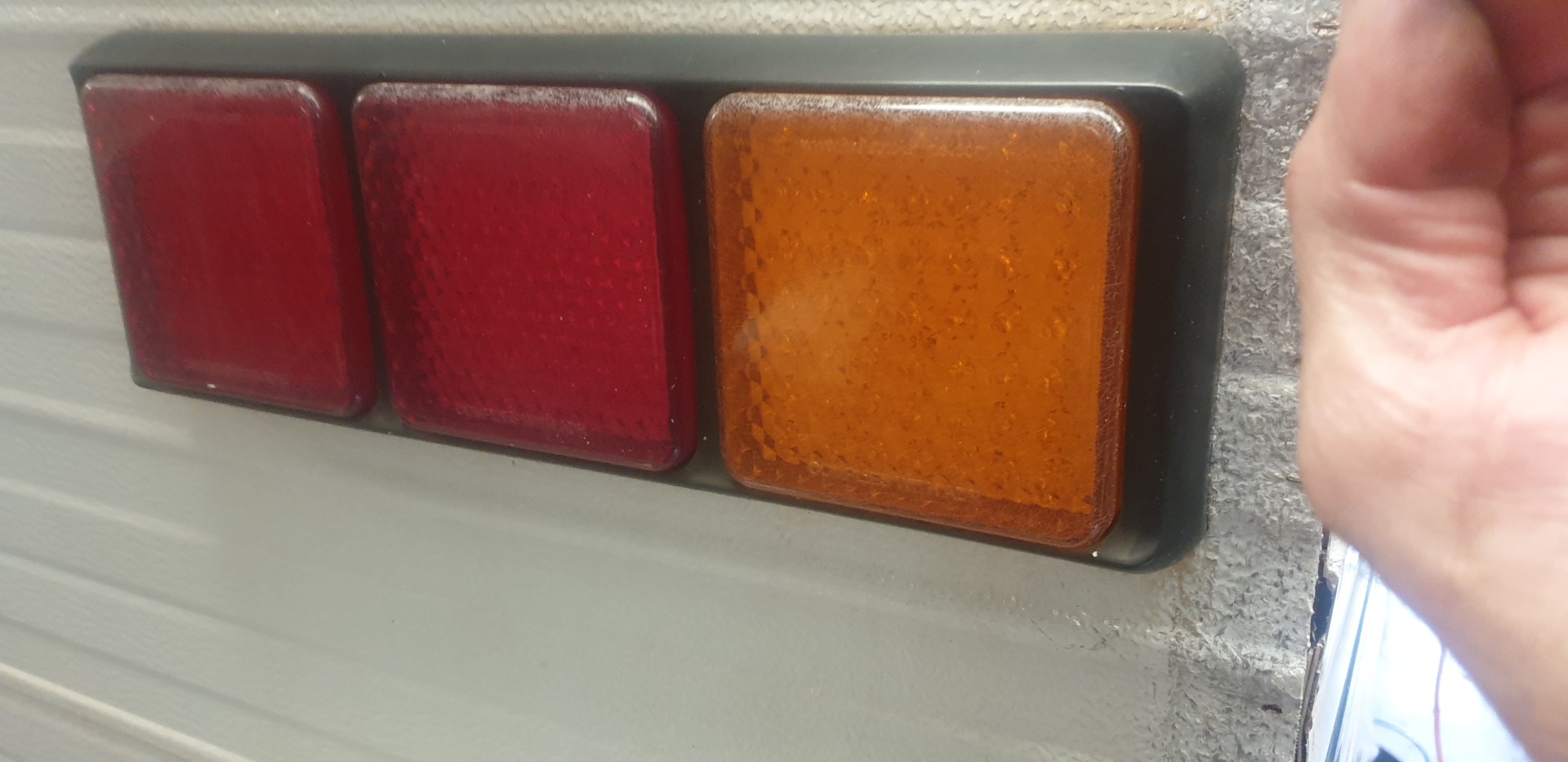

Hello everybody I actually can't believe I'm asking how to remove the black bezel around the tail light. For the life of me I have tried everything without smashing it off with a hammer to get it off can anyone shed some light on this please.
-- Edited by Dtassie on Thursday 15th of August 2024 03:35:13 PM
I called a mate and he said the black bezel stays and the 3 lights come out. You need to wedge a blade into the middle of the light and then use a thin flat screw driver to dis lodge the light outward.

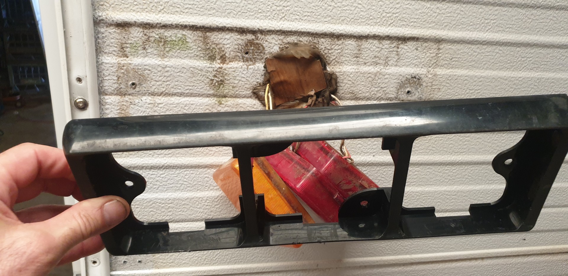

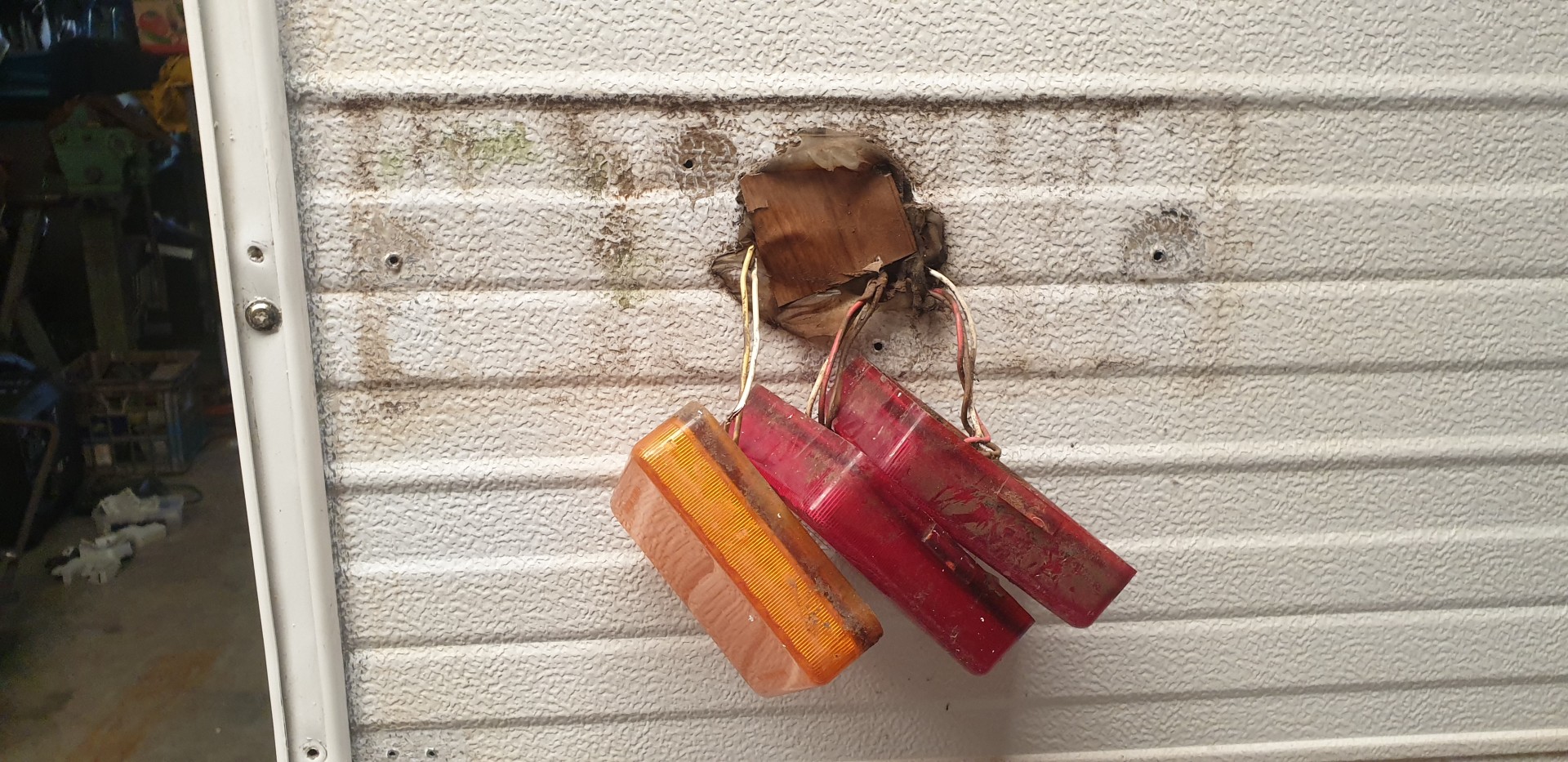

I updated my original post (1st one) with the answer to removing but here it is in case you missed it..
"You need to wedge a blade into the middle of the light at the top and then at the same time use a thin flat screwdriver to dis lodge the light outward at the top."
The black bezel or the actual mounting housing for the LED lights stays in place with 6 screws. The interesting thing is that this black housing is the same if you flip it 180 thus exposing a sun free no UV damaged surface.
So I had a win in the end. However the lead up was a little different though. "frustration turning into desperation then almost caravan violence" (laughing)
