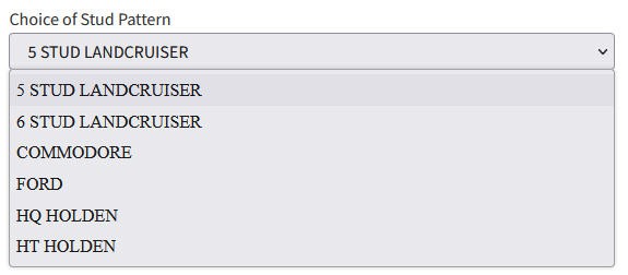

My van came with Huntsman suspension, ordered by the original owner. He ordered hubs to suit his tow vehicle. Just looking now on the site I can see there 6 options for stud patterns.
Which was ordered for your van? The fact that you are asking for 15 inch wheels when their records show it was delivered with 14 inch make this far from clear. I suppose you know the plate specifies the wheel size that should be on the van.
