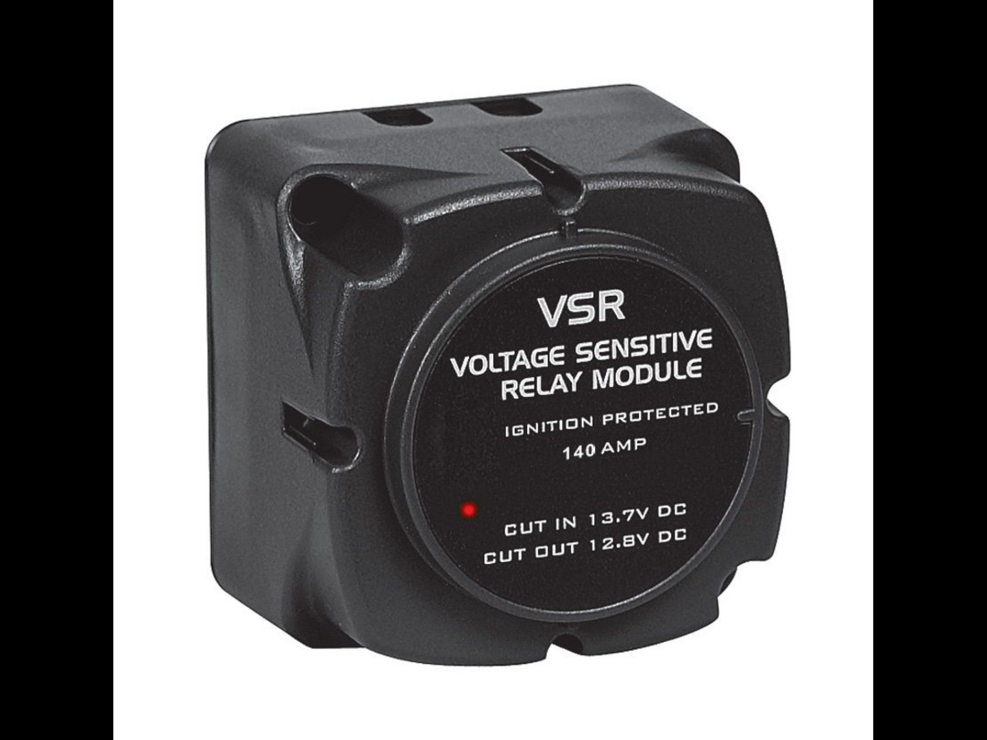

I can't see why one (or get someone else) can't get a gas fridge running off 12v for short periods, at least off an auxiliary battery.
The correct size wiring & a DC-DC converter next to the fridge, wound up to say 14 or 15 volts.
Otherwise the voltage at the fridge is probably down to 11 volts or worse with the undersized cable at >40°C due to resistance.
Yes it would be easy to do that but I am guessing the motorhome has protection to avoid the battery being drawn down when not driving. Good design suggests it should have that feature. Perhaps a device like this:
Fridge auto cut off

I struggled with the efficiency of my 3 way for years & did all the usual mods like internal & external fans along with ignition controlled 12 v supply via larger cables direct to the fridge via Andersen plugs, insulation and air flow baffles etc.
(In my old GQ Patrol, I use a relay that operates off the ignition switch accessory position to connect 12 towards the van via an Andersen plug using large cables ALL the way. Inside the van I have the option of connecting that feed direct to the fridge .. via more Anderson plugs & large cabling .., or to charge the van battery if I choose that option. Usually I just charge the van battery when traveling from the solar panel.)
