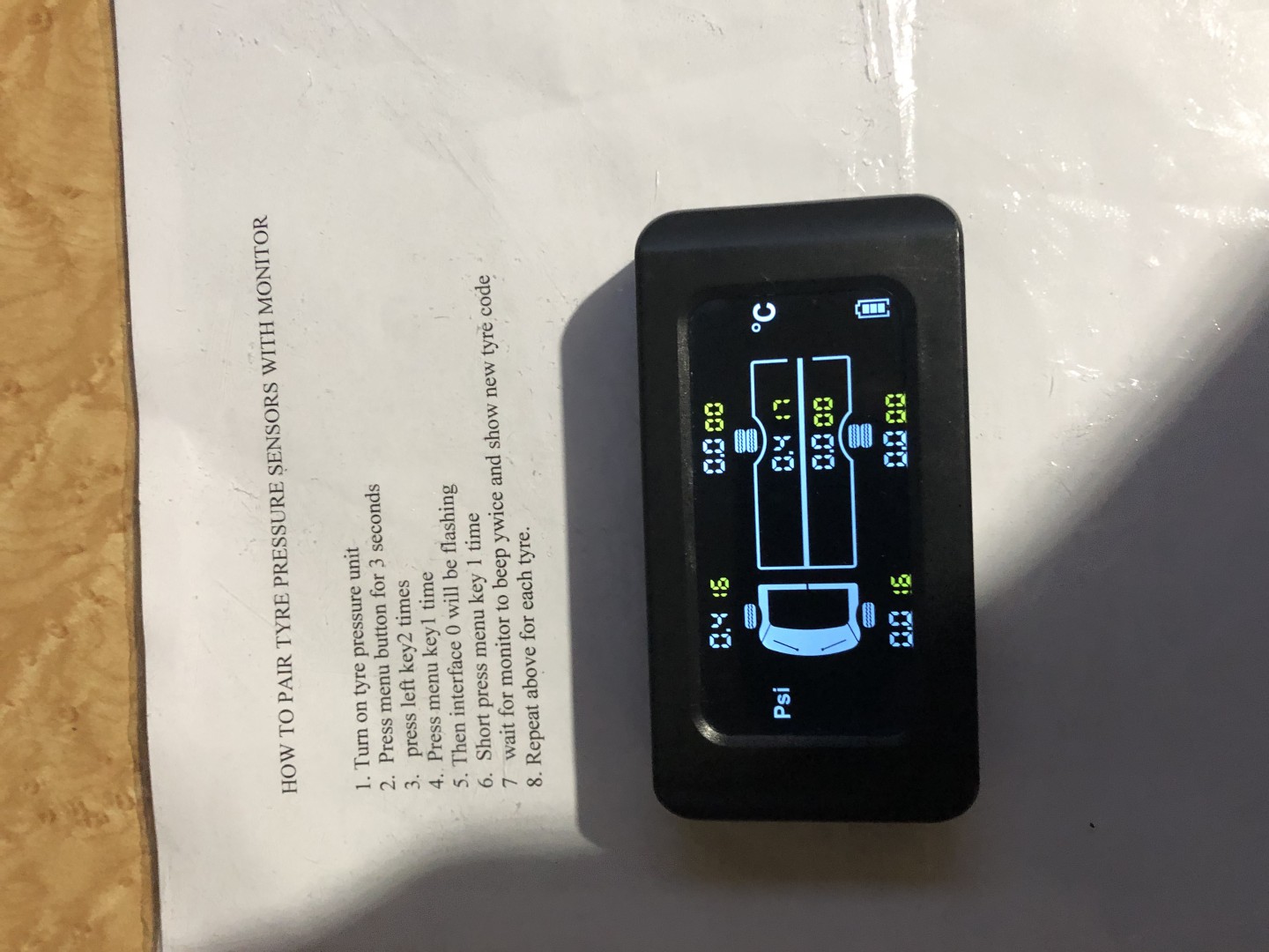

Hi. I have a TPMS which originally worked ok. However, the sensors will no longer pair with the receiver. The battery in the monitor and those in the sensors are ok and well within the voltage range. I have tried removing the sensors and then repairing them but it just doesnt work. The monitor gets to the stage where the 0 interface is blinking but will not go past this point. Any assistance would be greatly appreciated. Thanks

dennis78 said
04:45 PM May 21, 2024
Hi bristle. Here is a photo of my tyre pressure monitor
Hi bristte. Sorry about your forum name. Damn iPhone changed spelling
Hi bristle. attached is the picture I meant to send.
