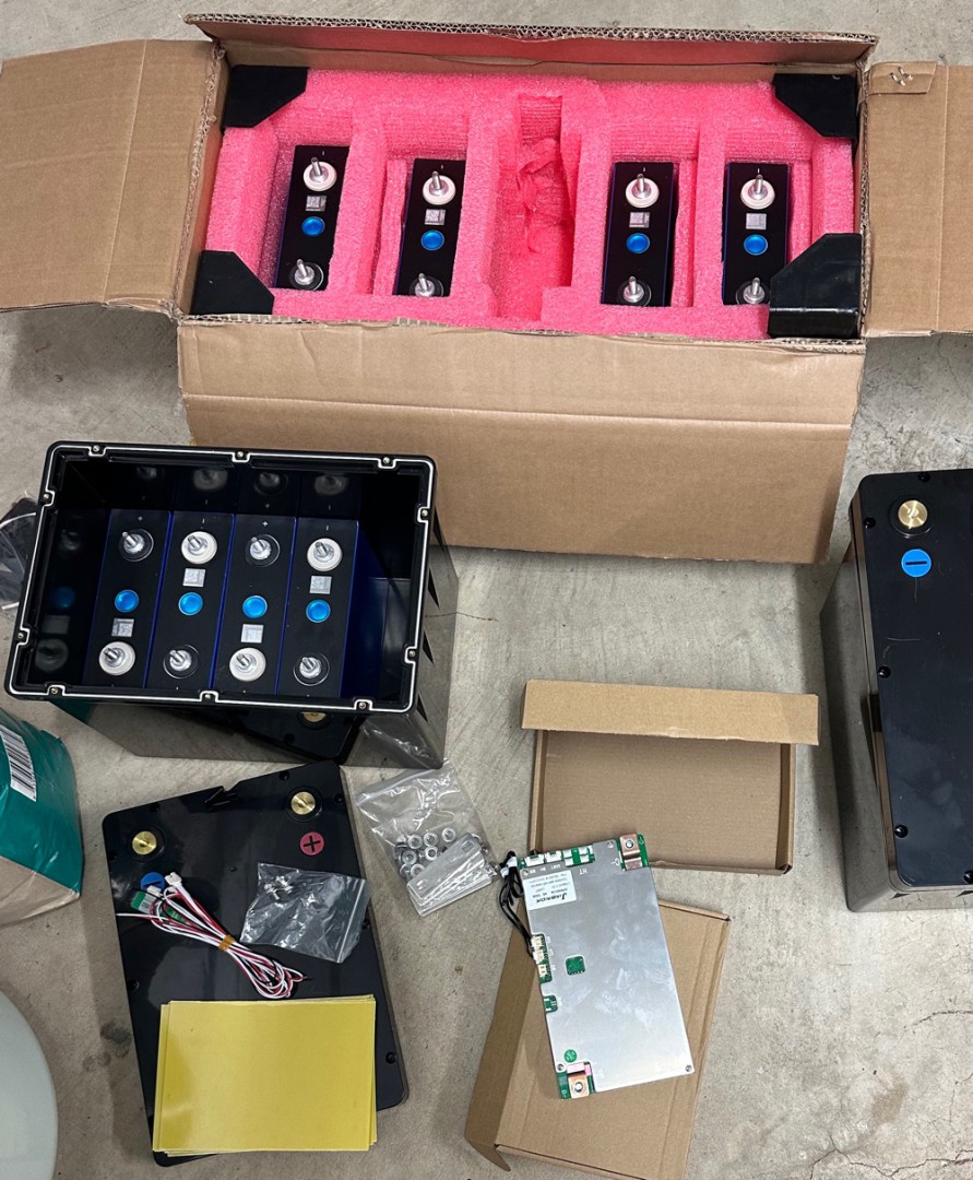

Many of us buy nominal 3.2V prismatic cells and a BMS from China we then assemble them into a battery. Obviously if you already have a few electrical tools then the cost is cheaper but if you have buy things like a power supply, crimpers then the cost does not work out cheaper but you get a quality batter plus tools.
You can buy a reasonable quality battery from say Aussie Batteries or you can also pat 3 to 4 times the price for a battery with the same quality cells inside.

Great to see they have put the jumpstart instructions on your battery. The BMS cutout is at 9.2A which is probably way below what your 12V appliances will run at So you arent going to reach that level. Probably the only way you are going to reach such a low voltage is if you drew your batteries right down and then left them for a couple of months without recharging.
Any decent BMS circuitry should isolate the internal cells well before they reach any critical discharge/voltage point. Automatic reconnection or not is an inbuilt BMS parameter.
Our 10 year old 300Ah LiFePO4 has no such BMS inbuilt to current limit battery output.
It has also started our 3.9l turbo diesel engine for those 10 years of fulltime travel often multiple times a day.
20%? Our battery has never been below c34% SOC in normal use. Hopefully an alarm will scream at 20% and cut off will occur at 10%. Still enough to start the truck engine with ease. Tested on day one of installation.
