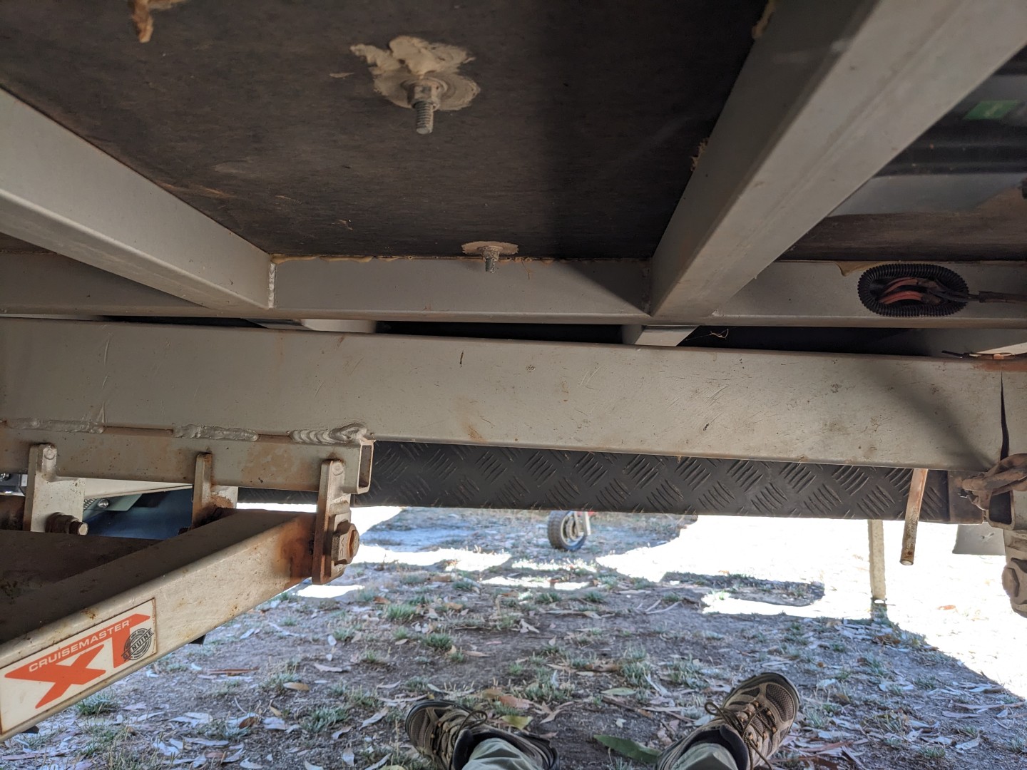

We recently were heading from home in Melbourne to Adelaide and discovered part-way there at the Grampians that there was a serious crack in the part of the chassis supporting the undercarriage. Not wishing to tow any further for safety reasons we stopped in a nearby caravan park. The insurance company has rejected our claim (wear and tear - structural damage) so we need to transport the caravan back to home or to a repairer. Do you have any recent recommendations for caravan transporters and/or vehicle engineers in Melbourne who can help us to retrieve the caravan and get certified repairs done to guarantee trouble free travelling in the future?

Surely a caravan dealership in Horsham could direct you to an engineering workshop, who could carry out the necessary repairs without the added expense of transporting it to your home base.
Either Horsham or Stawell would have a welder who could do the job, depending on the location of the size of the crack, you may be able to tow it to the nearest facility, get some advice if it is safe to do so.

To speculate, the crack may have been initiated by hitting a bad pot-hole or through severe corrugated roads. Either way it should not have happened if the design and construction was adequate. The van has never been overloaded because I have weighed it on many trips and kept a rough tally of contents each trip to ensure that it is legal and reasonably balanced. With a maximum permissible payload of 489kg and a typical payload of 350-450kg, it is not overloaded. The crack has started from a weld and progressed up both sides of a box beam. The fact that the crack was hidden by electrical cables prevented early detection during servicing. So I have no way of knowing how long the initial crack existed. It only became obvious when we stopped to re-fuel and friends travelling behind our van said that the off-side wheel was on a funny angle.

That crack has been caused by the poor weld if the other side of the suspension is anything to go by.
It has propergated from the end of the weld in the heat zone.
To repair that it will require a properly designed gusset plate welded over the chassis tube once it has been straightened. The gussets should not have square ends but rather arrow shaped to spread the loads correctly along the rail. An engineer can advise.
Unfortunately chassis manufacturers often employ semi skilled welders to do structural work. A properly trained coded welder would have done a proper job of it instead of the handyman effort on that chassis.
The stresses on independent suspension arms and pickup points can be very high on a heavy van and I often wonder how much engineering is done by a suitably qualified engineer in the design and construction of some of these.

The manufacturer of the caravan have agreed to repair the failure and RACV have agreed to transport the van to the repairer. I will report back after the various tasks are done. A special Thank You to all posters above. You have given me good advice and information and certainly eased some of the pain. This is the value that the Grey Nomads Forum delivers. Thank you all.

I now have my van back and JB Caravans have done an excellent job of completely replacing the cracked beam and putting everything back together. There was no charge to me for RACV Roadside Assist to cart the van from Gariwerd to Campbellfield and no charge from JB for the chassis repairs. Overall, it has all been an interesting (albeit worrying at first) operation and many thanks go to JB for doing the right thing in repairing their product without hesitation.
