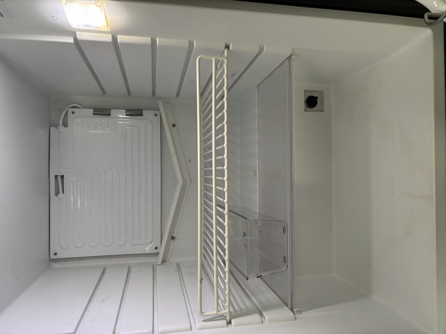

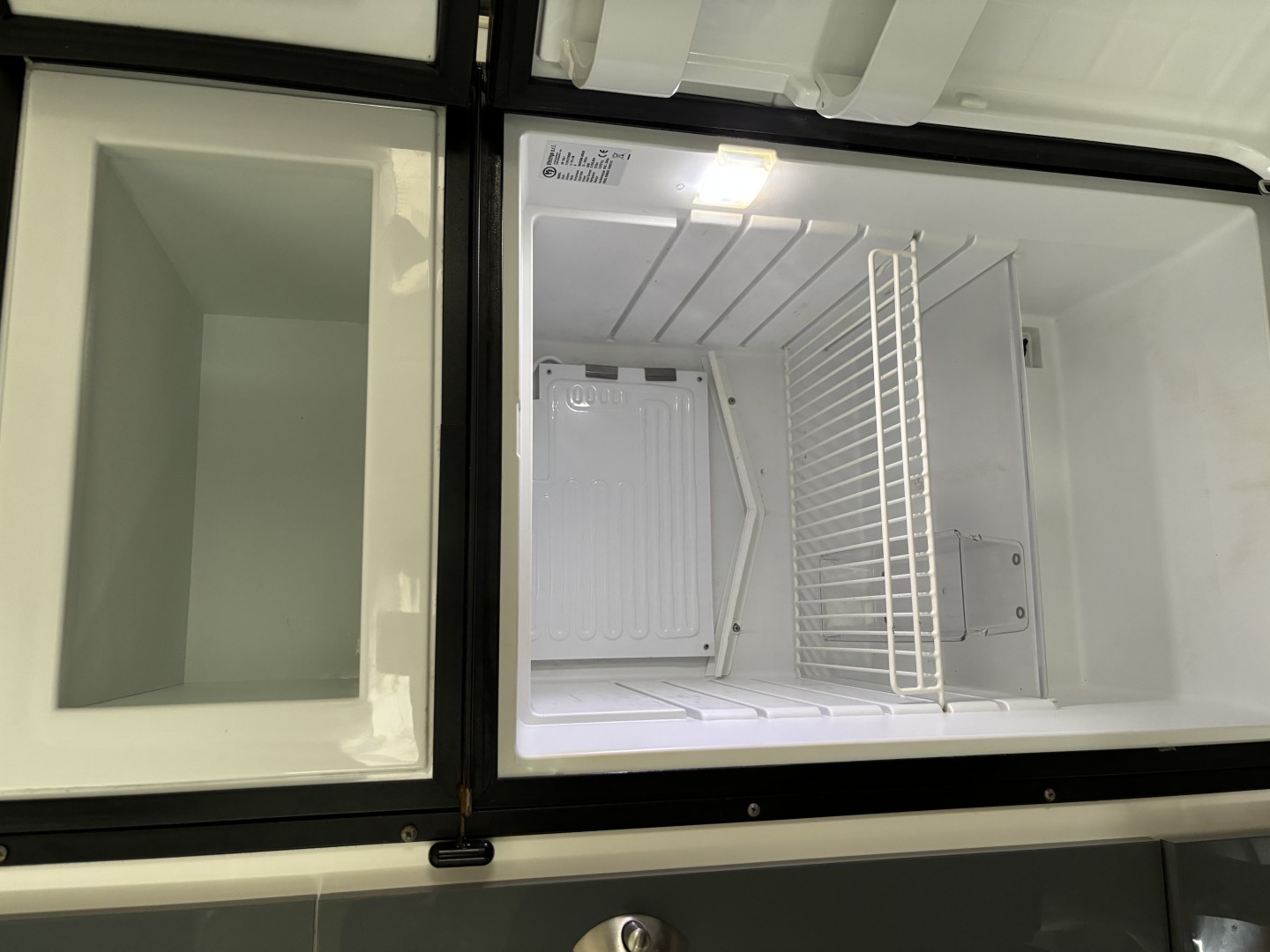

Thanks for the suggestion. Turned off for a day. Turned on overnight, same issue. The fridge section has its own evaporator plate, so maybe its the thermostat that controls that ???? See attached pics - again freezer section icy cold. Think Ill leave it to a tech..sometime

On that type of fridge the refrigerant runs through the freezer first, then through the fridge evaporator. I would bet on theres a small refrigerant leak some where. This will starve the fridge evap, you will find the compressor will run continously & not cool the fridge.
