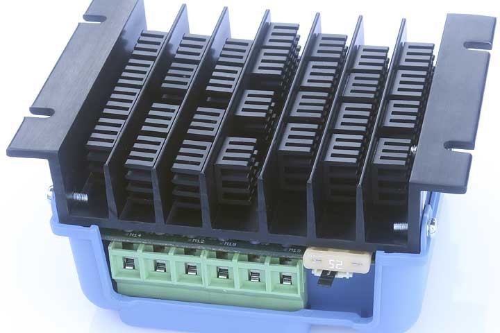

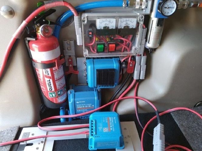

Controllers will increasing derate themselves as they reach maximum designed operating temperature (unless they are some Chinese third rate cheap stuff that will fail when you are in the Pilbara).
It's why I got a large than needed controller & additionally added extra heatsinks front & back.
Controller with more heatsinks on other side to remove heat where possible on extreme ambient heat days.
(Second controller in foreground for a dual controller test)
